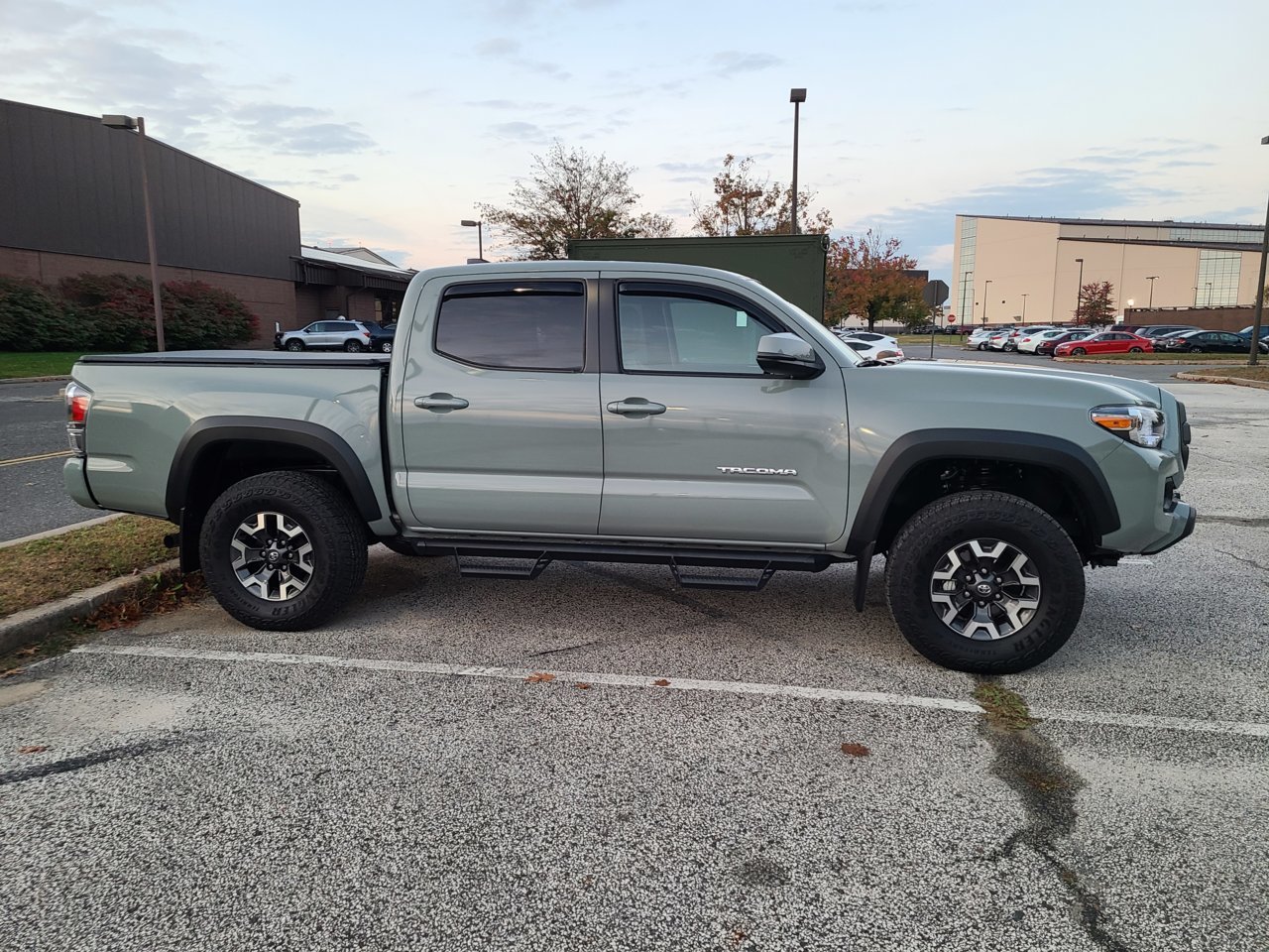

    I just had 5100's installed today. I had them set on the 3rd circlip setting. Unfortunately I can't get an accurate picture for you. I got back late and now it's dark. I will get you one from work tomorrow. My driveway is sloped so it's hard to get an accurate measurement until I can get on flat ground. I did not do anything to the rear. I did the same thing to my Tundra years ago and was very happy with just leveling it out.

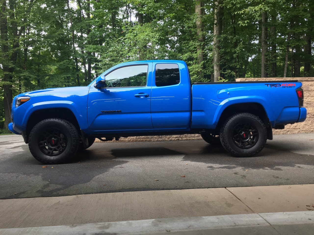

  4. Oct 17, 2022 at 6:36 PM
    Kruuuzn
    Kruuuzn Well-Known Member
    Jan 6, 2020
    #315283
    683
    Randy
    Traverse City, Michigan
    Here ya go.
    JagoTaco, CT-Tacoma, Burns and 3 others like this.
  5. Oct 17, 2022 at 6:59 PM
    monoman
    monoman Time to get dirty!
    Aug 18, 2008
    #8607
    1,527
    Dave
    Exotic, San Jose, Cal.
    2018 Silver Sky Tacoma SR Access Cab 4X4
    SnugTop SuperSport shell CaliRaisedLED light bar BFG K0 AT’s Bilstein 5100's up front, (#2) & 4600 in rear N-2 Designs remote start/keyless entry Anytime 12v outlets... one by shifter & one in bed Daily driver....
    Just had these installed recently. I have them on the 2nd circlip, no lift in rear…
    Burns and Discokiller[OP] like this.

  7. Oct 18, 2022 at 4:18 AM
    Lunartic
    Lunartic Well-Known Member
    Feb 14, 2022
    #390155
    96
    New Jersey
    Taken this morning. Bilstein's were put on yesterday. Front is 1/4" lower than the rear. I'm happy with it. Setting was 3rd notch.
    arbezee, Burns and Discokiller[OP] like this.
