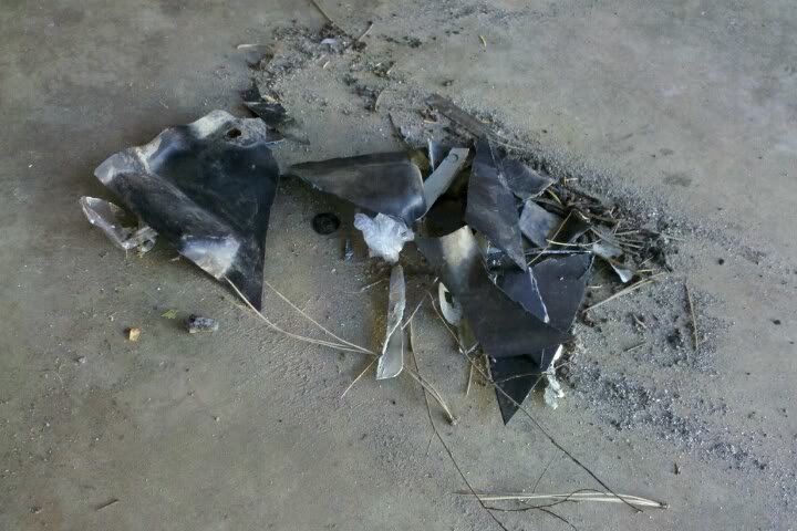

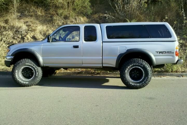

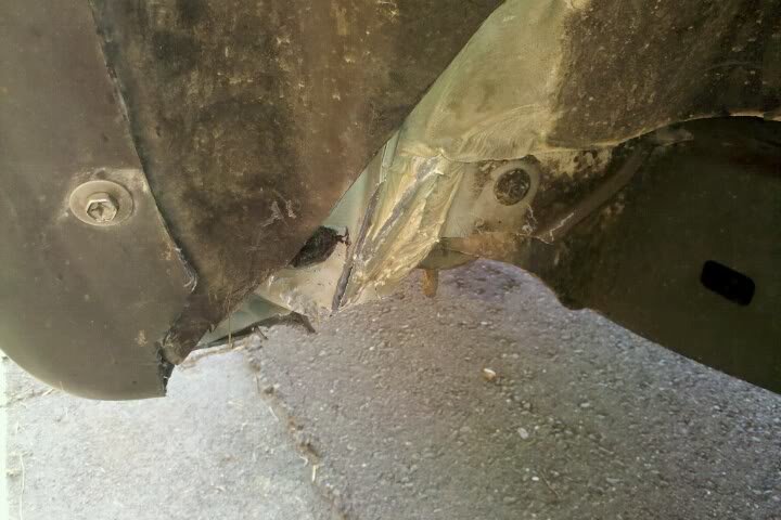

    Yeah you will have to trim. I have 33x12.5's and I had to trim the pinch weld.
    This is all the shit I had to cut off most of it is plastic.

    you have a 2nd gen. op has 1st gen, we don't have cab mount rubbing issues.
    but grind down the pinch weld an d paint it,(because hammering it flat creates room for rust) and cut off SOME of the plastic and you'll be fine op!

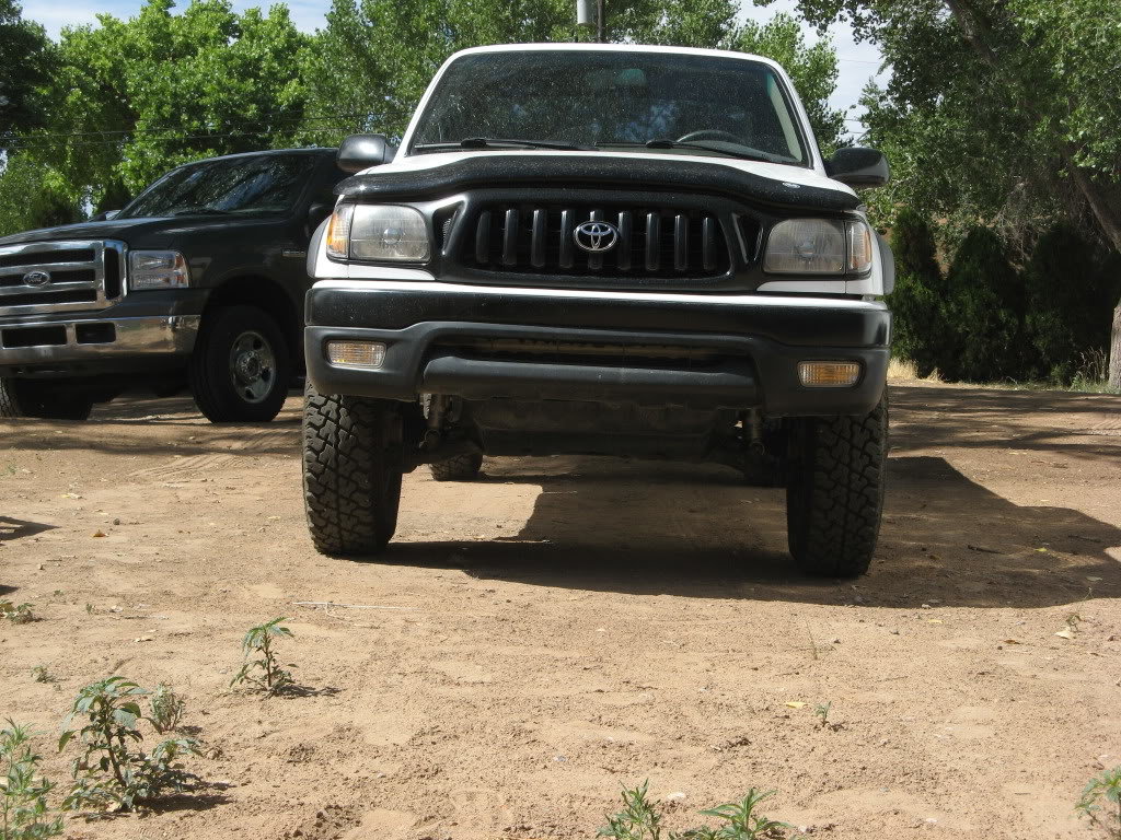

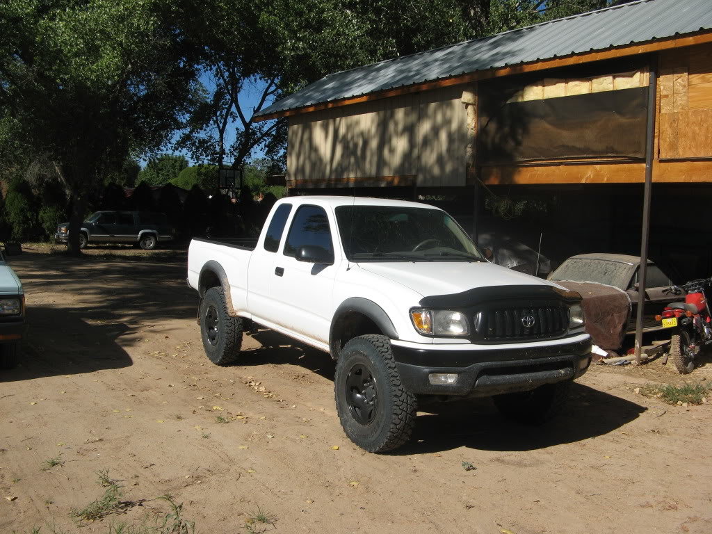

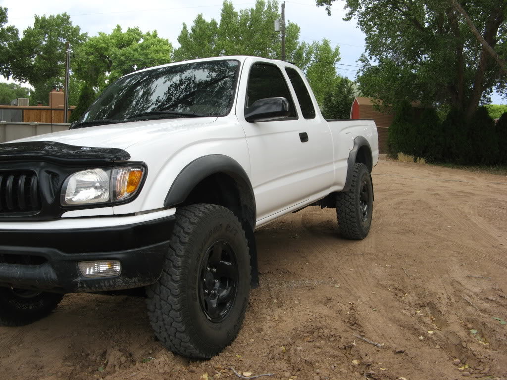

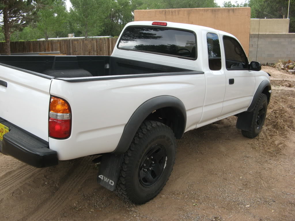

    285/75/16 on mine with ~2.75" lift no rubbing except on frame at full lock stock wheels 03 Tacoma

    X2 that's what I did. I cut away more after I took the picture just so I can stuff the tire a little more at full lock.
    I'll take a shot tomorrow it show you how it looks all cut away and shot with an undercoating.

    you dont rub on the UCA? what tires?
  14. Nov 6, 2010 at 2:57 PM
    Matic
    Matic Locked and Lifted "02" DC TRD.
    Sep 8, 2009
    #22436
    17,831
    Rich
    Greenville,sc
    1 owner 2002 TRD, SR5, DC, 2.7. Full OME suspension, STT pro's.
    OME 881 coils with OME nitrochargers shocks up front. TC UCA's OME Dakars with extra leaf in the rear. Warn 8000 winch with 80ft custom braided synth line. Custom 60ft synth extension. All pro tube bumper, Hi-lift jack, Safari Snorkel, Wilco tiregate.
    Is your rub full left forward and full left reverse?
    And does the fender hit full left going into driveways? (curb)

    is the 33x9.50 tires in your second pic

    dang you do have to cut alot i wonder if it would be tha bad with 10.50

    :laugh: I just went off road near the RR Tracks today and I need to cut a lot more.
    Also I'm sure you will be fine My rims are 15x10" with a -44mm offset that's why I'm rubbing a lot off road.
