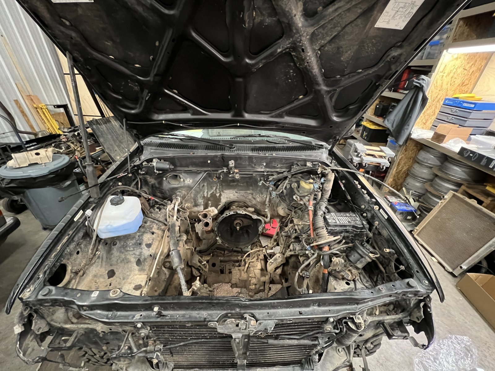

    I started by pulling the 2.7 3RZ out of the engine bay to see what I’m working with.
    A very dirty engine bay. I don’t have water in my workshop, so I bought one of the portable battery pressure washers that use the same battery as my lawn tools. I would say it’s very convenient, but if you’re hoping for high performance look elsewhere. For what I need, it’s perfect. I can put in a little extra elbow grease and scrubbing if it means I can clean parts up at my shop.
