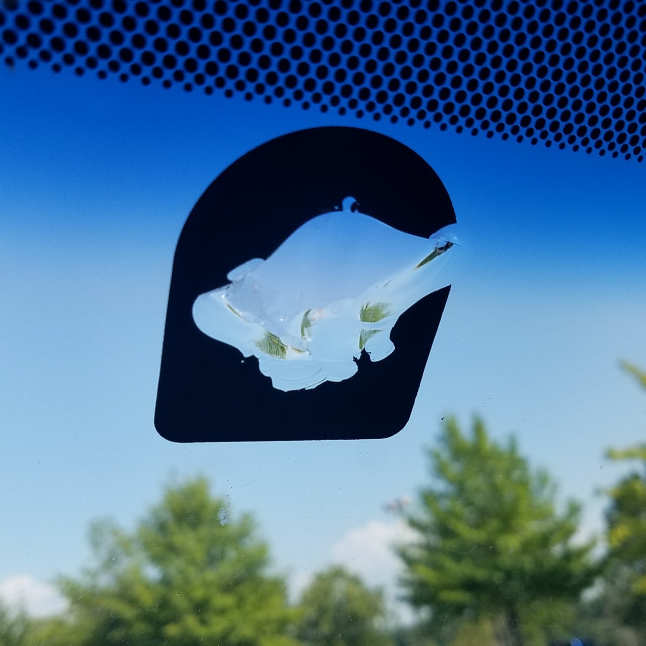

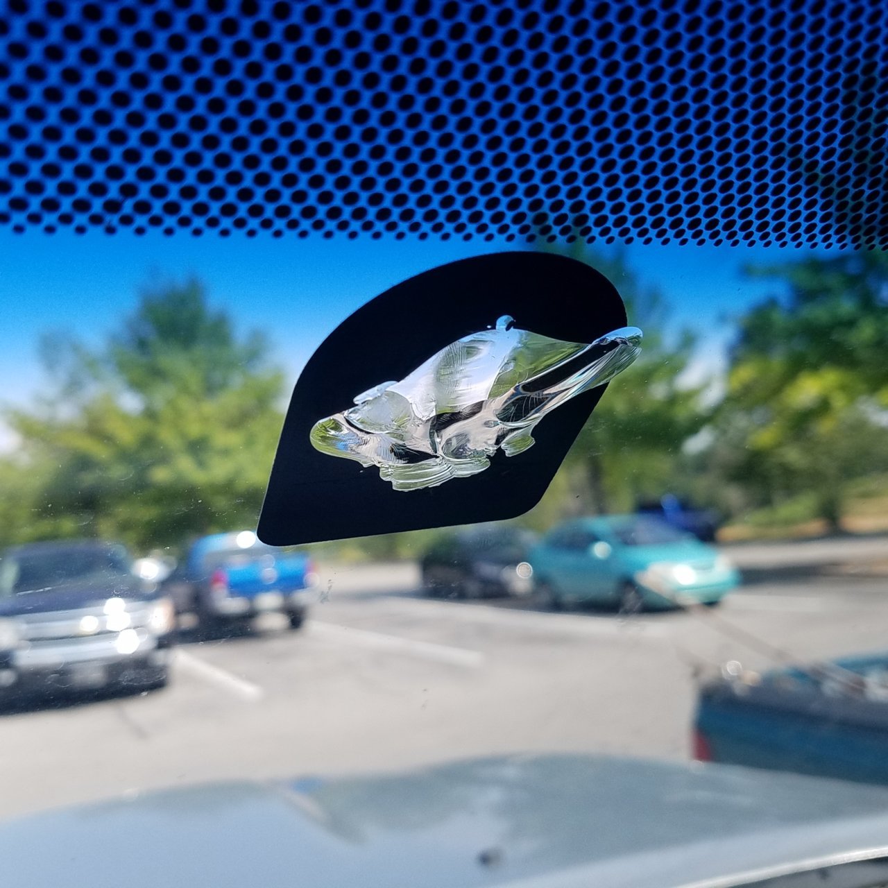

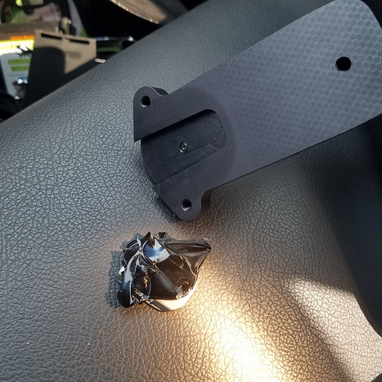

    At this point there would be no way in hell I'd use it now. I'll just glue another foot in place. Eventually I'll replace the windshield.

    The riser causes stress on the mounting point in the glass because of the extra length ,that has happened too more than a few guys,glad I kept mine factory.

    Yerp, precisely why I'm putting a "foot" in place to remove that lever action.

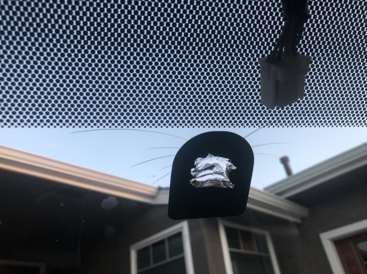

    In the same boat as others. Anyone know a good windshield replacement place in San Diego? Gotta wait til next paycheck :/

    The good news is that the epoxy used to hold on the mount is wayyyy stronger than everything else around it.
