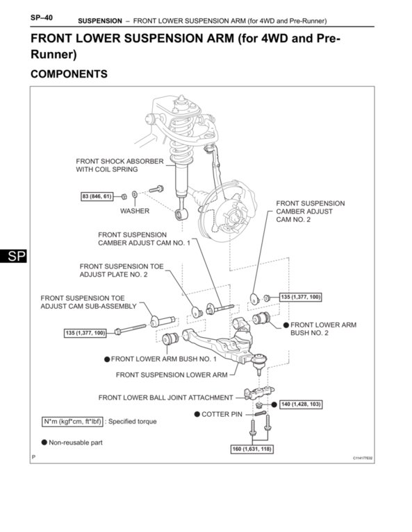

    Just about done torquing everything down, installed the cams with new LCAs. Torque spec guide says 100 ft lbs for cams. Is that right? I recall someone saying 150 front, 120 rear, and that’s seems like a bunch.

    130ft#'s all around will keep everything tight.

    Nice, thanks. Gonna go through and retorgue everything this weekend.
