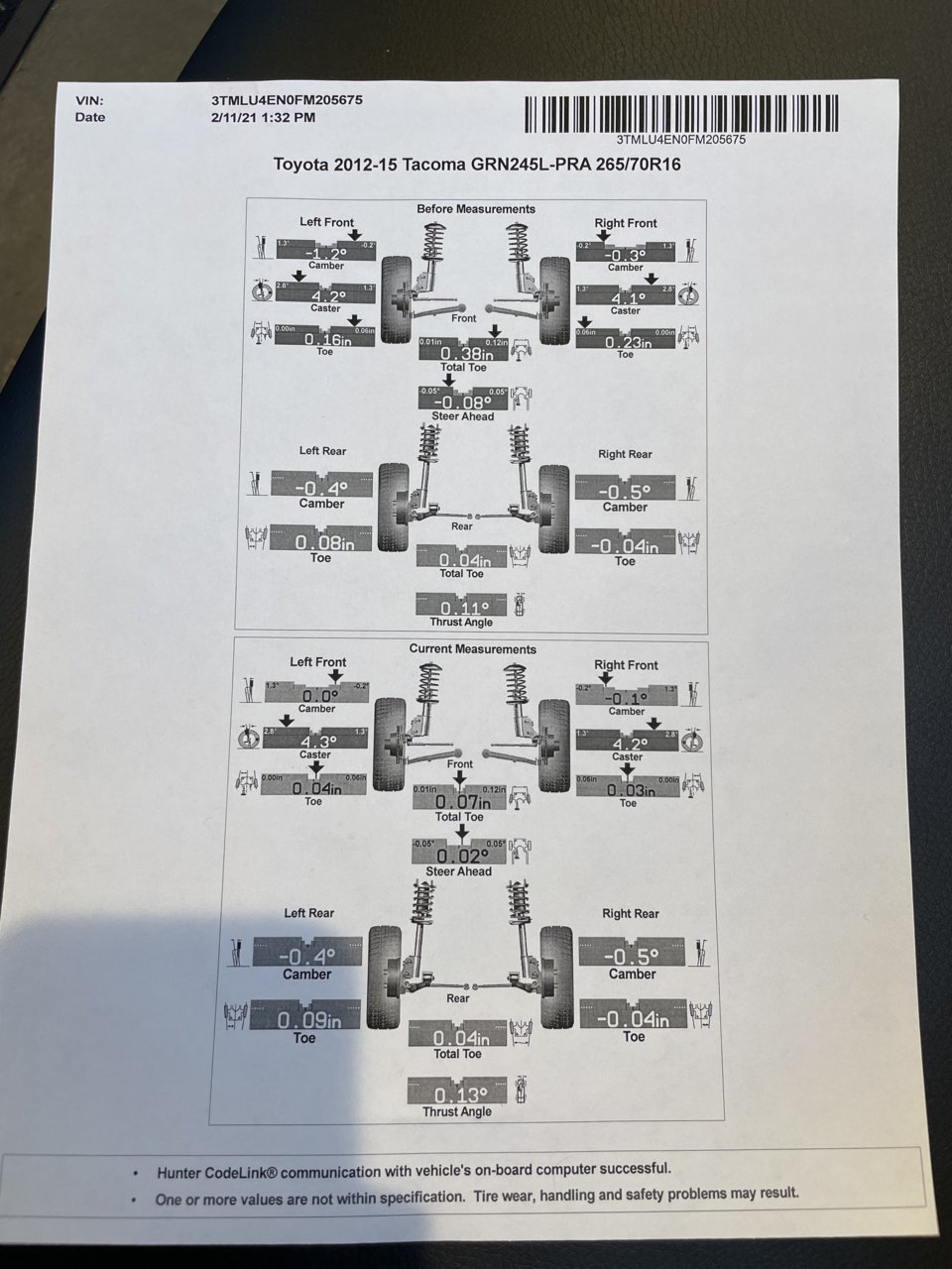

    I did full outboard for rear (caster) and full in for front (camber). Then had the tech align using my uca’s for camber, and then adjust toe. These were my before/after 5C283648-9975-4C54-81D5-91E52D1DBAE9.jpg

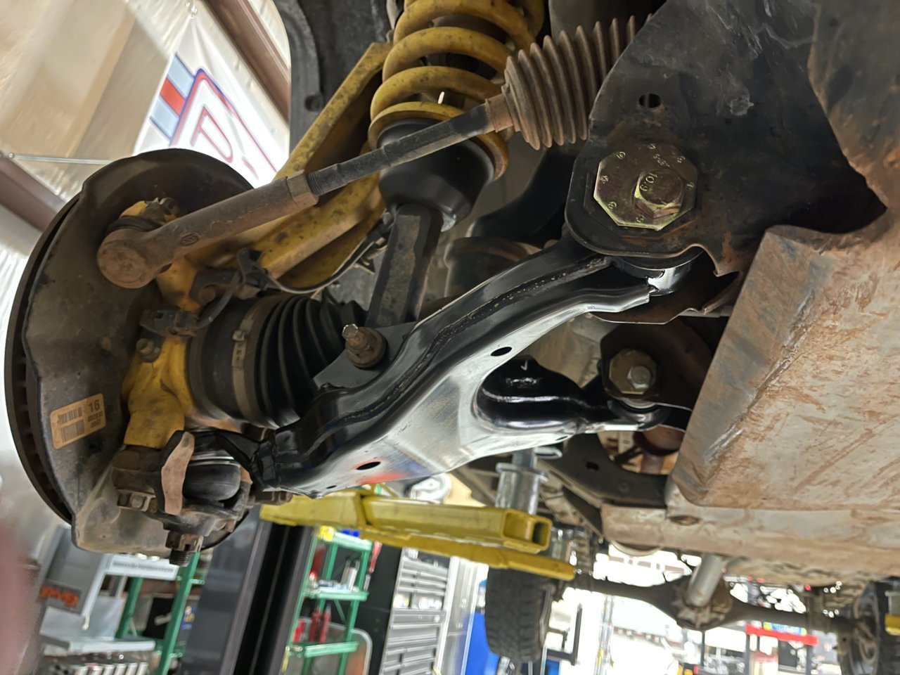

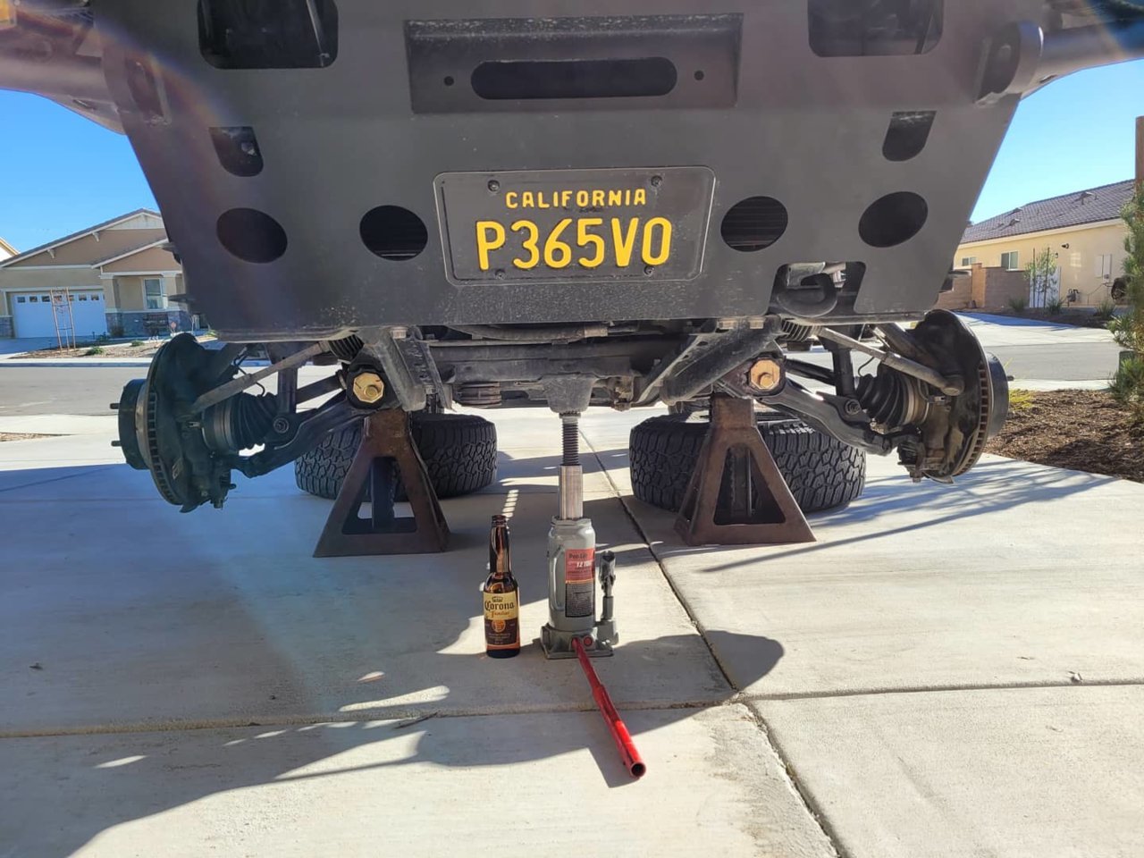

    Maxed out caster.
    Installed cam washers just like it was before.
    Although after install the cam washers are not matching, hoping alignment shop can correct it
    Had to trim the copper sleeve to fit my whiteline bushings.
    But they look sweet Installed and not budging
