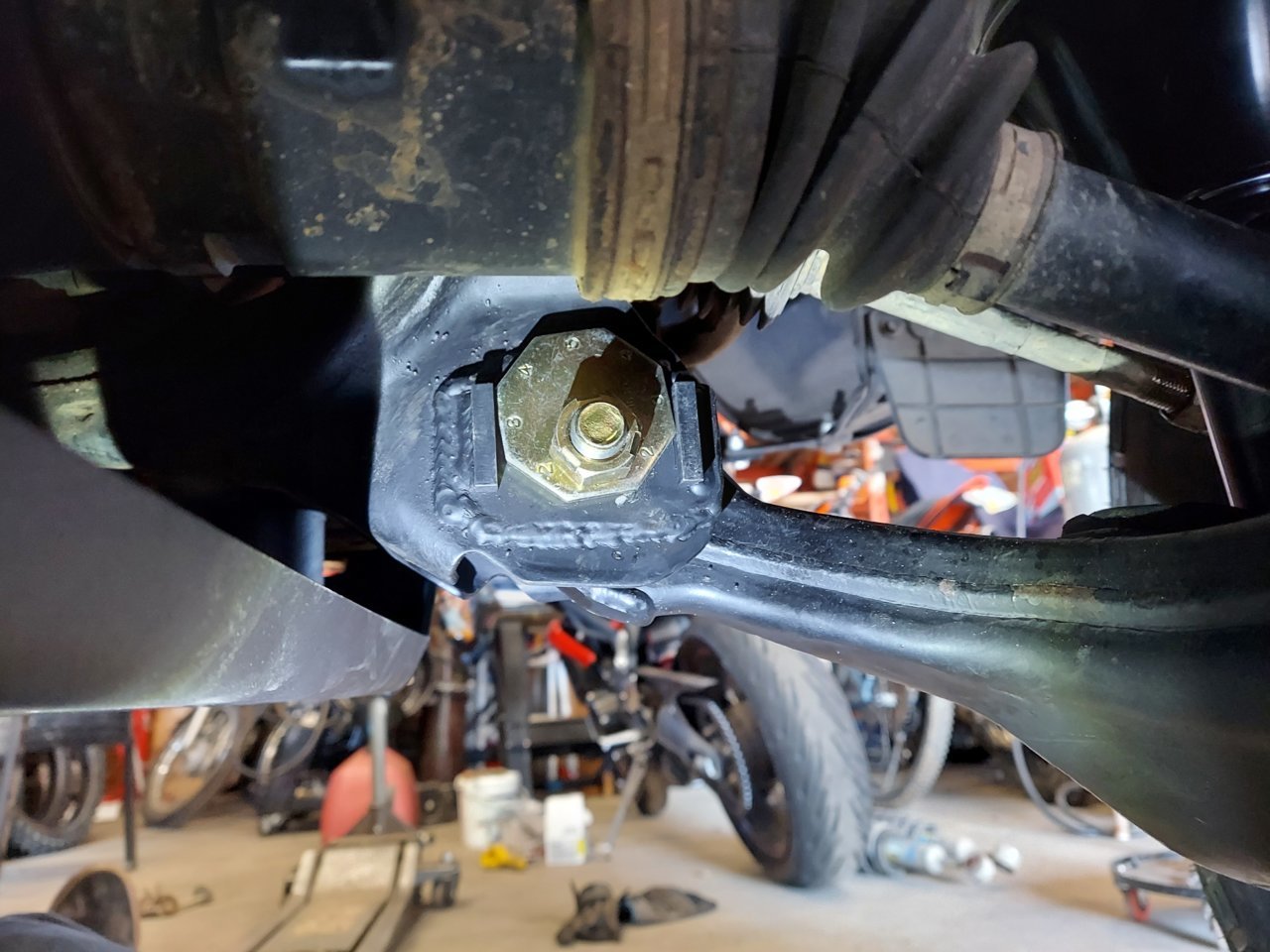

    Just got mine installed. Not very impressed.
    Plates don't fit tight in the tabs. Which pretty much defeats the purpose right from the start IMO. Copper sleeve seems like a pretty half ass solution. Back bolts are a touch too short.
    Having installed taco tabs on a buddy's truck, I'd go with those. Yes, there aren't as many alignment options, but let's face it, if you're installing these you should have adjustable uppers anyways. I'll see how these do, but will probably be removing them.

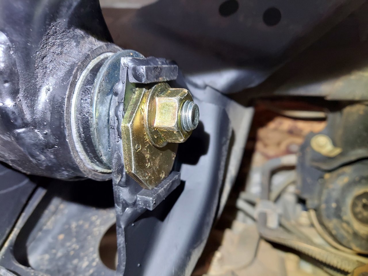

    Not very impressed to received plastic sleeves when there where zinc plated steel sleeves shown on the website. This kits basically garbage until I can source proper steel sleeves.
    *edit* just noticed others received copper sleeves, which is also a huge no-no due to galvanic corrosion.

    I received plastic tube sleeves too, I was under the impression it was supposed to be metal sleeves as well :notsure:

    I received plastic sleeves as well. The pics and videos I’ve seen all show metal. Is plastic meant for the Tacoma and metal is for other models? Or is plastic meant to stop the metal from bonding to LCA bushing? @Bison Offroad

    Have the TacoTabs with no gussets. They do the job but the ears have def been bent out a bit. I'd at the very least run a reinforcement weld bead along the outside of the alignment ears.

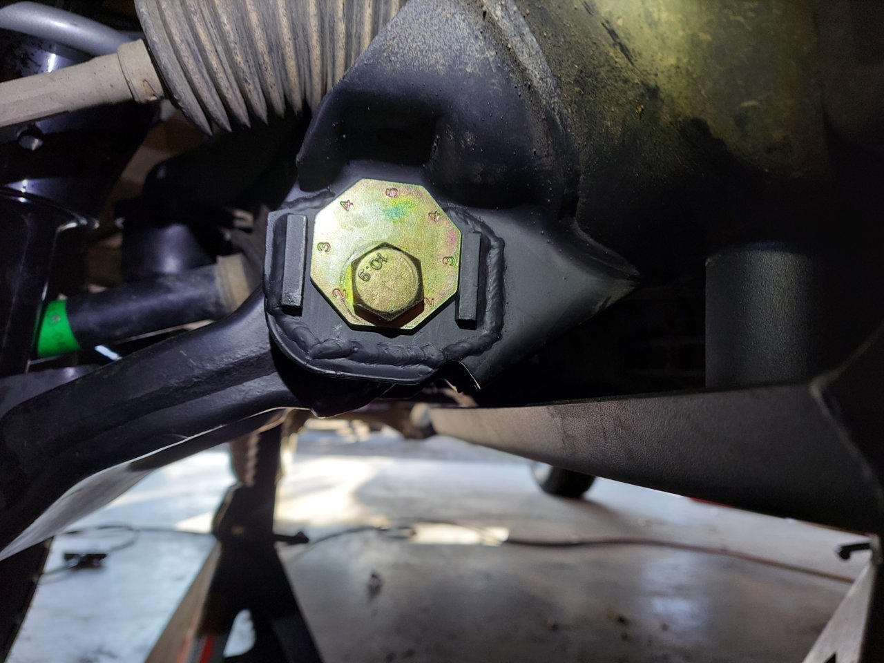

    I just bought and installed them. I have the same concerns but overall the kit seems beefy. Mine came with yellow zinc plated steel tubes. Definitely holds the alignment better, now to figure out the tie rods.
