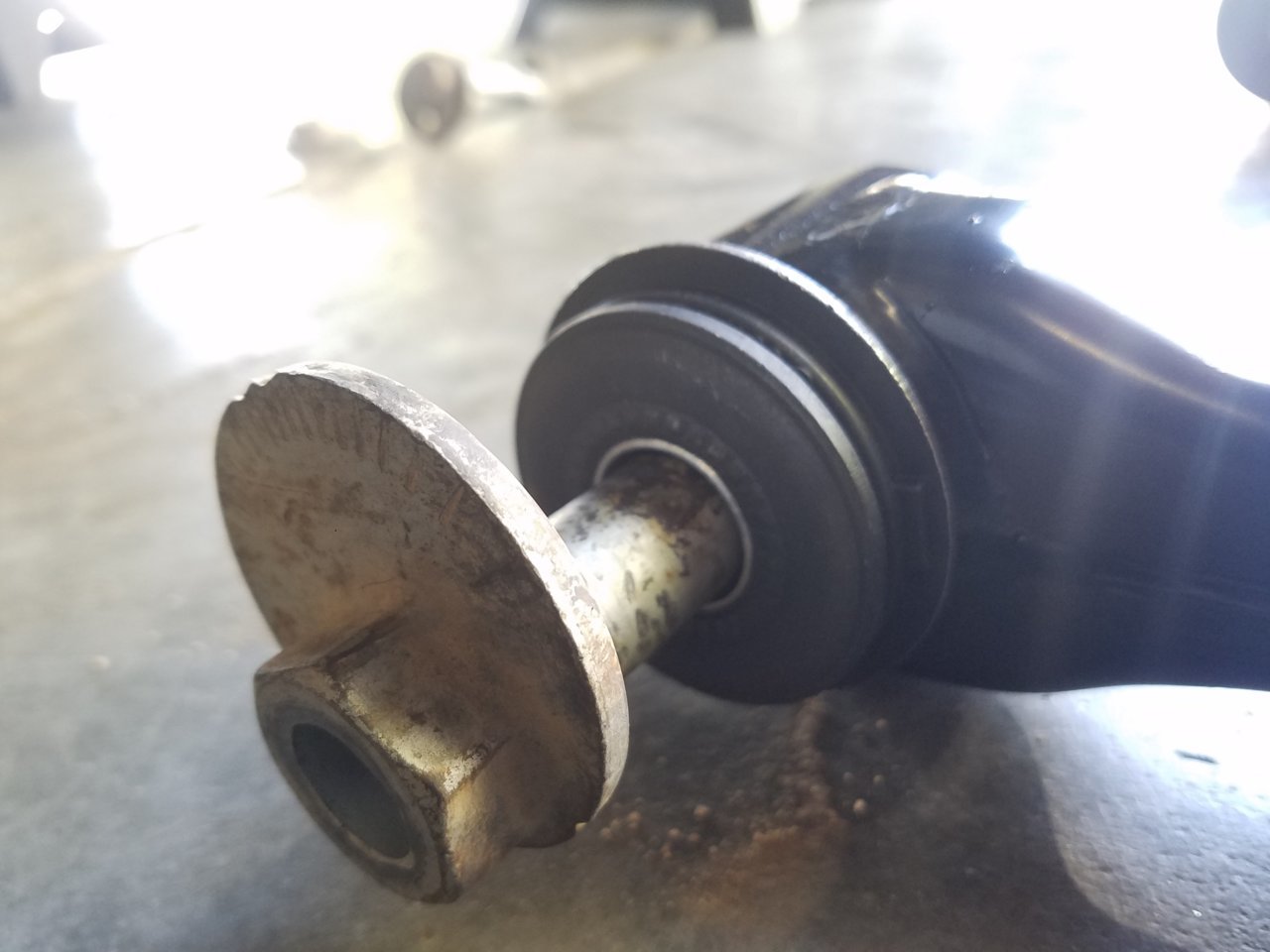

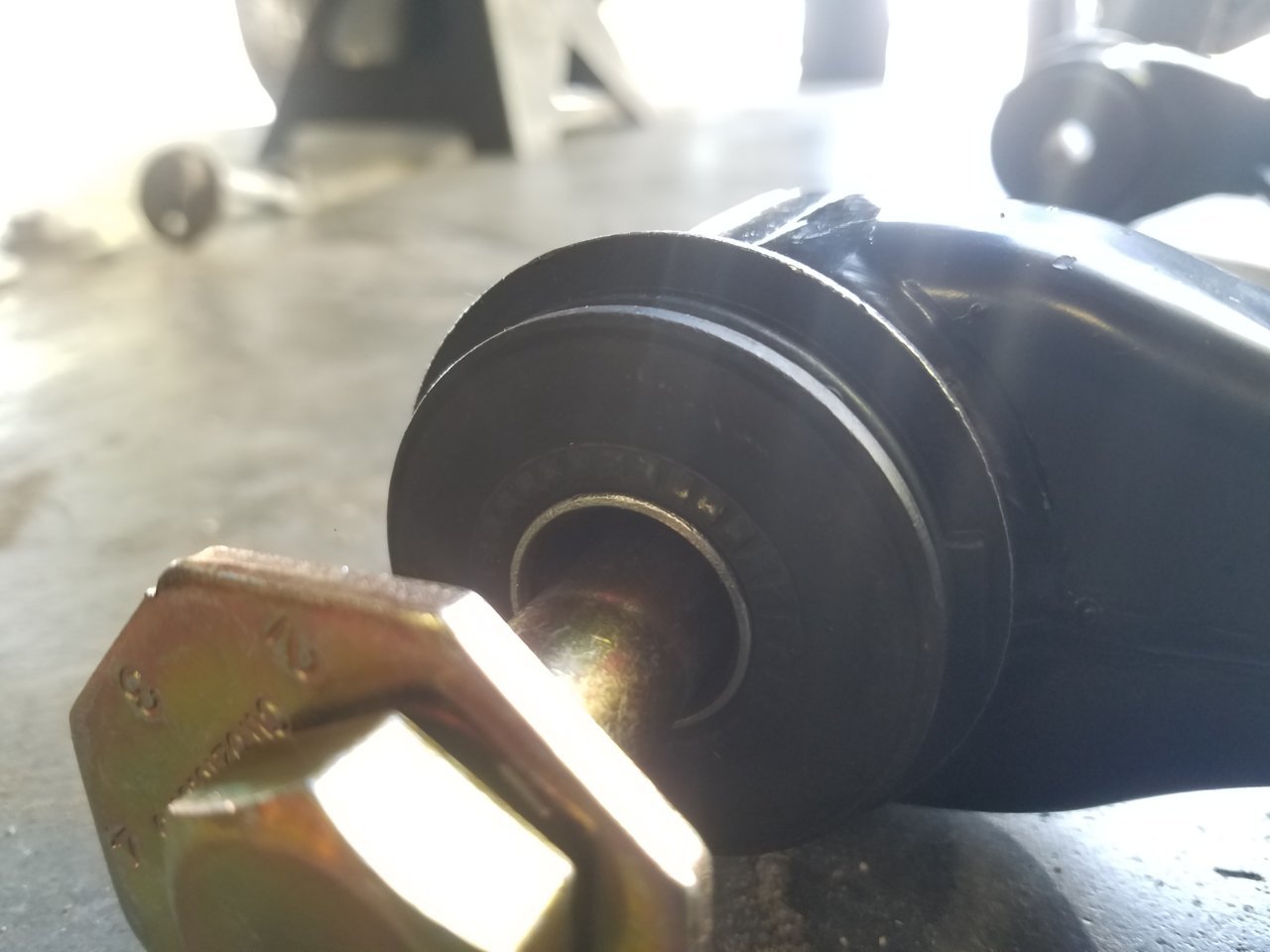

    Is this normal? Seems like the forward bolt has way too much play inside the bushing. 20200905_145902.jpg 20200905_145842.jpg

    Are those 2nd gen LCAs? The 3rd gen version has larger bushings.

    They are 2nd gen LCAs although they are moog replacements. But they have the same play in my oem LCAs. The bolt supplied literally fits inside the oem cam sleeve. No way to adapt the two together though. Ended up putting the OEMs back in.
