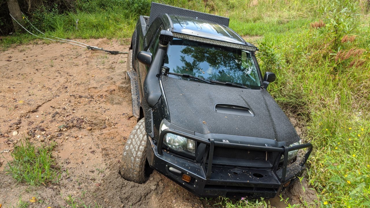

    Locker anytime Fog Lights anytime Full LED light conversion TRD cat back Rear cat delete Exaust Y reroute away from actuator Alloy Clutch master 2000 4Runner "Dog Leg" shift leaver Marlin shift seats and bushing Rear seat delete Rear diff breather extension Chrome grille swap Debadge Rear seat delete Honda blower motor beefy plug and wire mod Anytime 12v and USB with volt gauge in bed Blue Sea fuse box Hella AND 70's Caddy horns Low profile recessed hex drain plug swaps Alluminum battery strap 7pin relocated Backup cam on anytime Various other creature comfort and personal taste mods.
    Definitely interested in these my alignment will *not* stay put bashing with 34's.
    I can absolutely install these in my garage, done everything else there myself, I do not have a lift.
    Considerations the truck has which may or may not make a difference in compatibility:
    Uniball tubular upper control arms.
    Total Chaos Cam Tab gussets.
    Polyurethane control arm bushings.
    Bilstein 5100's on 2nd notch.
    OME 887 coils.
    Cooper STT Max 285 75 17 tires (34's)
    This is to say, my alignment is not stock specks, I need forward caster to clear the already agressively cut cab mounts.
    Anything else you may need to know just @ me.
    Best picture I have of my truck on my phone right now:
