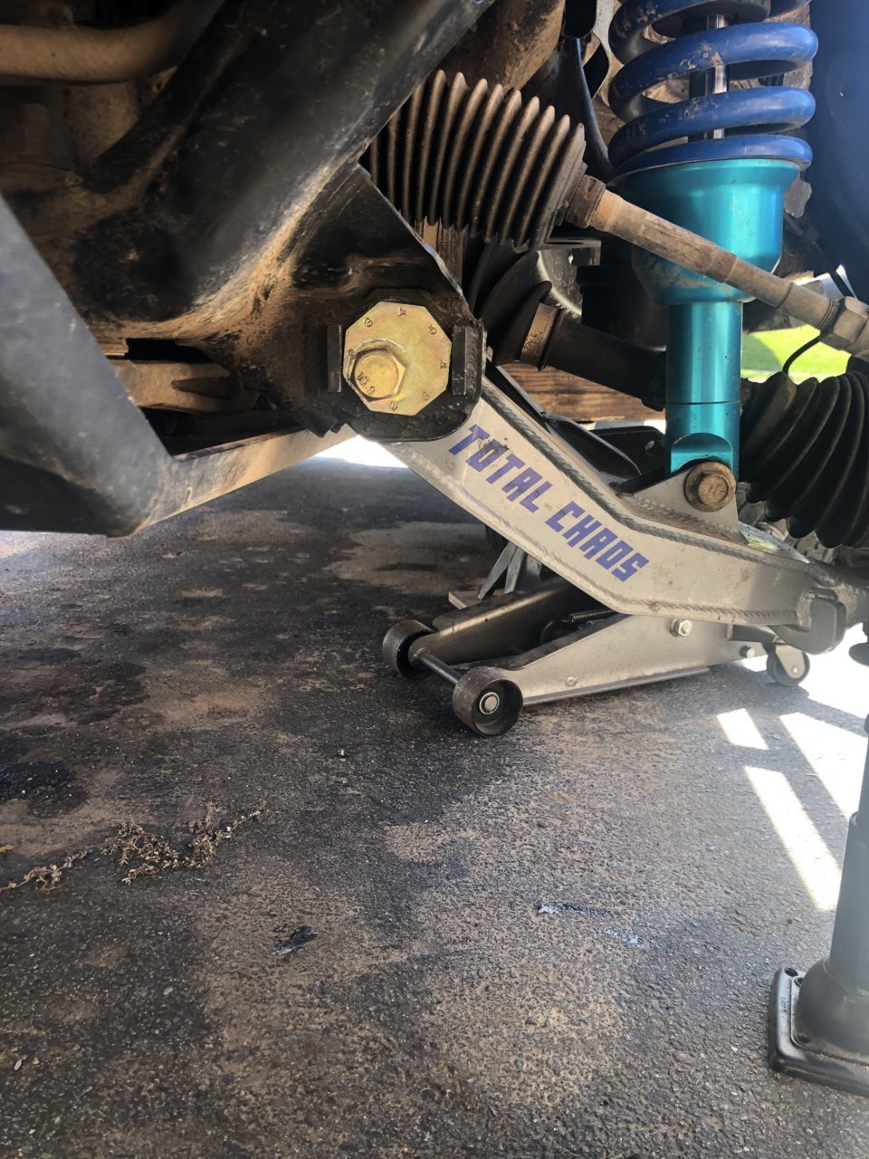

    2019 Cavalry Blue Tacoma TRD OR (sold) 05 Duramax
    Kinda like this lol
    Plus a pry bar. And some cussing.

    Ugh. But what if I used antiseize and have recently replaced LCAs?

    You should be fine. I have a weird alignment because I use the adjustable SPC uca’s. The back bolts were a b to get the cam tabs in

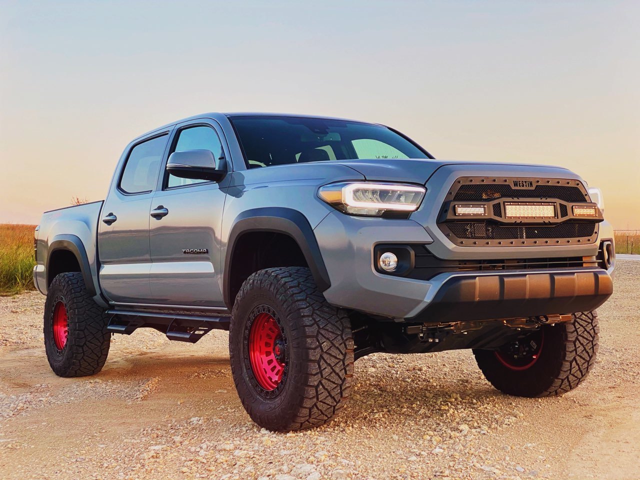

    I had to show this off...a 2020 Taco with our TC-1502-32.5 (3" Front 2" Rear) kit owned by female flat track racer Madison Lamb. She pushed the tire size a little; 18x10 Fuel off road Red Zephyr wheels and 33 x 12.5 Nitto Ridge Grapplers. Madison says they rub, but she's going to do a little trimming...

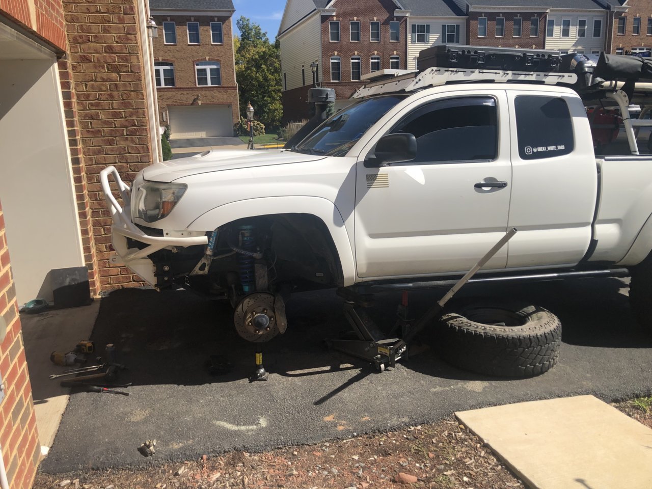

    @Bison Offroad sorry im getting to this late/not really following the rules of the contest. Its been busy for me/weather sucks to work outside. But im finally starting now in my driveway.
    Heres my little writeup as Im in the middle of things now.

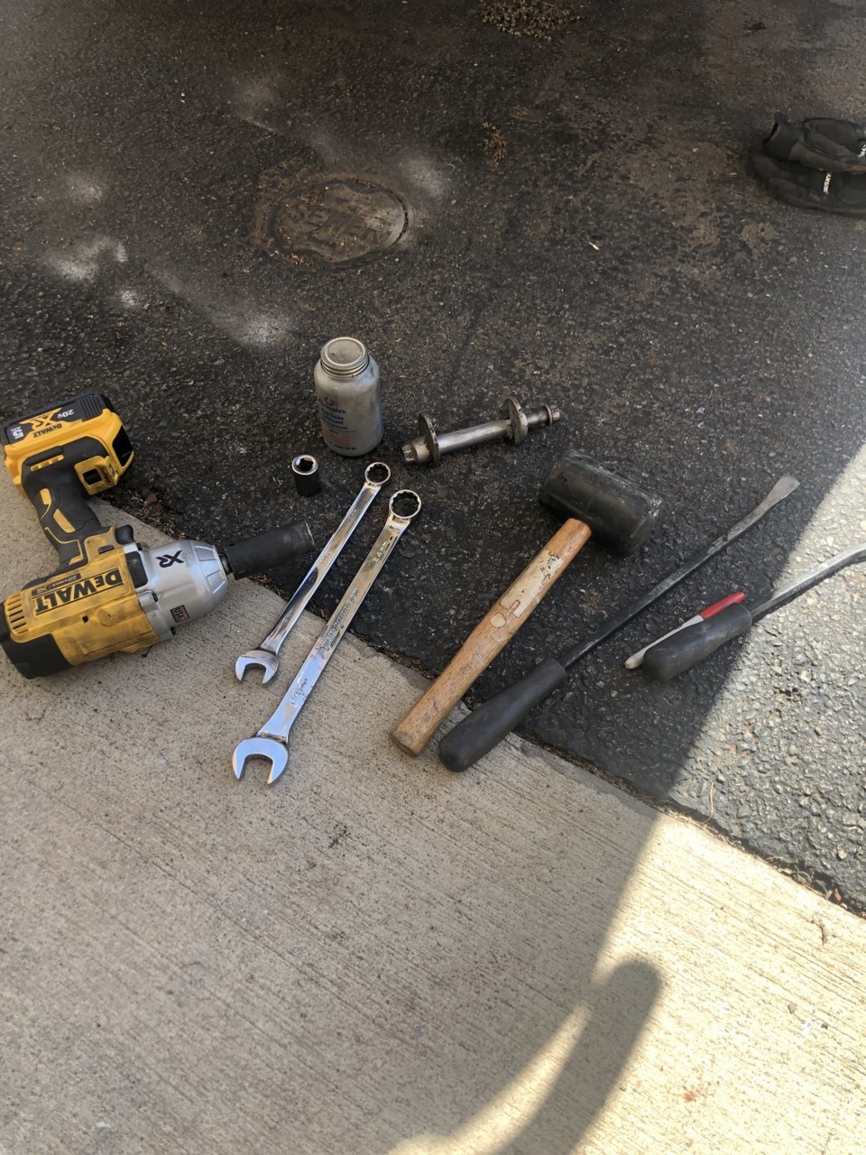

    List of tool needed:
    24mm wrench and socket
    22mm wrench and socket
    19mm wrench and socket
    Anti-seize
    Various pry bar sizes
    Floor jack, and additional bottle jack

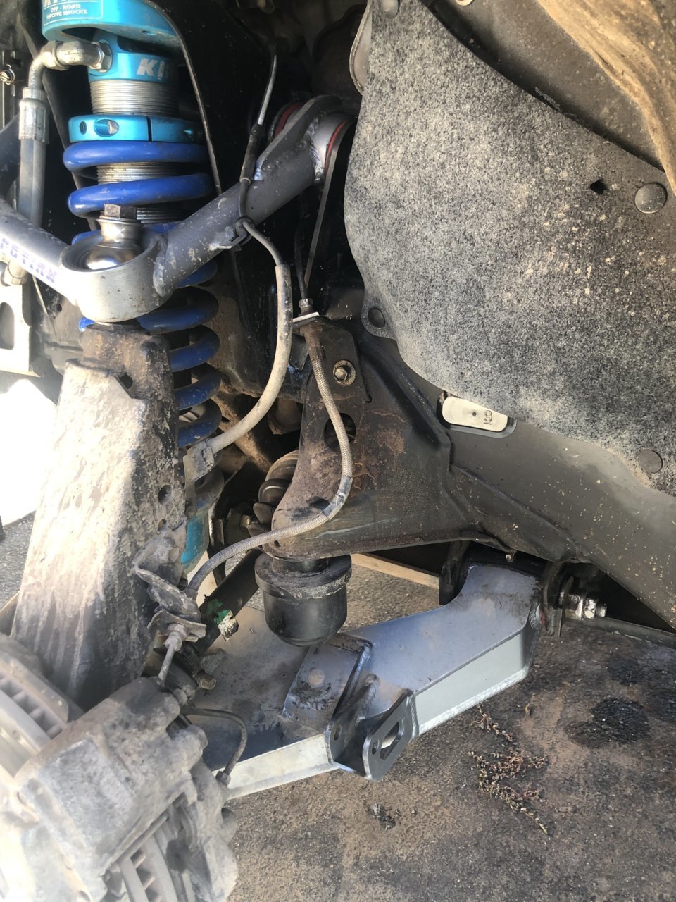

    1. jack up the truck, and secure with jack stand.
    2. Remove wheel
    3. I started at driver side front cam. Remove with 19mm wrench and socket.
    - my removal was easy because I just replaced my LCAs in June. I used plenty of anti seize.
    4. Mark/take pictures of where stock cams are before removal.
    5. Remove stock cam.
    6. Use lots of antiseize inside the stock bushing, sleeve, and on the new bolt
    7. Generally line up the hole on stop cam with where your stock cam was and make a line with a marker.
    8. Install stop cam with line in correct position- on front and back.
    9. Reassemble. Repeat for other 3 positions.
    10. Torque to spec. I am choosing not to do 200 front/135 rear. I was reading on other threads that 200 is way too high. I will be doing 150 front/120 rear

    Driver side done. 2 hours is not bad for messing around and watching @Dirt Complex video a few times, and then just copying what i had in there in the first place. Great video though!
