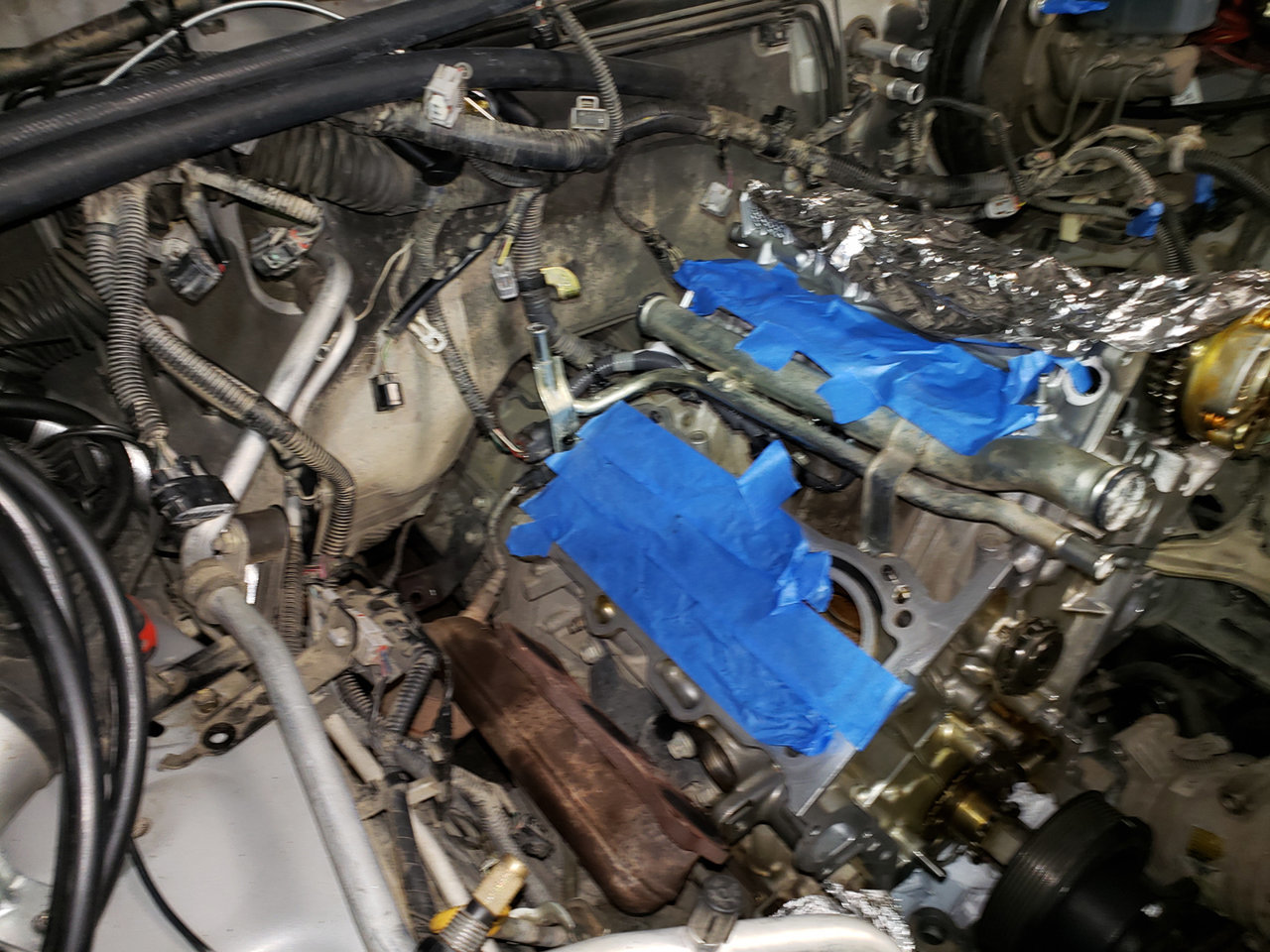

  11. Sep 8, 2023 at 12:48 PM
    #51
    mk5
    mk5 Asshat who reads books
    Mar 15, 2018
    #247373
    1,532
    SoCal
    '05 access cab 4x3
    Thanks! I added yours and @RobHPT 's experience to the HG failure table on the other thread.
    And wow, replacing that tube requires pulling the heads again (or at least one of them) so I'd say $400 was a lucky break there.
    Sorry for the blurry photo, but this is the valley tube assembly... two tubes supported by two welded brackets that bolt to the block in the valley.
    It is possible to replace without pulling the heads, by cutting the old brackets and sliding it out, but then you can't properly secure the new one either.
    The knock sensors are located beneath these tubes as well, and their wiring is insulated with a material that rodents love to eat! Repairing that damage can be a real nightmare... some folks manage to cut the tube brackets, slide out the tube(s), then resplice the wires without pulling the heads, but depending on the damage, pulling one of the heads is sometimes necessary. I got "lucky" (if you can call it that) in that my truck started throwing knock sensor codes just as the HG repair became inevitable... so I didn't have to struggle trying to replace the knock sensor wires with the heads in the way.
    Knock sensors... rodents eat the wires right at the connectors.
    I'll mention that, in my case, my insurance would have covered the sensor repair including pulling one of the heads, but ONLY IF it was a clear result of rodent damage. However, when the adjuster came out to look, he didn't see any other signs of rodents (no nest, no pellets, no other chewed wires), and of course the knock sensors themselves can't be seen without disassembling the engine. So he warned me, I might have to foot the bill myself. I decided not to risk it, so I did the job myself, which in hindsight turned out to be a good call, because I didn't see rodent damage. I guess my sensor or its wire died a natural death; I replaced both.

  12. Sep 8, 2023 at 2:46 PM
    #52
    Tbryson2
    Tbryson2 [OP] Well-Known Member
    Apr 27, 2014
    #128591
    145
    Terry
    Central Florida
    05 PreRunner SR5
    Wow! I was under the impression that tube was (relatively) easy to get to, but I am fairly ignorant about the whole thing. Sensors, sensors, sensors. Why can’t designers build in a easy way to replace offending parts that could fail “routinely”. In my younger days I would have dove right in as you did. Not anymore. I just have to worry if I can afford it ! . Thanks for the pictures and details! Always fascinates me! Hopefully they changed my sensors while they were in there, but I wouldn’t bet my rent money on it!
  13. Sep 12, 2023 at 4:14 AM
    #53
    retardrabbit
    retardrabbit Member
    Jan 3, 2019
    #277898
    24
    frank
    2013 TRD OR ACCESS CAB Magnetic Grey
    Bone stock. Well, I guess I did disable the seat belt chime, and I added a nice MOLLE panel to the back of the passenger seat
    @Tbryson2
    Thanks for coming back to follow up!
    That coolant pipe that passes through the valley:
    a) totally blocks access to the knock sensors and their wiring sub-harness.
    b) by the book, requires removal of the head for bank 1 because the bracket supporting it is the stupidest design in the world and is one piece instead of being two part and allowing removal of the pipes independent of the cylinder head
    c) (@mk5 this is for you too) can be worked around if you ever need to replace the knock sensors (mine were supported by a copper wire wrapped around the bolt that holds them on, fed through the front of the motor, had the bolts started, and then had the wire yanked from around the bolt and torqued down.
    Honda also makes an electrical tape with capsaicin in it to keep the rodents out. P.N. 4019-2317
