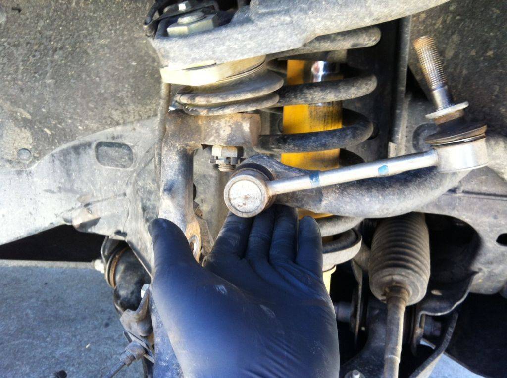

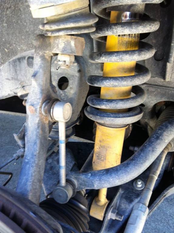

    OK, so I've wanted a detachable sway bar for a long time. You can't just disconnect the ends and leave them there - they'll interfere with suspension components at best and puncture CV boots at worst. But, maybe we can just disconnect both ends and swing them out of the way and fab up a little bracket to attach them to? Let's start with a few photos of the sway bar end in the wheel well. I've got mine on a ToyTec sway bar relocate bracket.

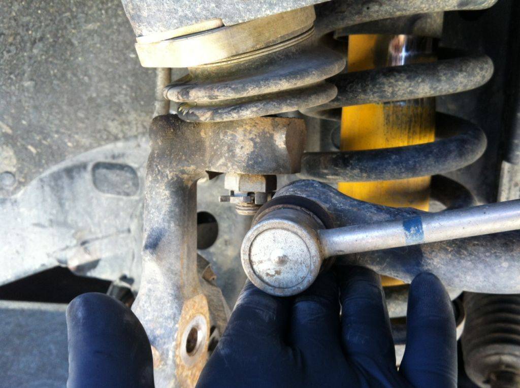

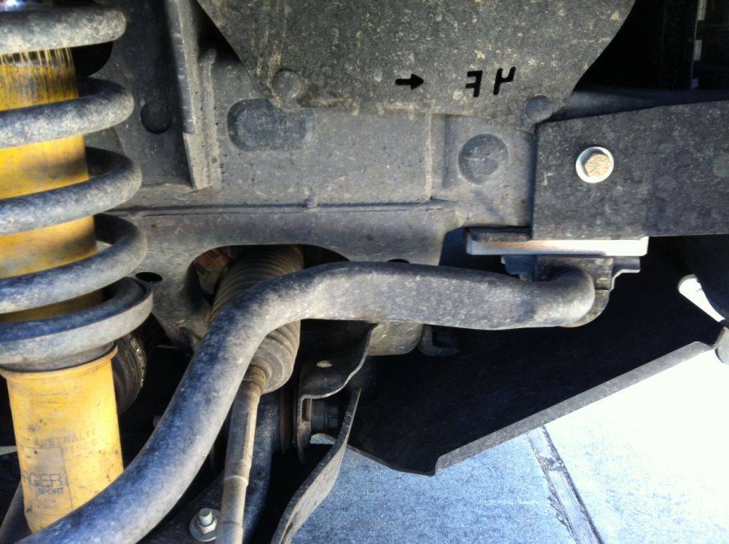

    OK, so let's disconnect both ends, and "swing it out of the way."
    Well, that didn't work out so well; once it's disconnected, it can't clear the spindle and UCA.

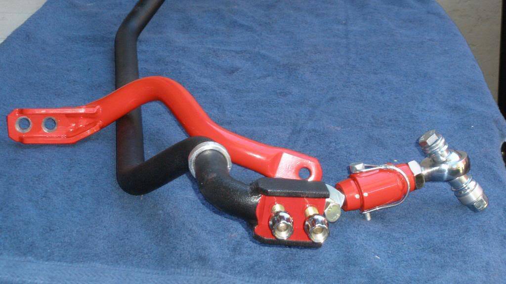

    So, if we want it disconnected, we're gonna have to remove an end. Here's one that someone else did for an FJ cruiser once:

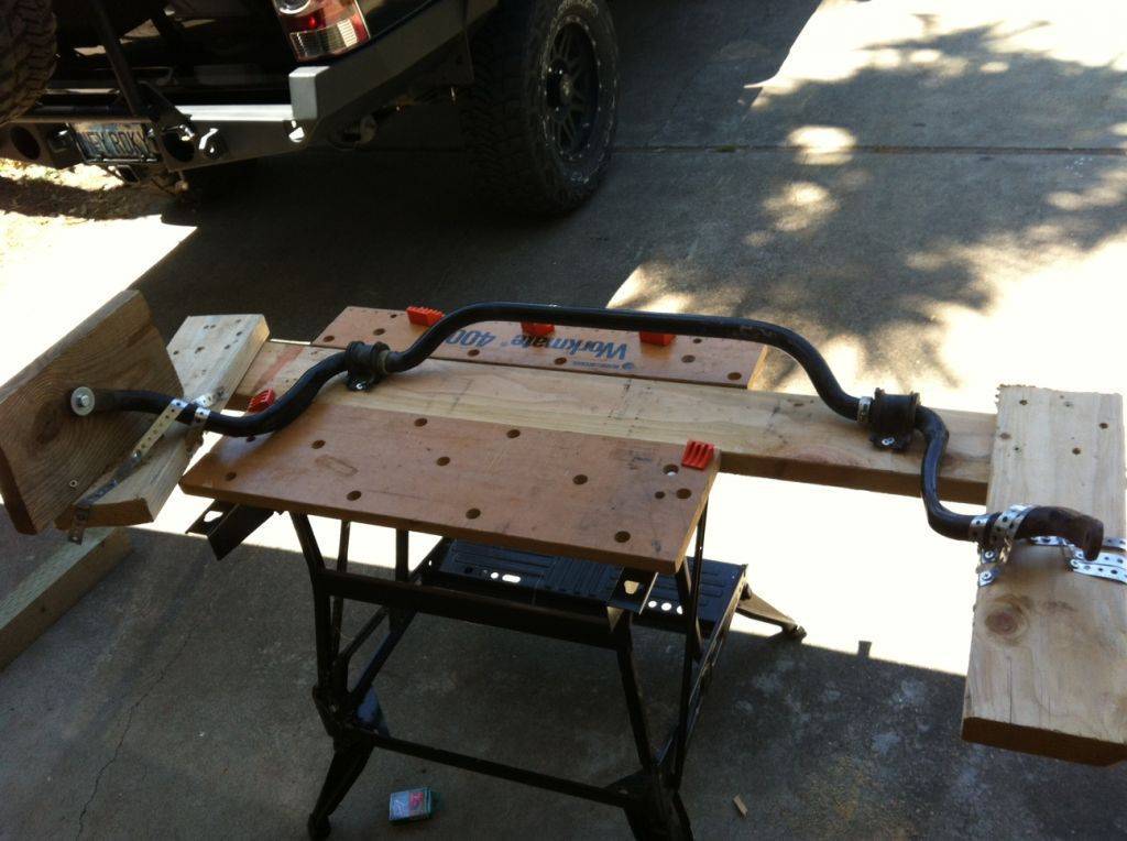

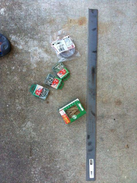

    You're gonna need an angle grinder, a grinding wheel and couple cutting wheels, some lumber (I used about 9' of 2x6) a bunch of fasteners, plumbers strapping, a length of 2"x3/16" steel, and a length of 1"x1/4" steel. I used a 4" grinder, but a 7" wouldn't be overkill for the job. The first thing I found out is: the sway bar is constructed of SOLID steel. It's not tubing.

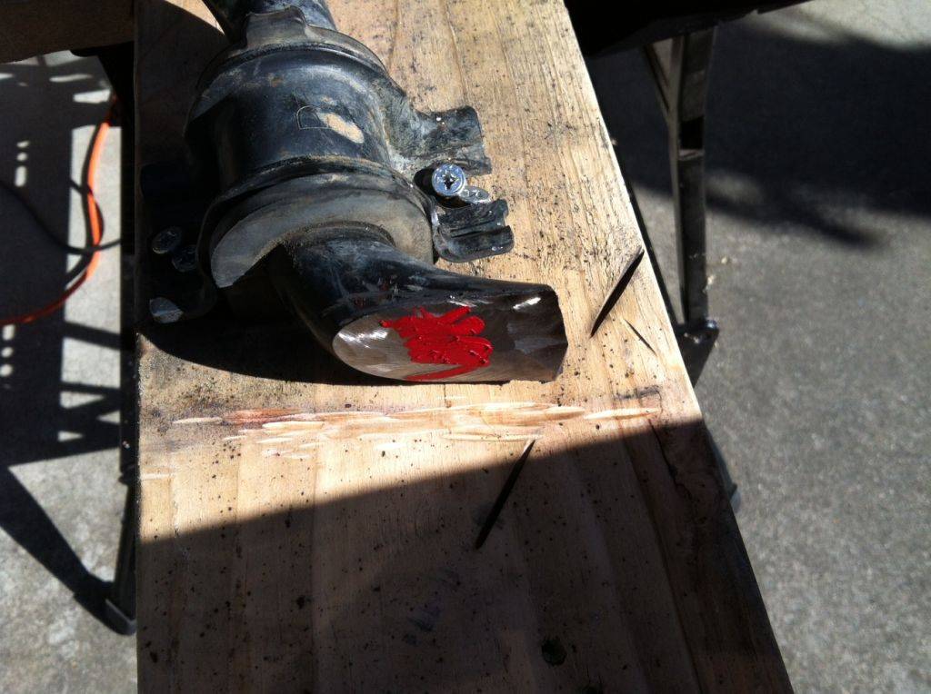

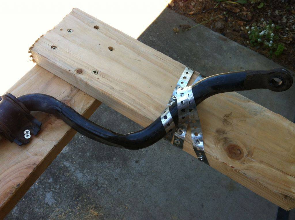

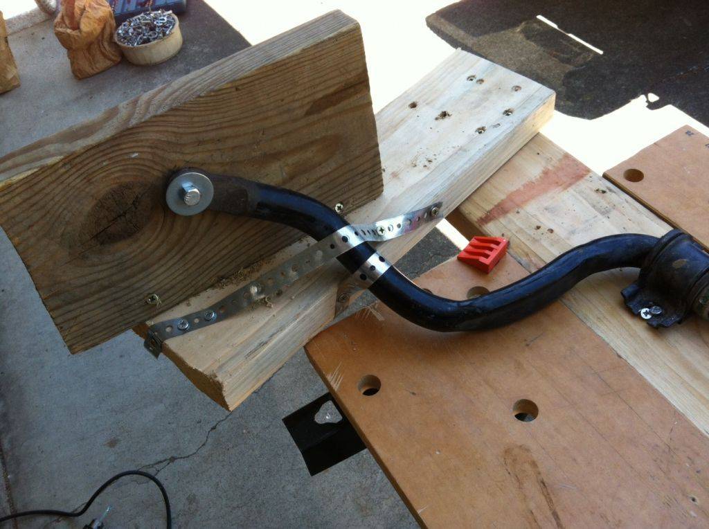

    We're going to cut the sway bar. Once it's cut - we don't want anything to move, so we can fab up a new disconnect able link in between them. If the end moves - we'll never be able to re-create the original shape. So we need it in a jig.
    So, make up a STURDY wooden frame and rigidly strap the sway bar to it. Think about moving a potential neck-injury victim. You want more clearance around the side you're going to cut, and you want that end more rigidly supported. In addition to more lumber, and the plumbers tape, I used a lag bolt through the link-end.
    Keep in mind the sway bar is upside down. So whichever side you're looking at is on the opposite side. In this case - I'm working on the passenger side end.
    We don't have to be so uptight about the other end, but it does still need to be rigidly attached to keep the entire bar in place.

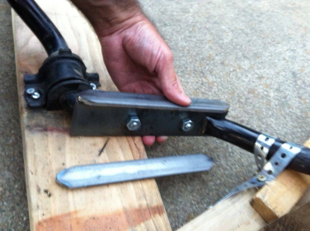

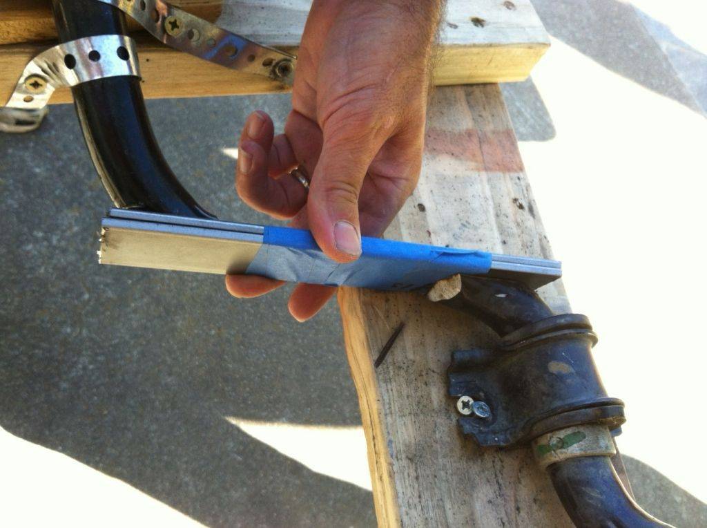

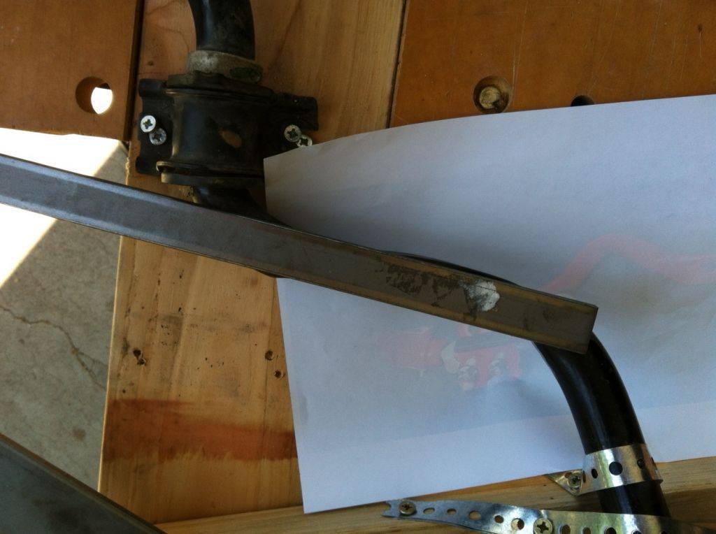

    OK, so, here's the basic concept: we're going to use the raw steel to make a "two part" I-Beam, half of which is attached to the main bar, and half is attached to the removable end. Top view will be something like this:
    Cross section like this, only with TWO pieces instead of one. When I took this picture, I hadn't cut the bar yet and I was thinking it was made of tubing. So my original concept was for a single thickness of this 3/16" strip. Ha.

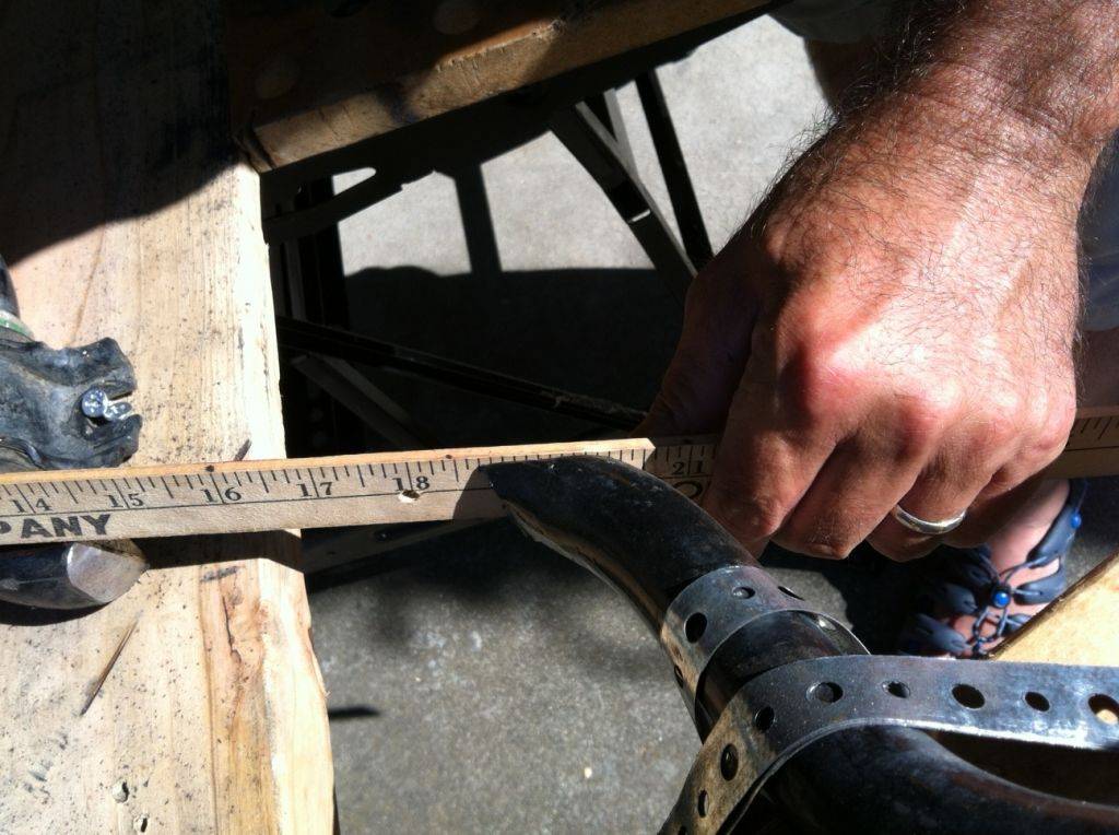

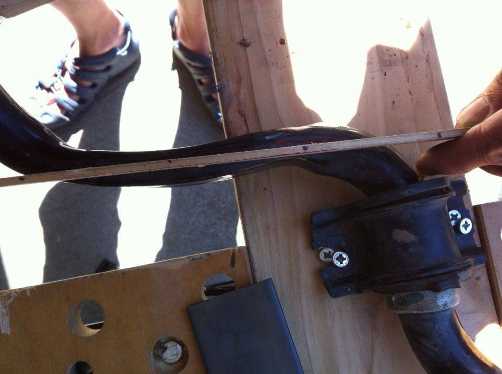

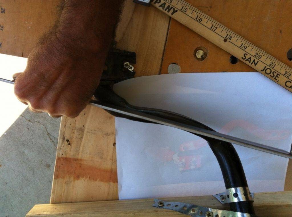

    This yardstick shows the intended positioning a little more accurately. Before we start grinding anything, we'll want to change into real shoes. :-O

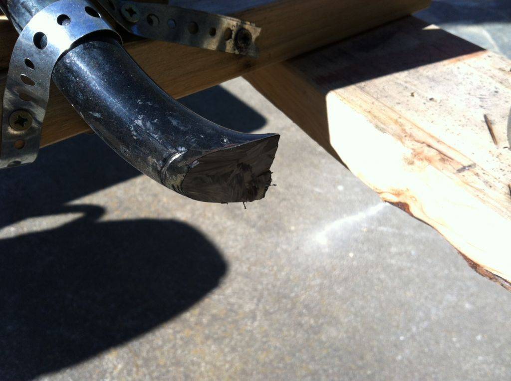

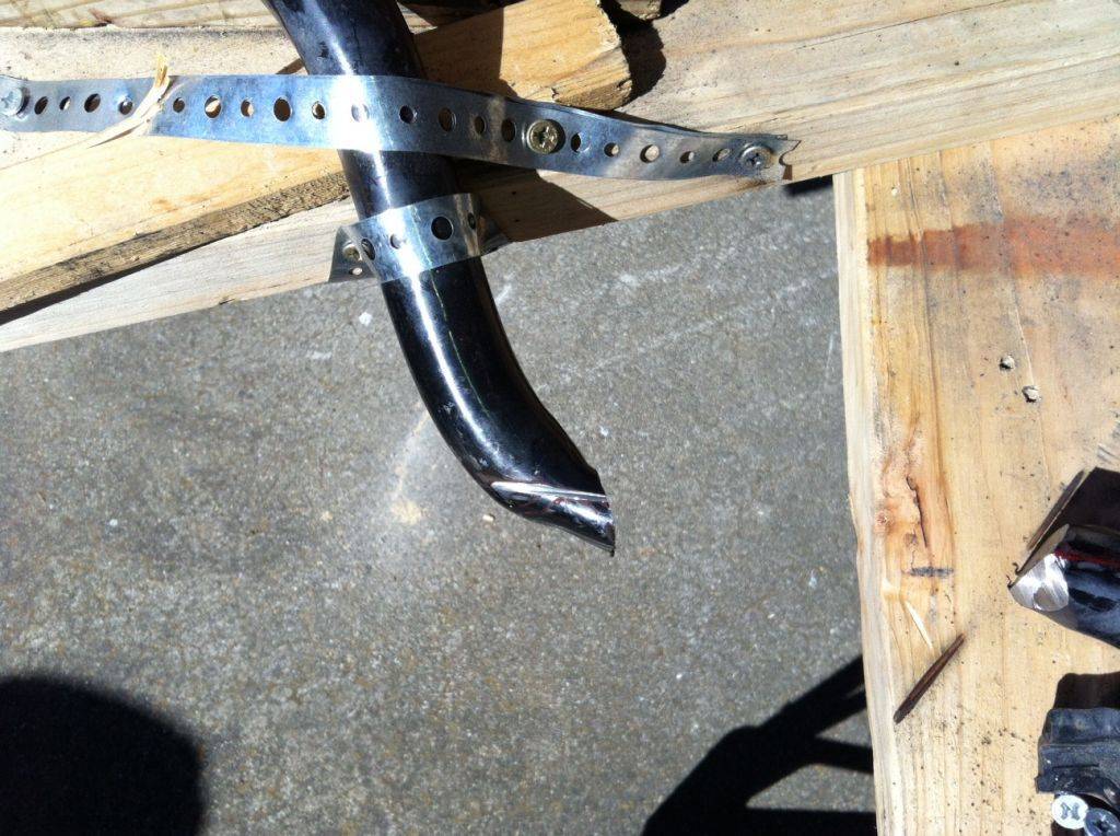

    Despite all my efforts, once I cut through the bar, the end shifted down a fraction of an inch as a result of the pressure from my tie-down strapping. I drove this 1x2 into position to return it as close as possible to the original orientation.
    In cutting the bar - now's when you find out it's SOLID STEEL. But once the bar's been cut - no going back. Success or scrap metal.

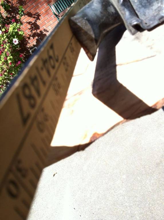

    OK - here's the most important marking. I ran a yardstick along where the new I-Beam member is going to go and marked both ends as they'll be cut parallel to it so each end can be welded to one half of the the split I-Beam. These will be the next cuts with the grinder.
    Now, I've used the grinder to mark the line where the next cut will be

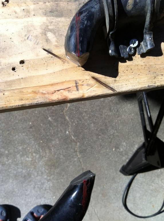

    Rough cut of one end completed:
    Using that cut to confirm the measurement and direction of the next cut on the opposite end:
    And, once that cut is made, again using the yardstick to show how far off the included angle is between the two cuts. We need these to line up!

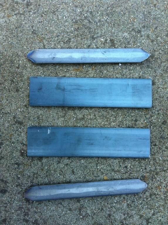

    Here' I've cut the two pieces of 2" x 3/16" to length and started to use them as a jig since they represent the exact final thickness of the I-Beam that will be connecting these two pieces.
    Marking the "high point" we need to grind down to correct for flatness and orientation:

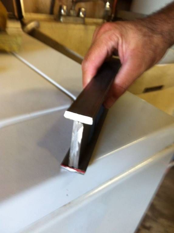

    Here's the "double I-Beam" concept - two adjacent verticals, with a 1" x 1/4" top and bottom plate. The top plate will be welded to one side, and the bottom plate will be welded to the other side.
    The "I Beam" pieces cut to final size
    The completed sway bar cuts:

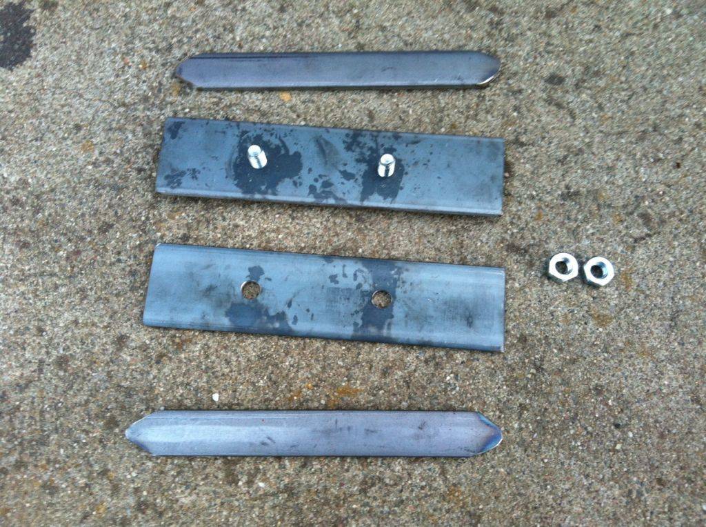

    The verticals will be separate - one attached to the end, the other to the "main" part of the bar, and held together with two bolts. So when we drill (I used a drill press) we want to drill through both pieces at the same time - at least the pilot hole. Since I expect to weld the bolts into place on the inner piece, I made those holes slightly smaller, just barely large enough to accommodate the bolts. The other side, I used one "over" size on the holes to allow for easier alignment and fitment. Since the link-end is a 17mm nut, I obtained nuts and bolts in the 17mm size, so I'll only need one wrench to remove the sway bar end.
    The whole thing (mostly) in place. The bottom plate won't fit while the lumber jig is still in position. But that's OK. Only the vertical parts of the I Beam have to be welded (or at least tacked) while it's in the jig. The top and bottom plates can be welded on after.
    I've mentioned before
    on TW - there are two things I don't do: I don't weld, and I don't perform jobs (like setting up gears, or adjusting valves) where the difference between success and failure is measured in thousandths.
    So now, I just need to find someone to weld it up, and then I can do a test fitting.

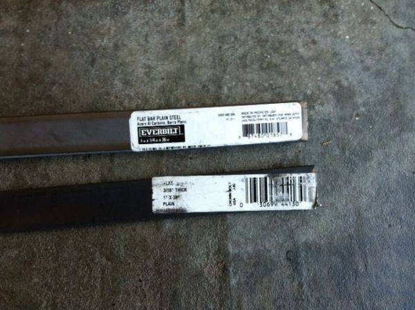

    I wanted to use "off the shelf" stuff. Angle tends to be square - e.g. 1" angle. If I could even find 2" angle iron, the top dimension would be WAY too wide so I'd end up running the entire length with a grinder, though I suppose that's possible.
    As far as index marks for alignment - I figured the verticals would be tacked up while still on the jig - then removed from the jig for welding.
