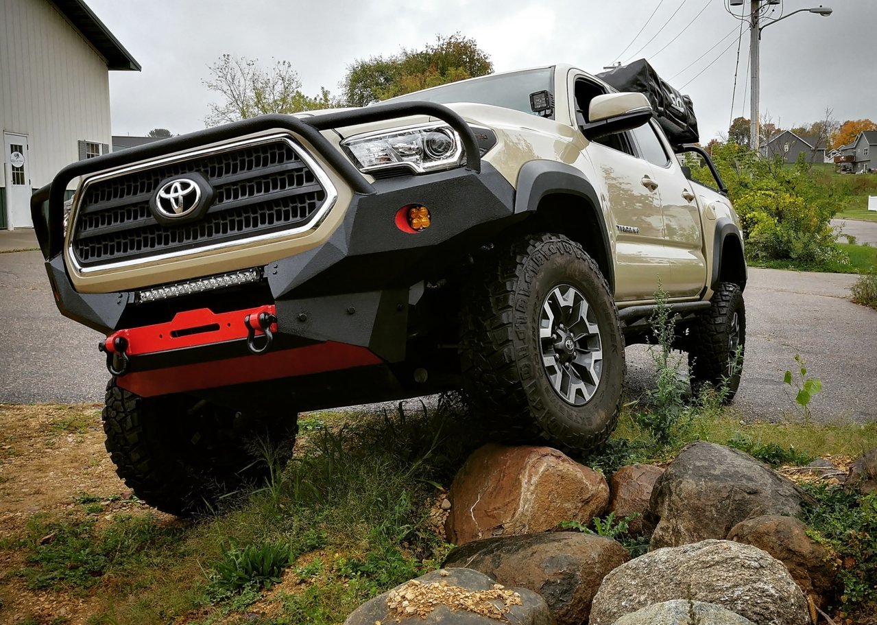

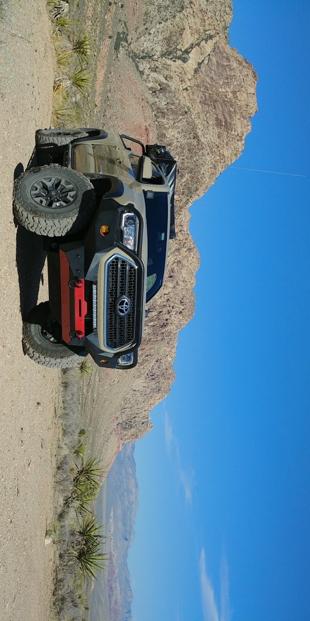

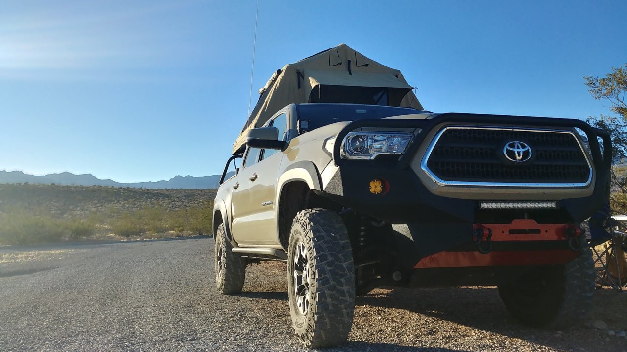

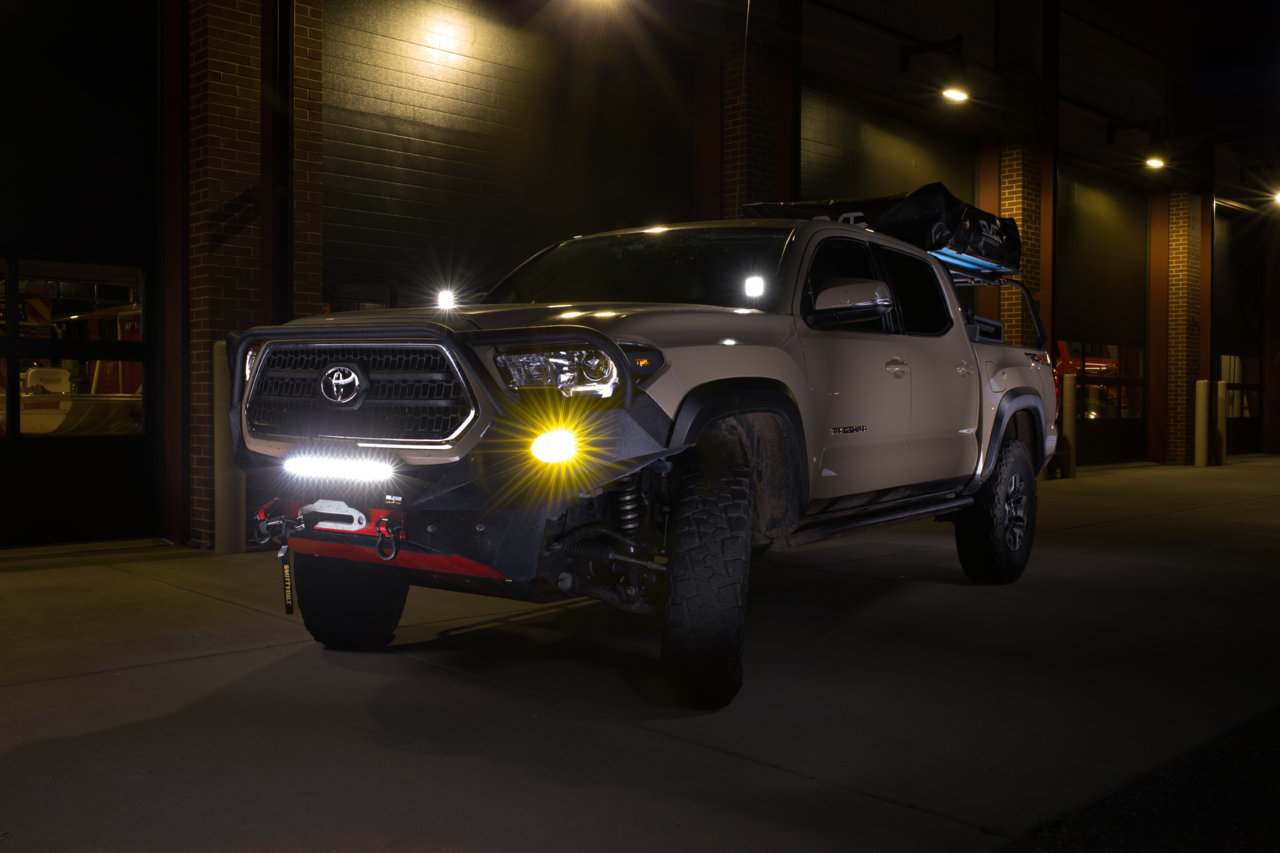

    Nice truck! Any more pics of the front bumper?
  4. Apr 14, 2018 at 1:45 PM
    BEAR_KNIFE_FIGHT
    BEAR_KNIFE_FIGHT [OP] bearly famous
    May 21, 2016
    #187524
    2,603
    Alex
    Minnesota
    2016 TRD OR 4X4 DCSB Slowsand, 2017 WRX WRB
    For sure man, I'll get some more uploaded here in a bit!

    Sweet! Looks really good from that angle

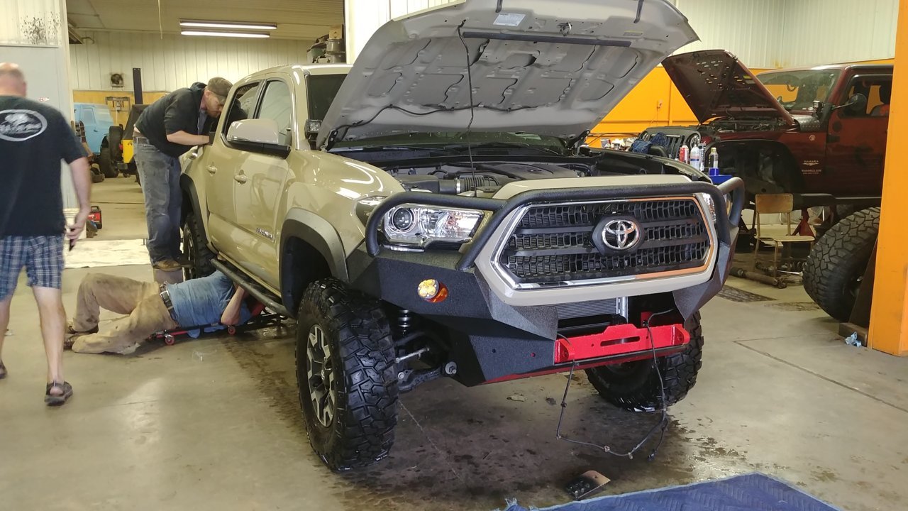

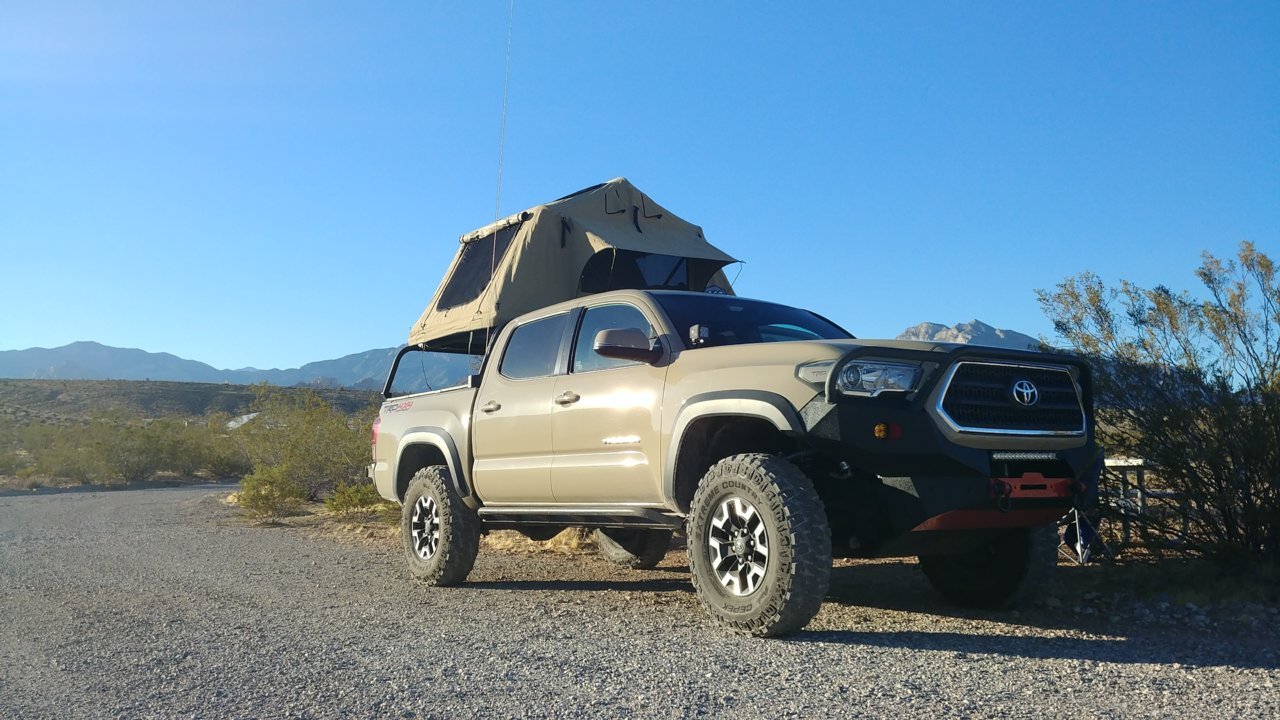

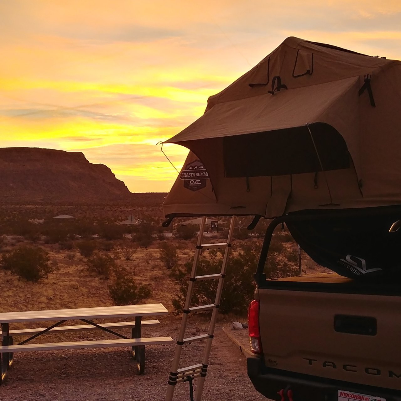

    Next up with an RTT -- I wasn't really in the market for one but there was a group buy on CVT tents, so I figured I might as well jump in on it. Turn around time was expected to take a while, but it wasn't an issue as I had no way to mount it to the truck anyway. I also ordered sliders and a rear bumper from Mobtown Offroad. Awesome construction and decent shipping time. I met with a shop close to my house that does a lot of custom work with Jeeps, and got to talking to them about a RTT carrier that would work with my tonneau cover. They agreed to build a custom adjustable RTT carrier that would allow me to keep the stock tonneau cover, which folds up into 3 parts. This allows me to keep the bed sealed [well, as sealed as a cover is] for Wisconsin winters, keep stuff secure and out of the way, and still have the RTT stable and easy to remove. We designed it to have 3 parts -- a 'headache'-style hoop rack section against the back of the bed, as well as another hoop over the tailgate, and a section mounted to the RTT. We attached all 3 sections together with trailer lock pins, which allows the whole tent section to hinge up and away for the tonneau cover to fold up. We designed the rear hoop to be removeable so everything but the headache section can be taken off for winter or when it's not needed. Both the headache hoop and rear hoop mount to bed stablilizers to keep the weight off the bedsides and transfer the force directly onto the frame. AS the rack covered my 3rd tail-light we mounted a 40" OZ-USA rear chase light for my brake, turn, and reverse lights.
    While the shop was installing everything, we noticed that my front drivers side shock was leaking, so that was mailed back off to Icon for servicing. Since the truck was out of commission for a while, we got to work on building a front bumper. I was initially going to go with a C4Fab front bumper, but we decided to make one in house instead. The way the shop designed it has a winch carrier section as well as a 'shell' of protection that can be removed for easy access to the front end stuff. I think we're going to go back and reshape the front end a little bit and fill it in over the summer -- I want to upgrade my lighting to a 20" Baja Designs S8 and potentially mount some XL80s on it as well. We'll also install the winch [Smittybilt X2O 10K Synthetic] at that time.
    To break the truck in, I drove it from Madison, WI to Vegas with a buddy of mine to do some climbing at Red Rocks. Everything was awesome -- truck worked exceptionally, and the climbing was top-notch.

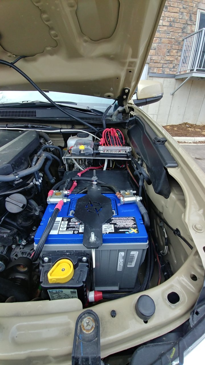

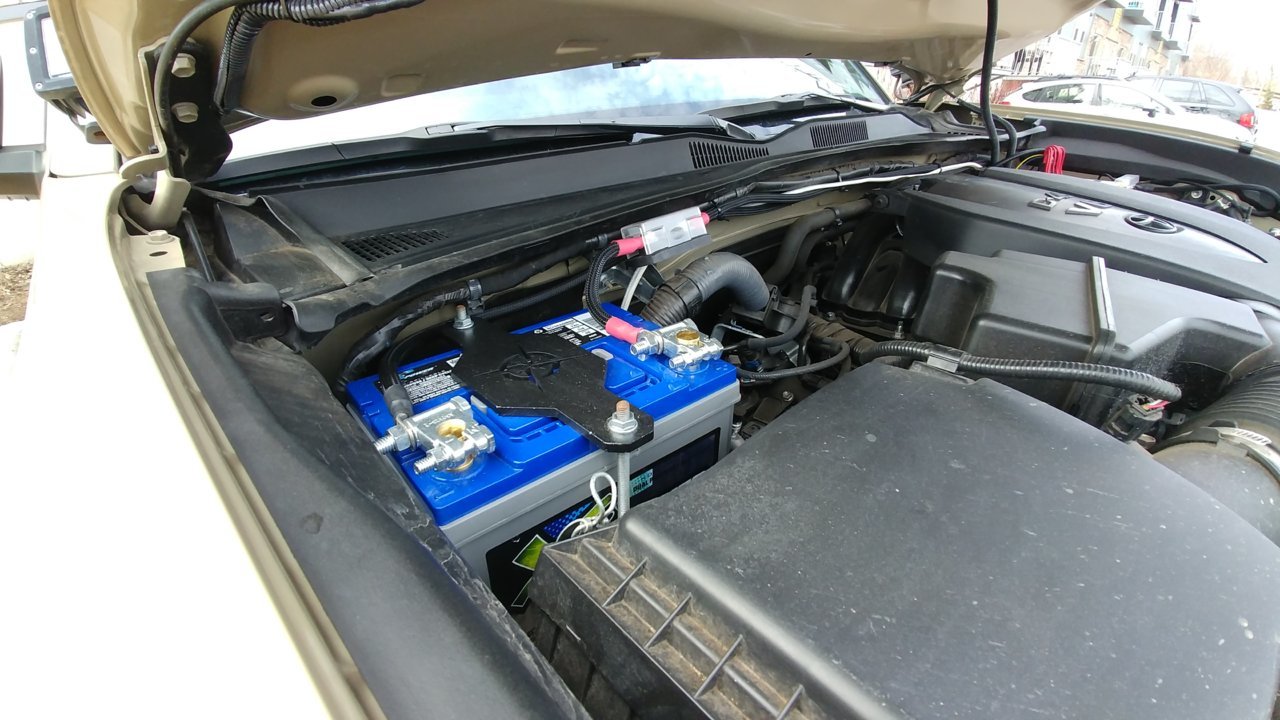

    The next thing I ordered and installed was a dual-battery system as well as Switch-Pro system -- the dual battery is the Off-Grid Engineering system common here, and the Switch-Pro is mounted along with a BlueSea on a Powertray under my hood. I'm running dual Group 35 X2Power batteries -- similar to the Odyssey 35-PC1400T. The batteries are wired in such a way that everything draws off the house battery, leaving the auxiliary battery isolated in case the house battery runs too low. The Switch-Pro is wired to run lighting, camera, and compressor, the BlueSea under the hood is wired to run the CB radio and rear bed power.
    I'm considering adding another BlueSea in the cab for all my interior wiring -- switching the CB over, wiring in the mobile UHF/VHF, wiring the seat heaters, and any audio components that need it....we'll see how it goes.
    The rear bed has a switch plate for RTT power, bed lighting, scene lighting, and the water pump. It also has a Voltmeter and 2 USB chargers [1A and 2.1A]. Eventually I'd like to rebuild the rear bumper to have a swingaway tire carrier on it, and I'll probably run a camp light off that.

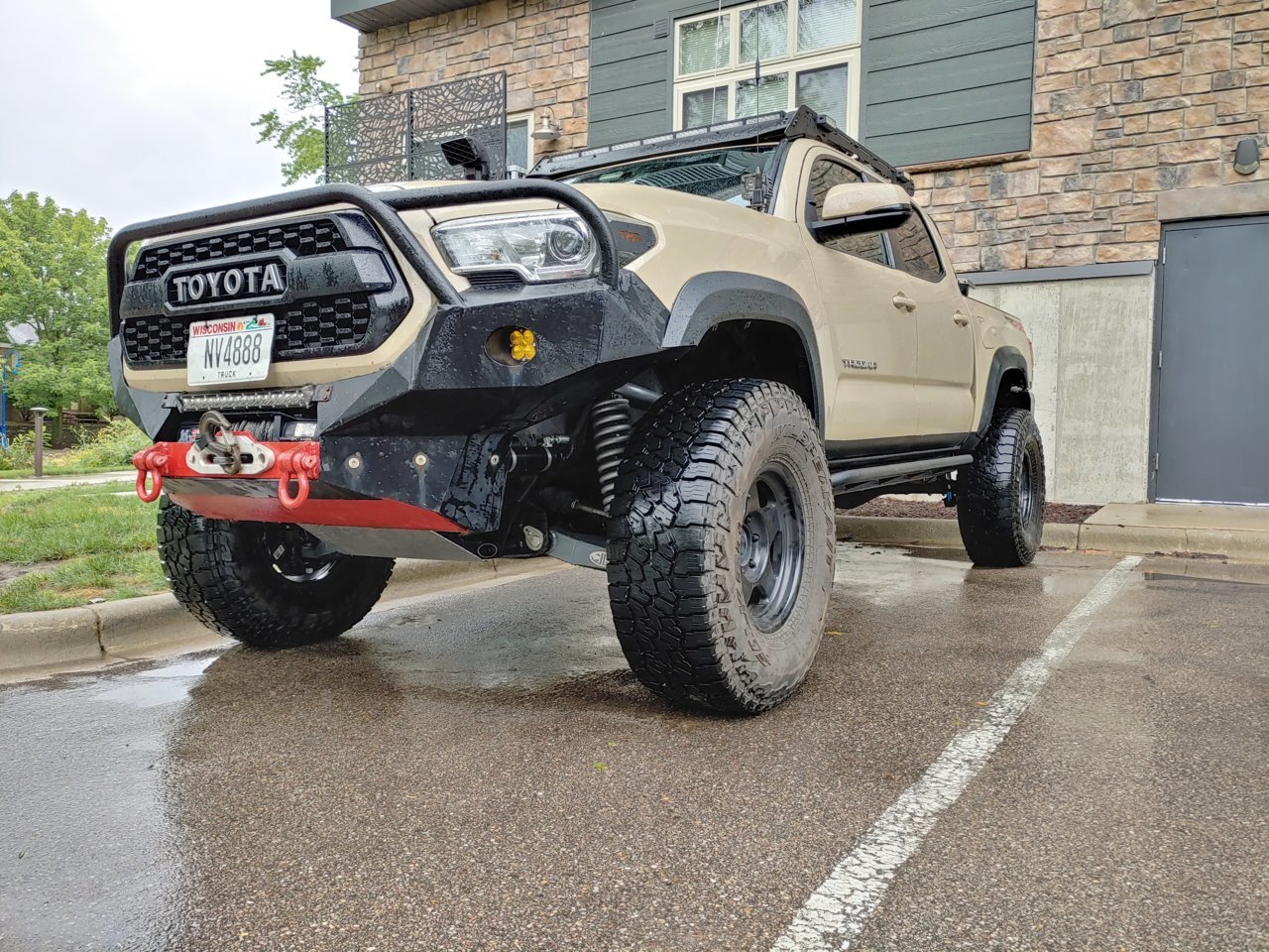

    Man I really like that bumper! Do they have a website or anything? I couldn’t find any info.

    They do not, but I can get you in touch with the shop if you'd like. They're starting to get active on facebook and instagram though, should be the same name -- Eli's Offroad.
    I'm pretty happy with it -- they worked with me with the design and everything.

    Curious why you decided to wire everything to your starter battery? I'm about install the same setup and just planned to wire everything to Aux battery, but I'm still learning and was curious about rationale here. Thanks! Everything looks great!
  18. Apr 20, 2018 at 6:11 PM
    #18
    BEAR_KNIFE_FIGHT
    May 21, 2016
    #187524
    2,603
    Alex
    Minnesota
    Hey man! I wired everything to the house battery because I wanted to keep the aux as a back up. I know most people with aux stuff to the aux battery but I don't have a ton of high-draw stuff so I figured I was safe. If I get a fridge or something with more draw, I'll probably wired that off the aux battery. I'm working on a solar charger system for the aux battery as well, which should help with power draw.
