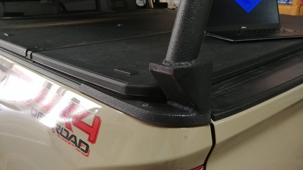

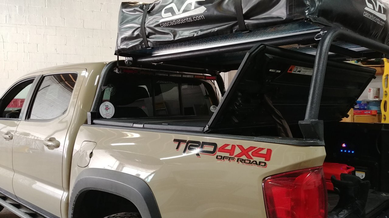

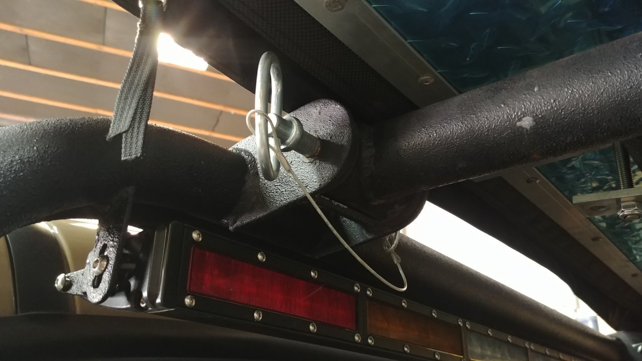

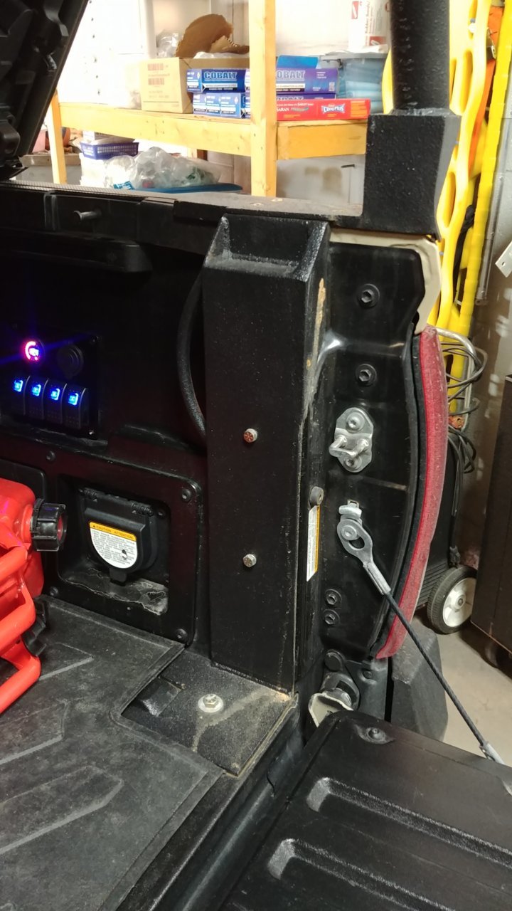

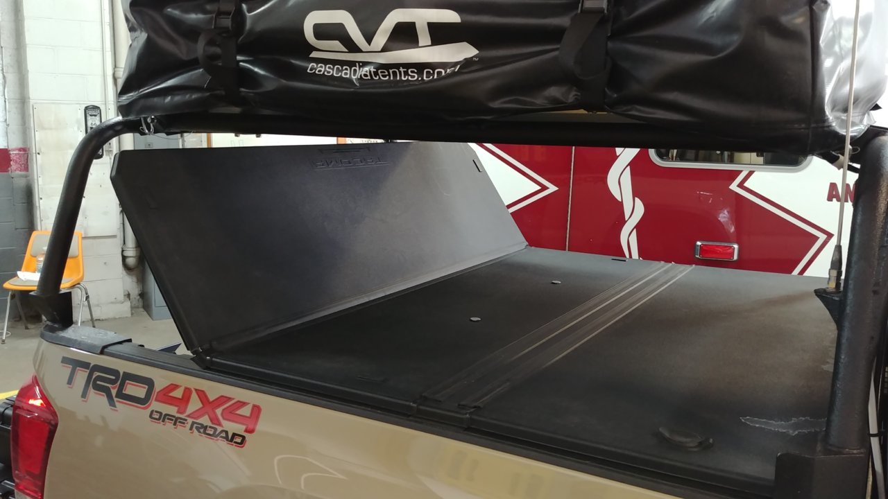

    The RTT carrier is fairly unique in that we built it to work with the factory tonneau cover, while still being somewhat low-profile. For that to work, we decided to build a system that hinged, at both the front and back of the bed. This allows it to be angled up to facilitate tonneau cover flipping, as well as total removal of the RTT and rear hoop when necessary. To make this even easier, the hoops and RTT carrier are attached with trailer hitch pins, so flipping the carrier up is as easy as pulling 2 pins and lifting. The rear hoop attaches to a set of bed stabilizers, and the front hoop bolts through the bed into the frame near the wheelwell. This allows the rack to be strong while not sitting on the top of the bedsides nor using the bed rails at all.
    Also pictured here is the in-bed switch with voltmeter. This monitors the house battery, has 2 USB charging ports, and 4 switches to control the water pump, RTT power, bedlights, and camp lights.

    The mount is the factory mount that came with the light, but welded to the front hoop and bedlinered.
    All of the metal on my truck is bedlinered for ease -- I'd love to powdercoat it but it all gets pretty beat up and redoing the bedliner is much easier than redoing the powdercoating. Potentially in the future I'll pull it all apart and powdercoat it, but I don't know if I see a huge need for it yet.
