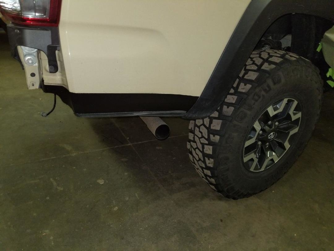

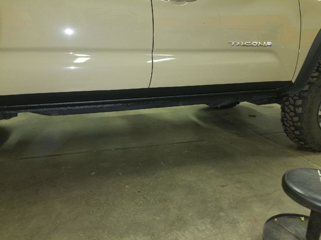

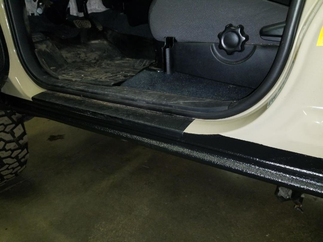

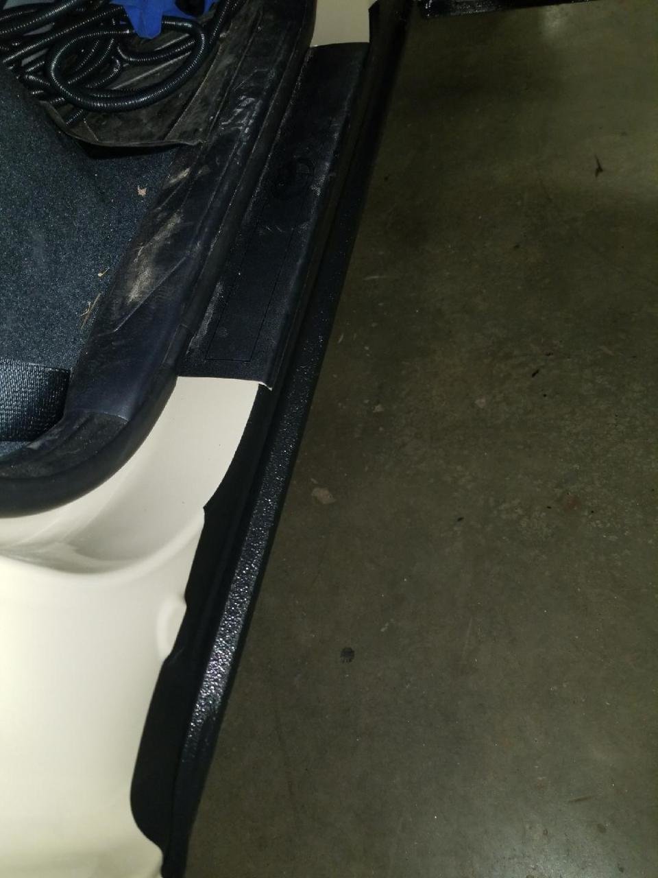

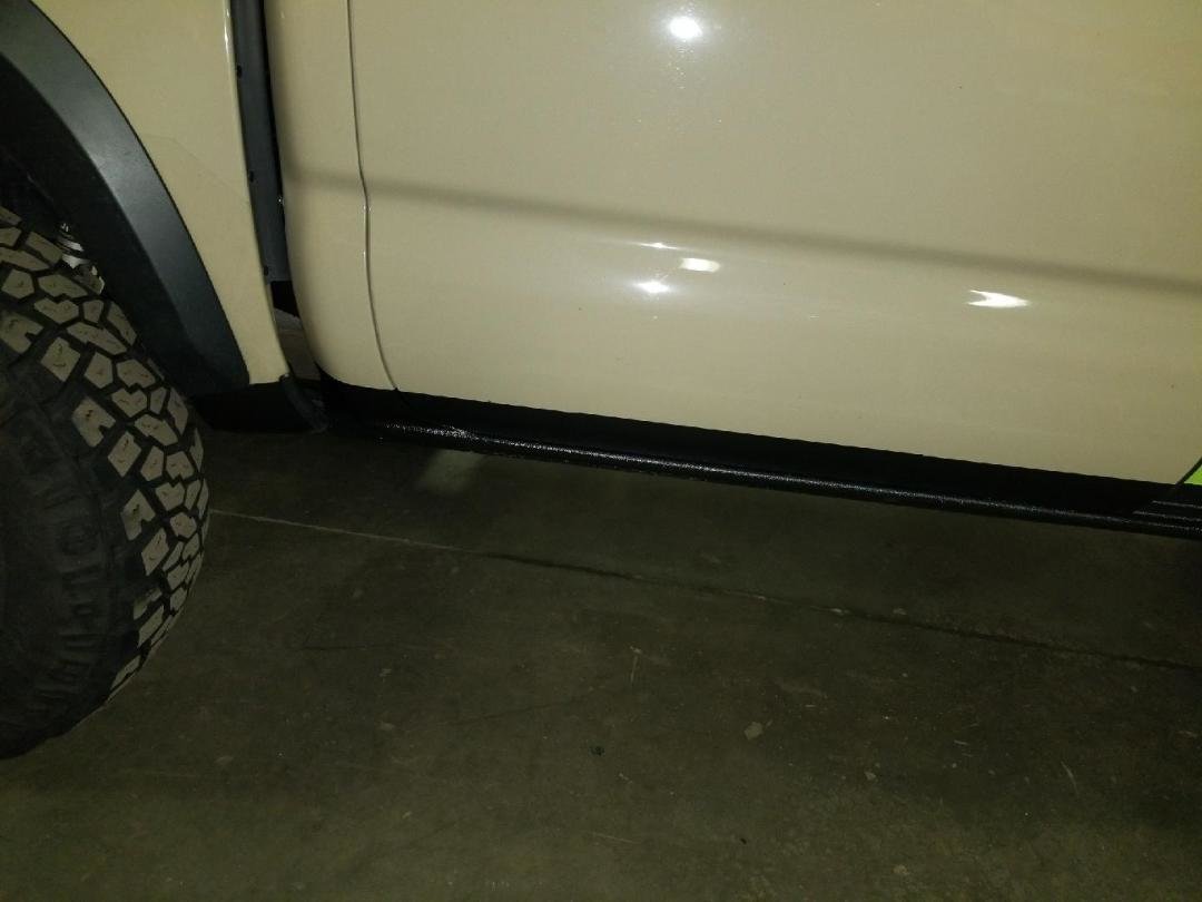

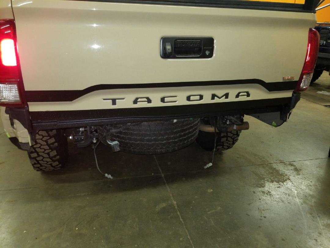

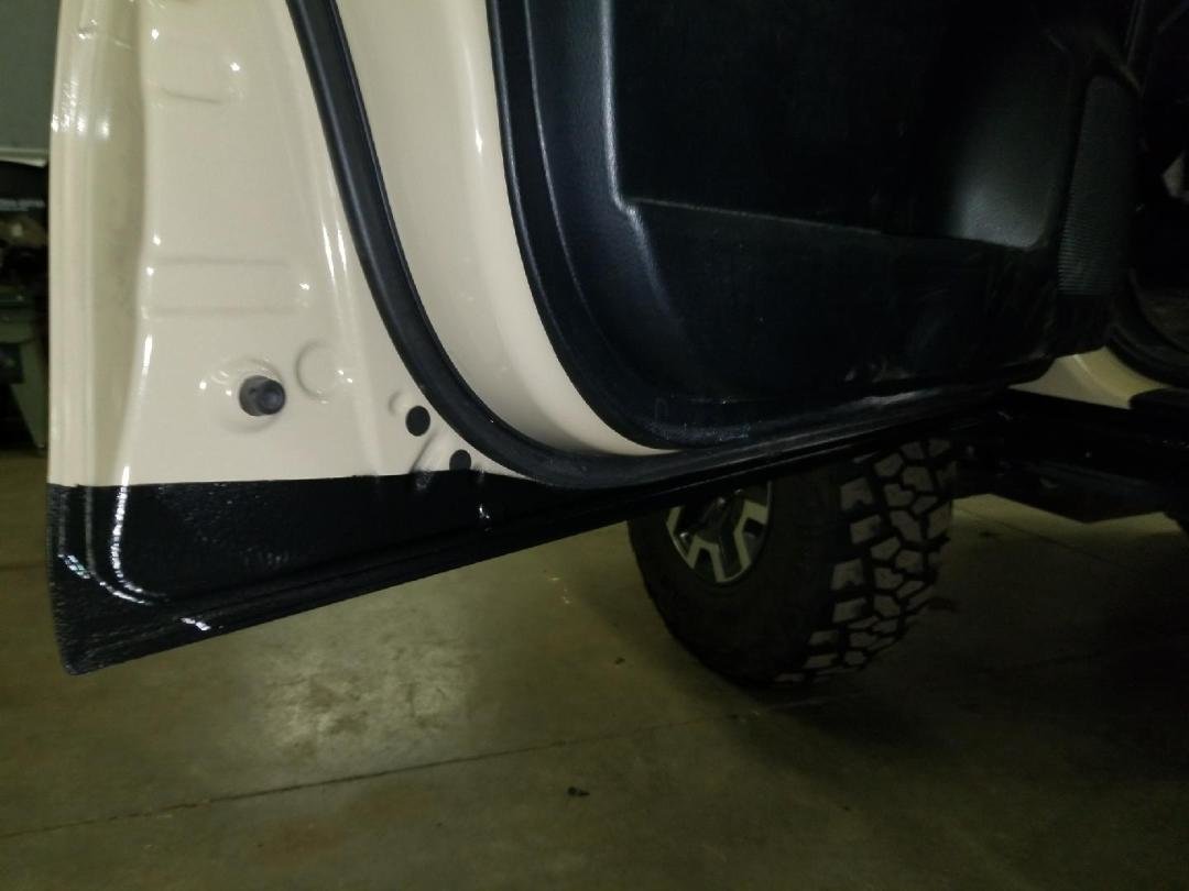

    Can you share some pictures of this: Bedliner on lower tailgate, door sills, and pinch weld
    Have been thinking of doing something similar, and would love to see what it looks like before pulling the trigger.

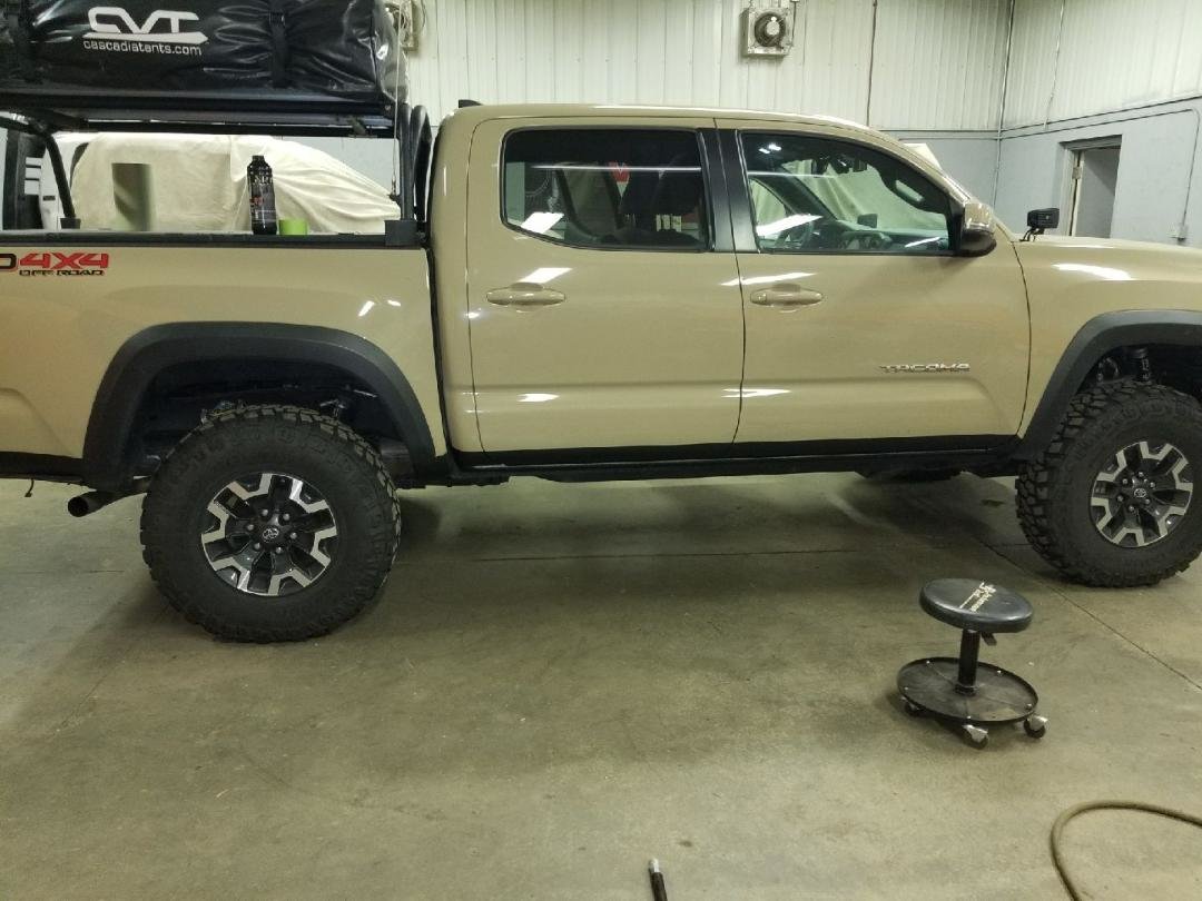

    For sure, here are some pictures from the shop when it was first put on [last winter]. It's held up very nicely. The stuff on the tailgate is honestly to cover up the damage/scuffed paint from my tailgate hitting the bumper. I can get more specific pictures if you'd like -- right now the truck is covered in dirt and mud so I'll have to go clean it up.

    Thanks. I like the look...may need to try it myself.

    Thanks, I think it looks pretty good. It was good to seal up that pinch weld, and I think it makes a nice contrast with the rest of the truck. My sliders and bumper are bedlined to match.

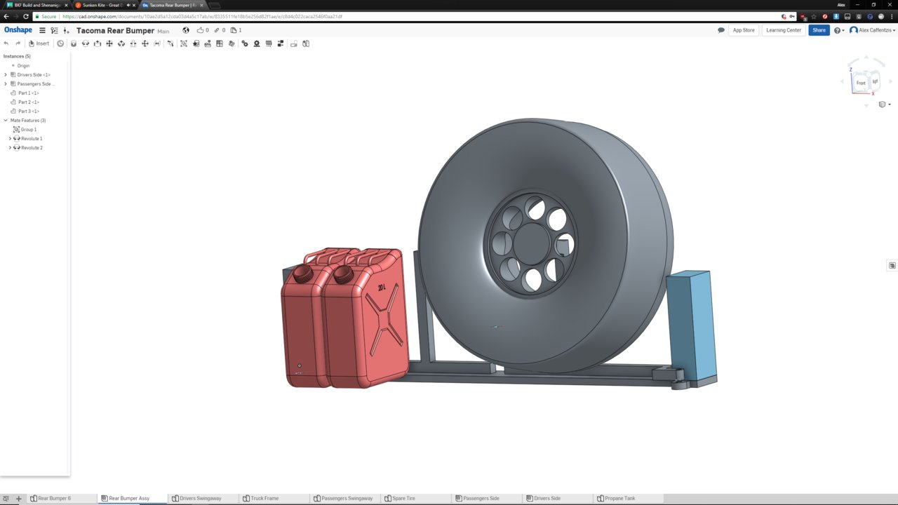

  6. Jul 21, 2018 at 6:48 AM
    #46
    BEAR_KNIFE_FIGHT
    BEAR_KNIFE_FIGHT [OP] bearly famous
    May 21, 2016
    #187524
    2,628
    Alex
    Minnesota
    2016 TRD OR 4X4 DCSB Slowsand, 2017 WRX WRB

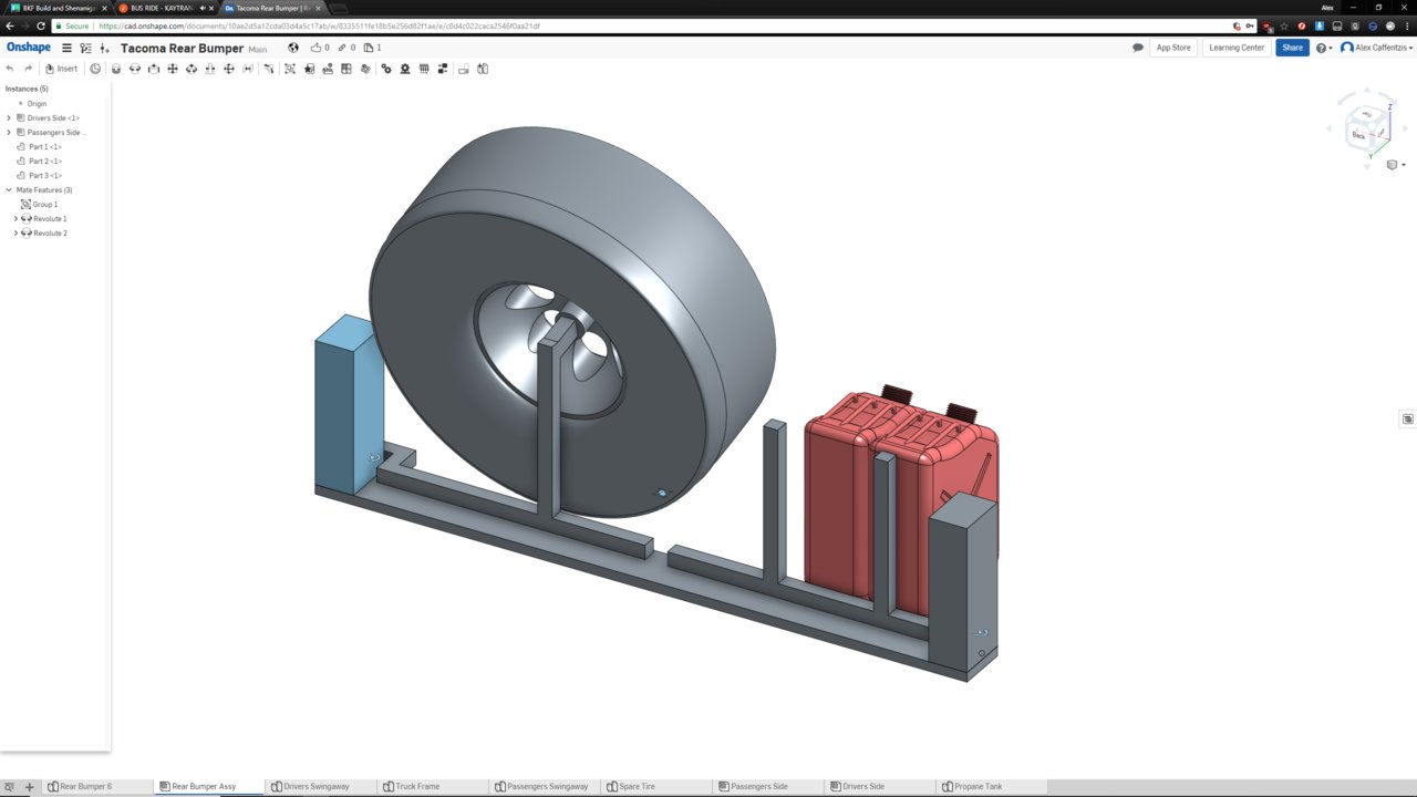

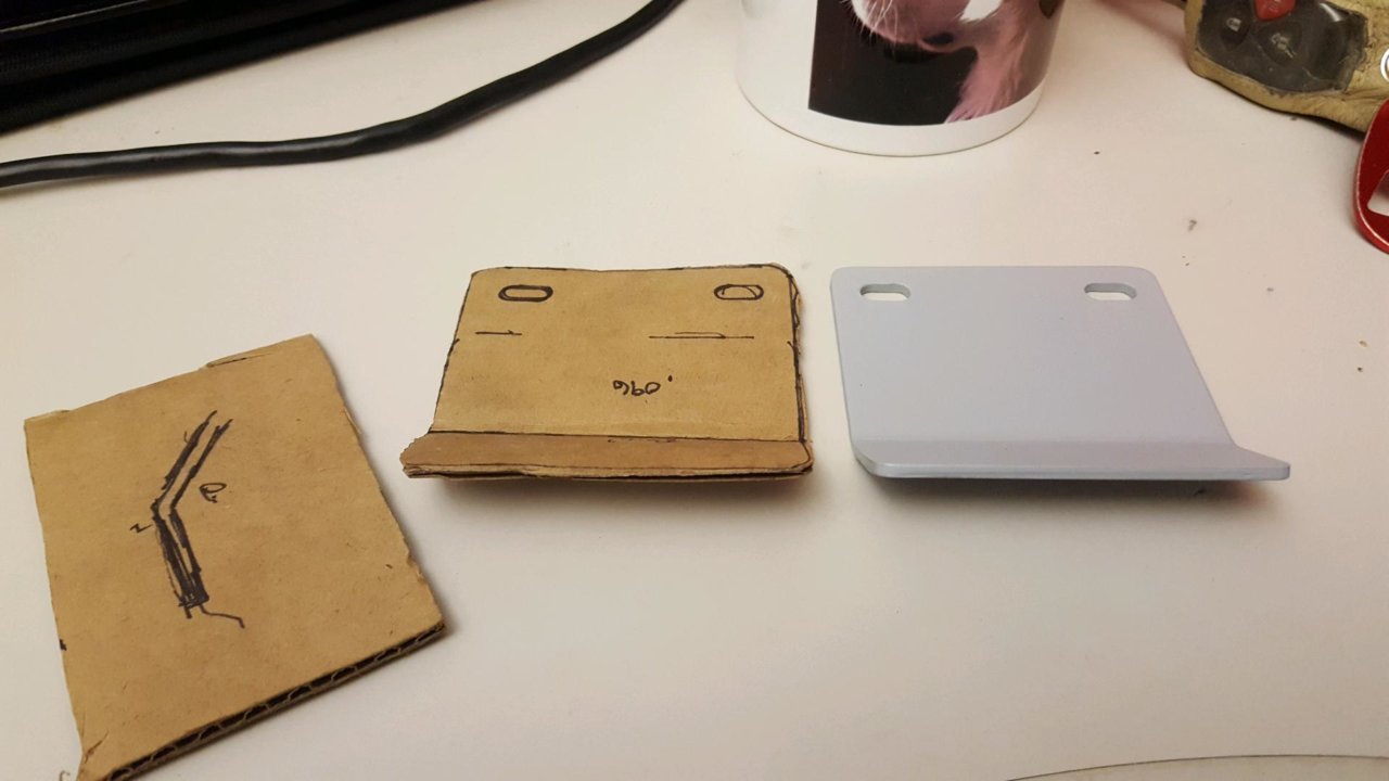

    I started working on transferring my hand drawings into CAD so I could more accurately design the rear bumper. This is by no means a finished product, just a start and way for me to begin seeing how things fit.
    I really don't love the look of so much stuff hanging off the back with a huge gap between the tailgate and the swingaways, so I'm designing them to cut back in towards the tailgate to stay nice and tight. I will continue to update this thread with pictures as I keep modeling it. I also really like how the Relentless Fab high clearance rear flows with the body lines in the back, and I want to try something similar with mine.
    Let me know what you guys think!

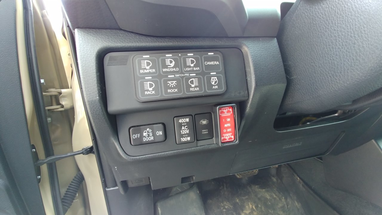

    Hey @BEAR_KNIFE_FIGHT im going to be installing oge dual battery system and wanted to see where you mounted the red switch inside the cab. You have any pics?
  9. Nov 11, 2018 at 3:27 PM
    #49
    BEAR_KNIFE_FIGHT
    May 21, 2016
    #187524
    2,628
    Alex
    Minnesota
    yeah, let me get some pics for ya.
    I had to dremel that switch opening a decent amount to get it to fit, but it's nicely snuggled in there otherwise. I am satisfied with it, at least.

    Thank you sir. Yea I’m trying to figure out where to put that big bad boy. Maybe meso 7 switch under ac controls or over head towards crawl controls. :redxfall:

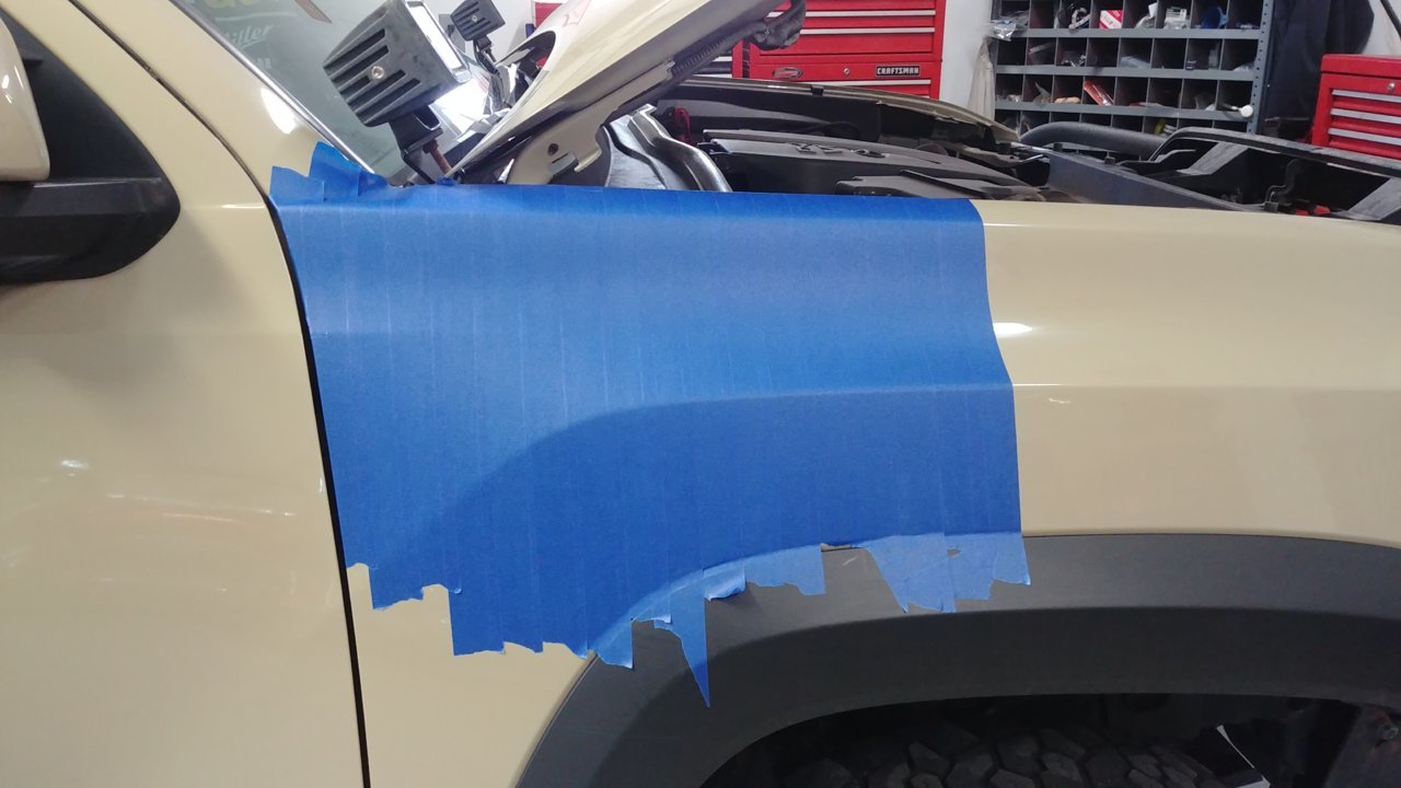

    Alrighty gentlemen [and ladies],
    Join me for a fender-cutting, paint-dripping, low-quality chinesium plastique adventure!

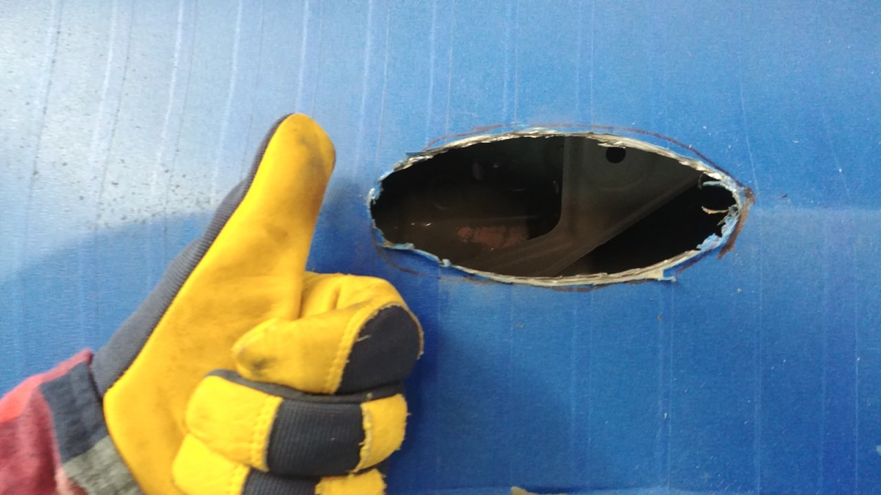

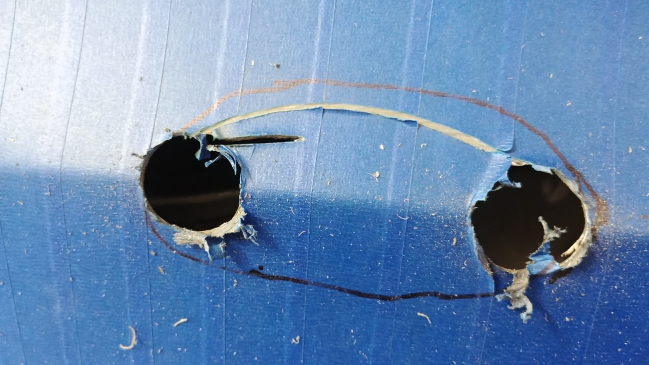

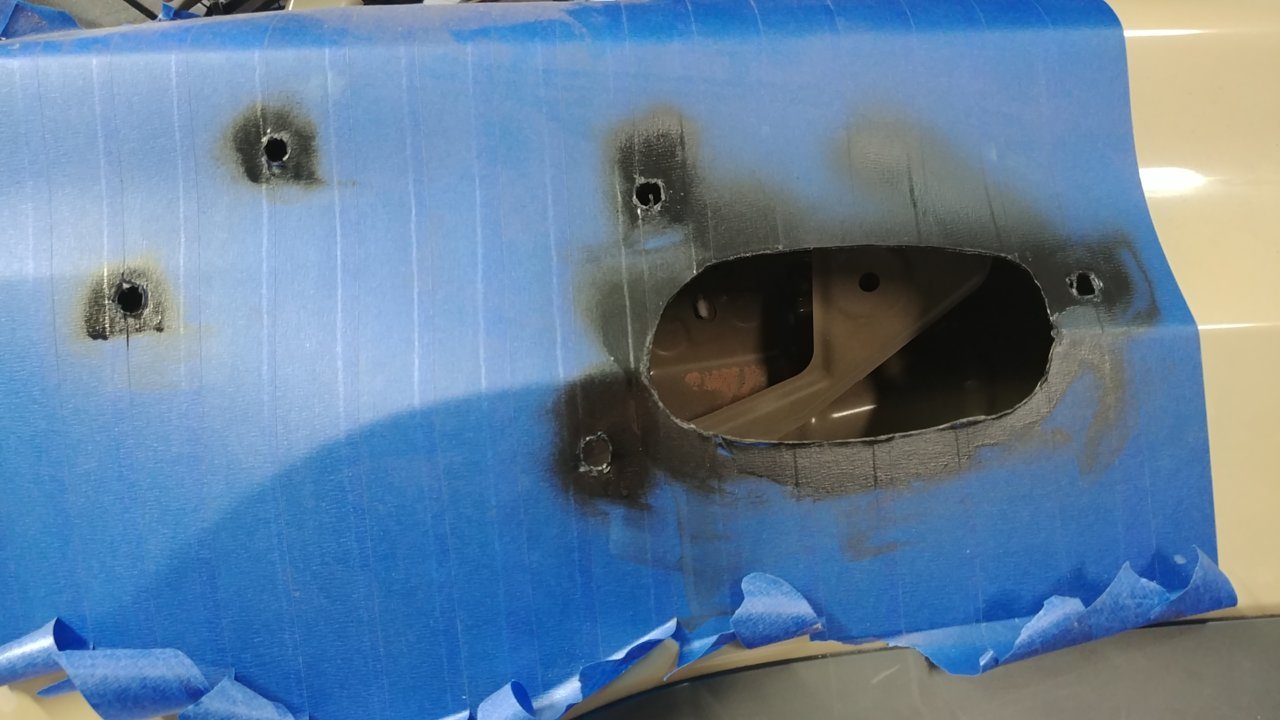

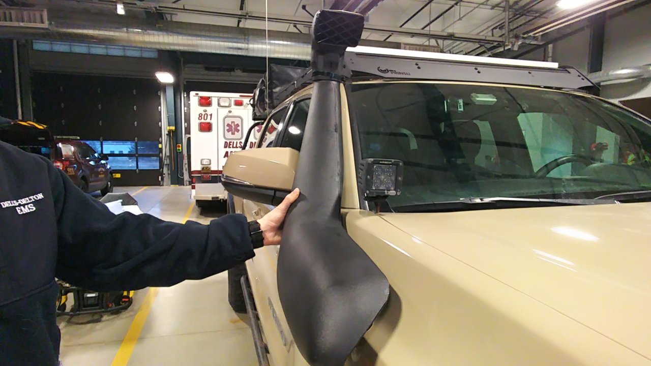

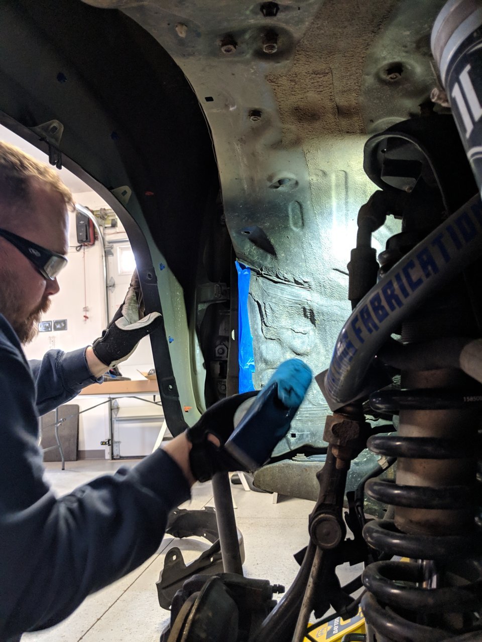

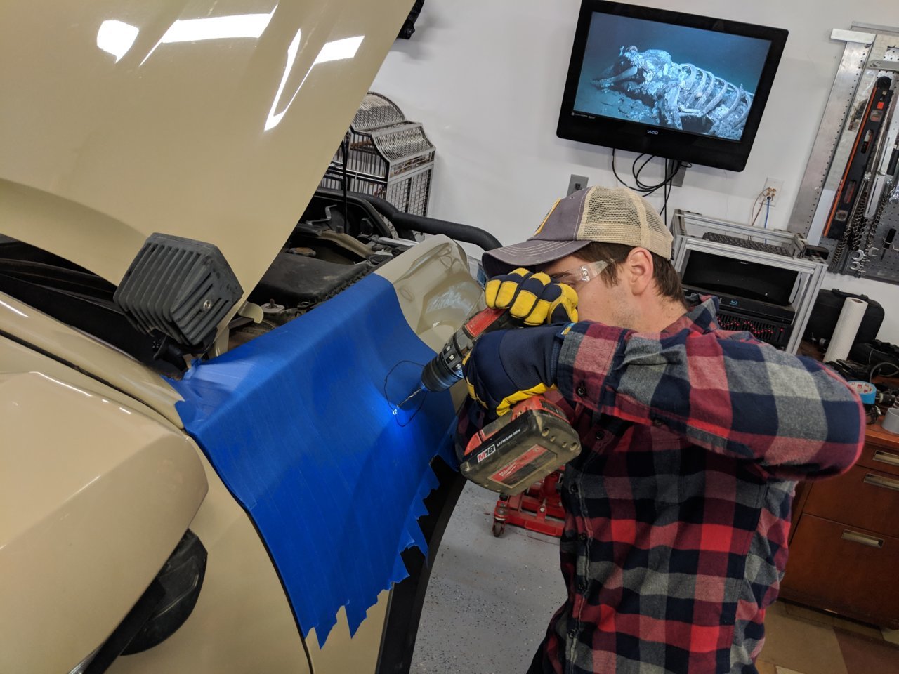

    Yesterday, @ajmogen and I attempted [and mostly successfully] to install my Prado 150 ebay dorkel. We found a few issues but everything worked out well for the most part -- it's pretty straightforward all things considered.
    Step 1: hold snork up and admire your #broverlander status in the garage. Return snork to bed of truck for 150 miles of highway travel to, "break it in"
    Step 2: apply painters tape to fender area to mark the cutting area [optional step 2.5, trash the shitty inaccurate directions included]. Remove your fender liners at this point if they're not already trashed.
    Step 3:
    Mark your aperture and drill, baby, drill. Step drill recommended.
    Step 4 -- unrelated but important -- take out your frustration with the shitty directions on your pinch weld. Beat that bastard back for better clearance.
    Step 5: Embiggen the hole. Cut-off wheel recommended. Big air tank recommendeder.
    Step 6: admire your orifice.
    Step 7: Mark and drill the remaining holes in your fender. Eyeball most measurements and step-bit + fender warsher to fit. Chooch those bastards up real nice and snug with some lock-tight as well.
    Step 8: Find out that the snork fits just a but further away from the A-pillar than the Prado thought. Fab up an extendo-bracket to 3M to your A-pillar.
    Step 9: Admire your new snork. I will update this with a real picture of the damn thing on because I totally forgot.
    Let me know if you have any questions.
