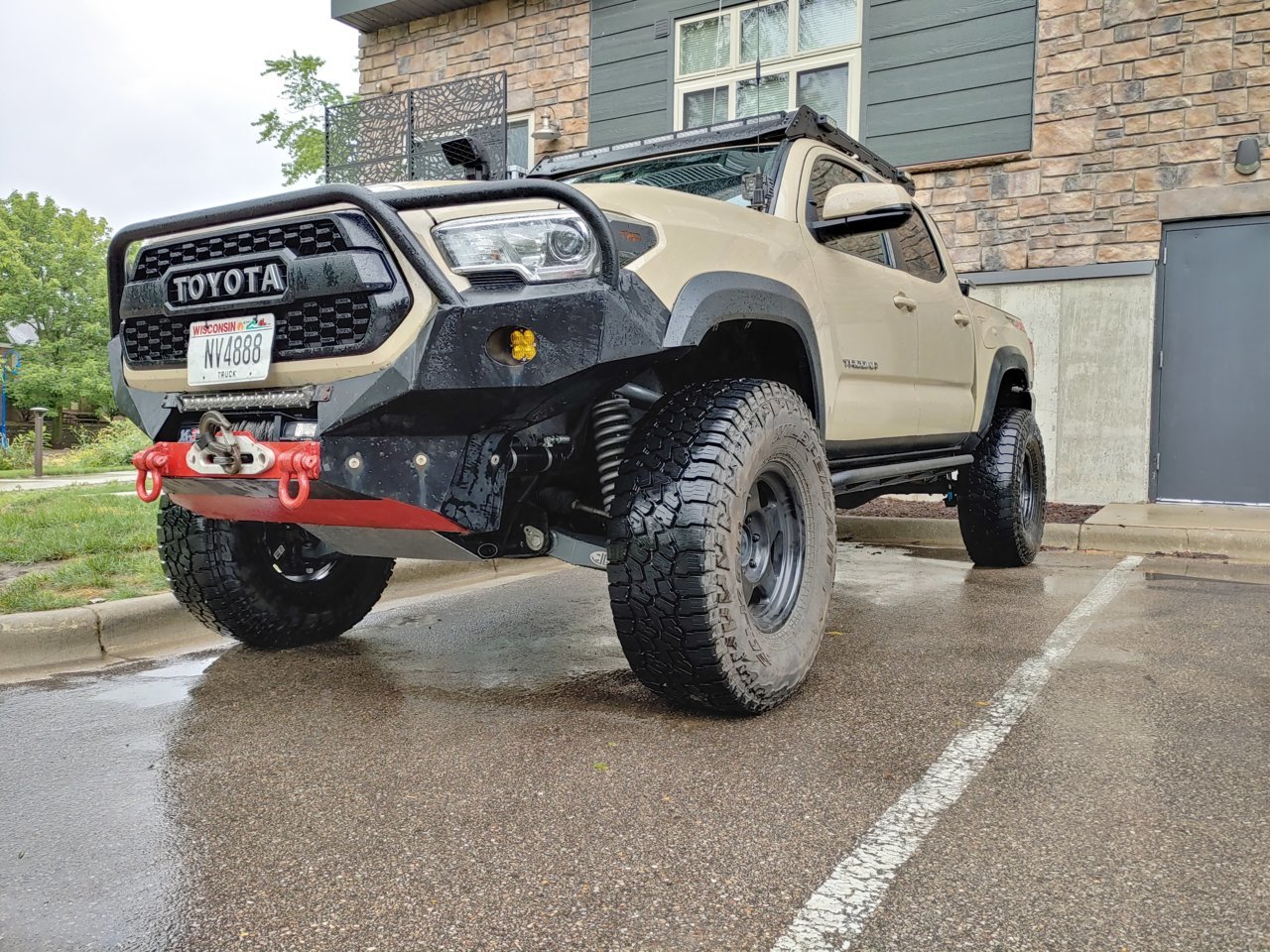

    Thanks! I'll update some more this week with the new suspension setup. Just been waiting to get everything together and get some pictures.

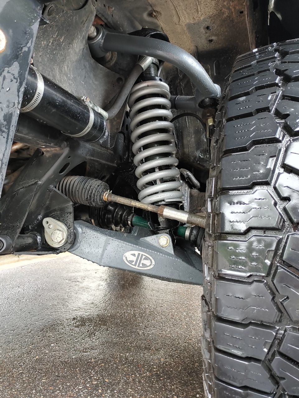

    JDF 2.25" with Locked 2.5x8 dual-speed adjusters on!

    I'll grab a few more shots and some flexing pictures tomorrow.

    Finally! Of course I need to fix some things yet (different rod ends for the coilovers) but otherwise it's all good!

    It's been a while since I updated anything on here -- nothing super exciting has happened with the truck. I'm saving up to swap my bumpers to Coastal Offroads High-clearance front and rear and trying to decide if I want to go with steel or aluminum. The steel would be nice for the ease of construction [Coastal ships their bumpers unassembled and require welding], but the aluminum would be nice for the added lightness.

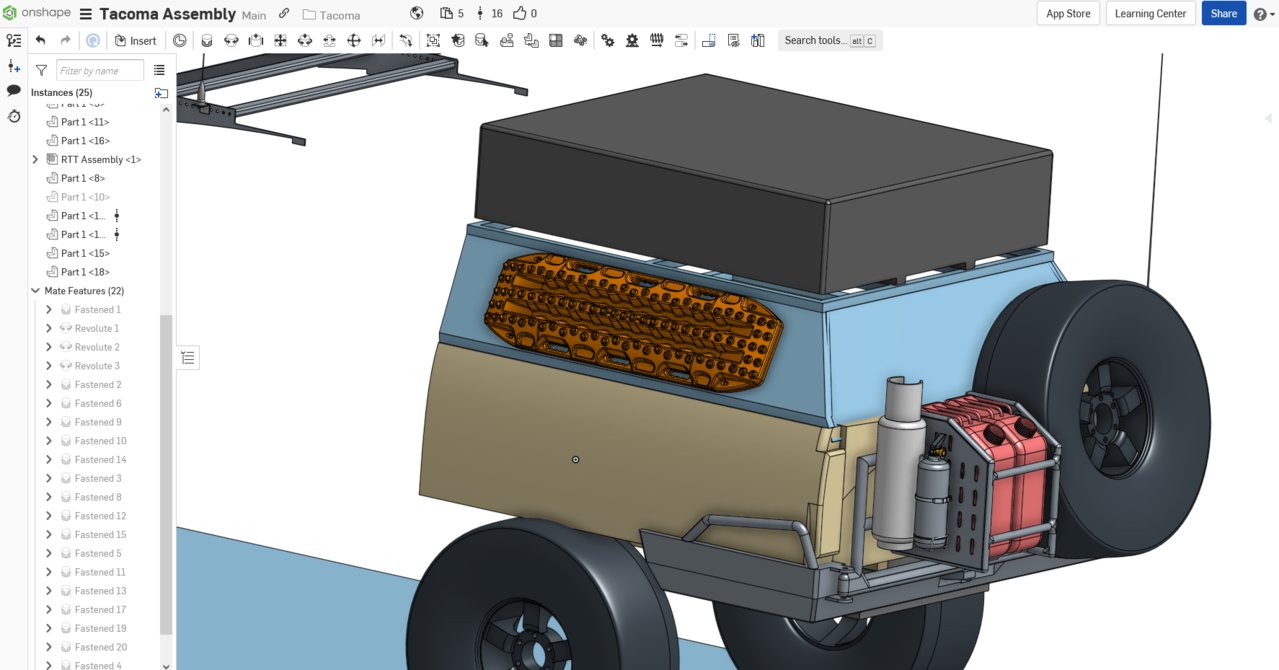

    I'm also finishing up some drawings to change my RTT carrier for something a bit lower so I can park in the garage with my RTT attached. I'm planning on building a half-height topper that allows me to run the RTT at just a bit over cabrack height, or take it off for commuting. CVT makes a cover for the tents that doesn't have the hump for the ladder, which is great as it removes about 4" of height. I'll just keep the ladder in the bed and attach it with quick-release pins when we've got the tent up.

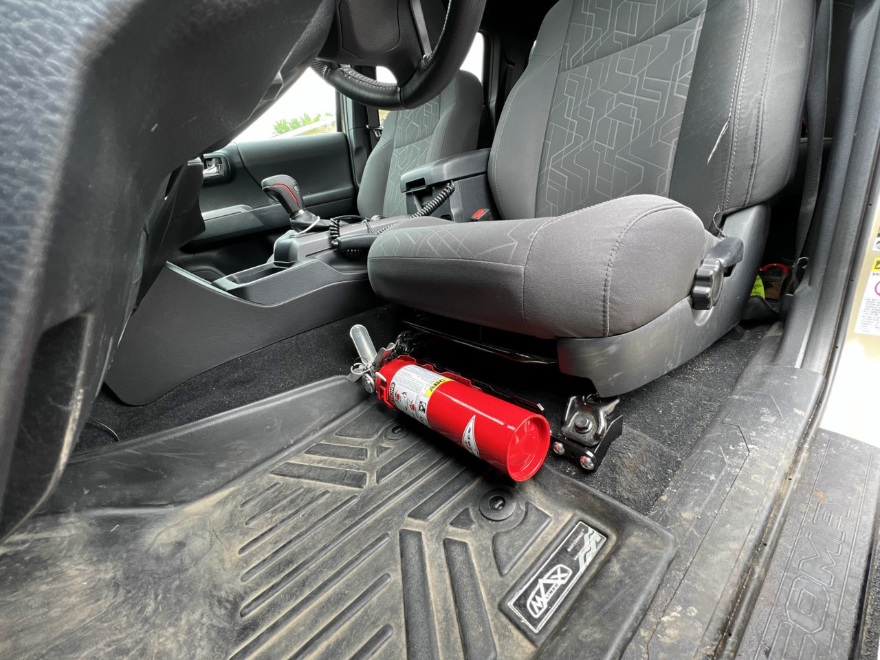

    I added a DDI fire extinguisher mount in the cab -- I like the way the front seat is a bit higher and supports the back of my hamstrings during longer drives.

    Glad to see I'm not the only one who models up their Tacoma and everything on it. Makes laying it out and getting your setup dialed so much easier and precise. :thumbsup: Looking good. For what its worth, I originally ordered a steel rear swingout from Coastal, but after receiving it and really thinking about it and looking at it.. as much as I liked the simplicity and the cost due to it.. it was just a little too basic for me. Now having the BAMF rear.. with the fold down tables, position lock pins, and some other little features, I'm glad I spent the extra. The Coastals are still very nice bumpers though.. I just wanted the features for our camping needs.

    Yeah, I go back and forth on that part. I like the simplicity of the Coastals but not all of it -- I prefer the position lock pins myself, and I'd probably swap their system out for those. It would be nice to have the swingouts a bit more removeable like the ones I have now are.
    I think a lot of that part will depend on if I get myself a welder here. If I do, all bets are off because now I can modify the swingouts to be exactly what I'd like.

    That was my plan as well.. add tables, modify what needed to be modified. But there just wasnt enough room for adding the things I wanted. They keep everything nice and tucked close.. which I like and can appreciate, but wouldnt allow me to add what I wanted. The BAMF swingouts are easily removeable and its symmetrical so you can swap everything from side to side. Just sharing the comparisons I found along the way.

    Definitely! I really like those BAMF ones because they're super modular as well. I wonder if they'd sell me just the swing out parts...

    hmmm.. maybe. but the other half of the pivot assembly is already in the bumper side. I just had to mount the swing arms and install hardware through the pivots.
