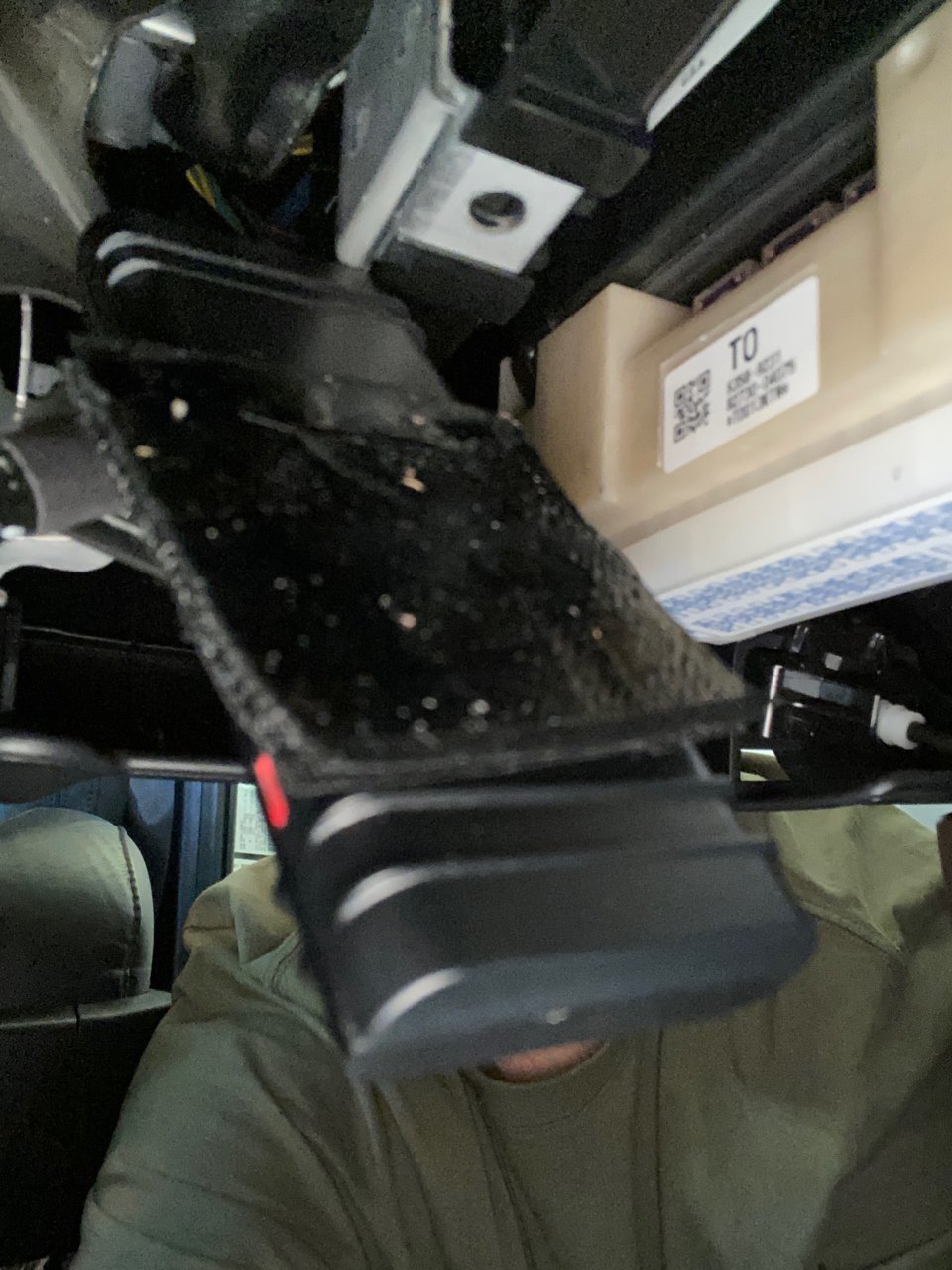

    Greetings,
    Today I was swapping out the floor mats in my new-to-me 2020 OR (my 1st Taco), and found this slim box with red & green lights hanging under the steering wheel. No visible markings (maybe under the velcro) and I pulled it out as far as I could (not much slack). Ideas? Concerns?
    Apologies as I know something similar has been asked previously but what I came across wasn't on point. If I've missed a relevant thread, please kindly point me that way.

    Dealer installed tracker. It is cheaper for them to buy them in bulk and install on every vehicle rather than pay to have a vehicle hunted down when the buyer stops paying.
    Pull the Velcro off to see what's under it. You'll probably find a sticker with model number and other info.

    Yep, I'm going to guess @jjsooner or the first N owners has/had a loan and the dealer/financier required a tracker on the truck due to high liability.

    @windsor is right. Its a dealer installed tracking device. I found one of these on a car I bought from a dealer. It was connected to a piggy back connector on the OBD port. Took it out as soon as I found out what it was.

    I'm still poking around for a 'benevolent' reason for it to be there - like remote start (which works with the fob) and/or Toyota Connect. But its doubtful. The FCC id lookup pointed to GPS tracker.

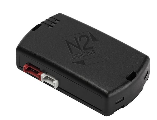

    I was thinking the exact same thing. It's been a few years since I installed mine. This is from their website, but I'm 50/50 on if mine looks like this or OP's.

    Dude... you hit the jackpot. Pretty sure that's the phone module for the N2 Designs remote start module. There are two parts. One module is the remote start, it's the photo in my post above. The module you're showing, is the cell phone module. I have one and pay ~$30/yr for remote start anywhere the truck has cellular signal.

    That's what it is but its a generic module. So it can be used for remote start or to track via gps.
