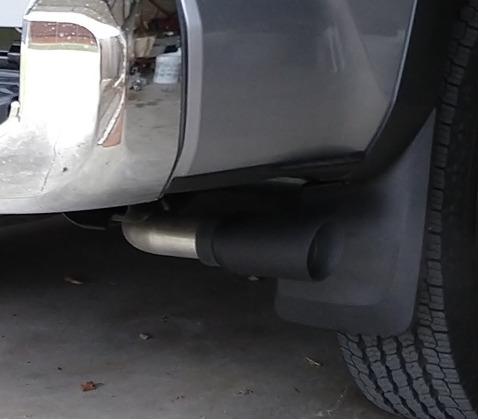

    Thanks for the reply guys. I feel confident in the purchase.

    how'd you guys get the stock chrome tip off?! i tried twisting and turning to no avail. only got it about 2" down the pipe before i got stopped by something.

    make sure the bolt is all the way off or really lose. Also try spraying it down with WD40 or similar to help free up

    Cutting it off is better

    There is a two piece washer that’s stubborn, a lot of penetrating oil and tapping with a hammer.

    Completely remove the clamp. Then there is a split 2 piece cast aluminum collet that you'll need to remove from the back side of the exhaust tip. A little penetrating oil will help in loosening it up. Once that is loose the tip will slip right off.
    Here's a short video that shows how it goes together. Not the greatest video, but the info is there. :anonymous:
