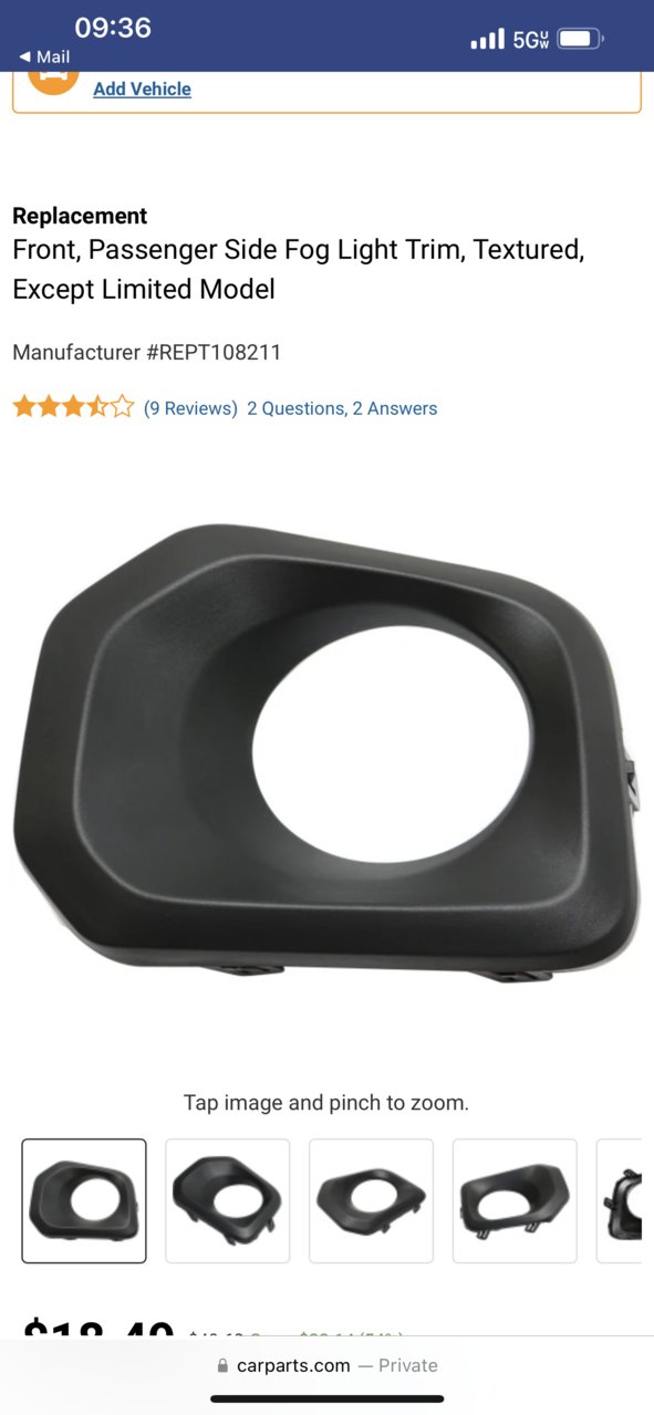

    I am in the process of getting rid of all the chrome on my limited. I am struggling to find a black fog light to replace the chrome ones currently on. I’ve ordered a new fog light but it was the wrong one (black but had an open bezel). All the parts I’m seeing are for all other models except a limited.
    Does anyone have a link for a black fog light to fit on a 2023 limited ?

    I thought the same but was wrong on 2 different occasions. If you could provide a link that would be great. All I am seeing excludes the limited. See attached

    Because the limited is chrome not black :notsure:

    That’s why I posted to see if there is a black one instead of chrome one. From what you are saying, it does not exist. Thanks

    What he is saying is that limited has chrome, every other truck has black. If your looking at black ones it will say "except limited" because the limited is chrome.
    They are all the same though and all mount the same. Just get some black ones from any other 2016+ tacoma and they will fit right on your truck.

    You can use the black ones you posted. It says it doesn't fit the limited because it doesn't have the chrome ring on it, which is what you are looking to get rid of right?

    Yes, Sir. I’ll try to get some on eBay. Seems to be the cheapest. The only thing I am weary about is when I place the make model for the product, it states it doesn’t fit. But I’ll try again. thanks

    Dont select limited as your model (select offroad or sport), it will tell you they dont work because they are not chrome. But they do infact fit perfectly.

    I purchased these part numbers for my 23 Limited. They replace the chrome with a black plastic piece on the fog lights.
    52125-04040
    52126-04040

    WOW, talk about price increase, When I purchased mine, 9/24/21, they were $24.07 per trim piece. Now the same dealer I purchased them from the cost is $31.29...

    I paid $37 for both trim pieces from eBay. Both fit perfectly
