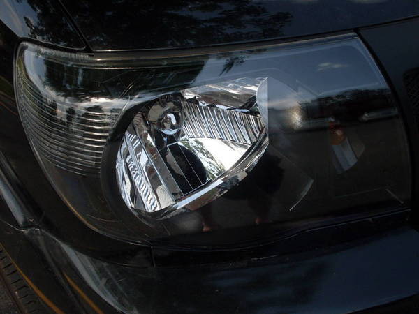

    With my oven the whole preheat then turn it off thing didnt work to well.... Instead i put it on 250 and left it then put in the headlights, one took 6 minutes the other was like 7 or 8 i think....
    Wear some gloves and when you take them out start at the bottom inside part of the light. (the part by the blinker) And then just start pulling them apart, if it doesnt come apart super easy then put them back in for a minute or two at a time to soften up the adhesive inside it....

    Start to finish from when i pulled out the headlights, baked them, lightly sanded, cleaned, painted, dried and put back together was around 3 hours.... Leave yourself plenty of time to do it that way you dont have to rush...

    Just lightly sand it to roughen it up so the paint wont run and drip as easily, i used Krylon fusion satin black heres the pair on my black truck

    DAMN! that looks amazing, you painted everything black? even the corner lights? and just didnt put a turn signal reflector back in? got a shot of the front? i was thinking about not putting the turn signal thing on too

    Yeah painted everything black no reflectors
