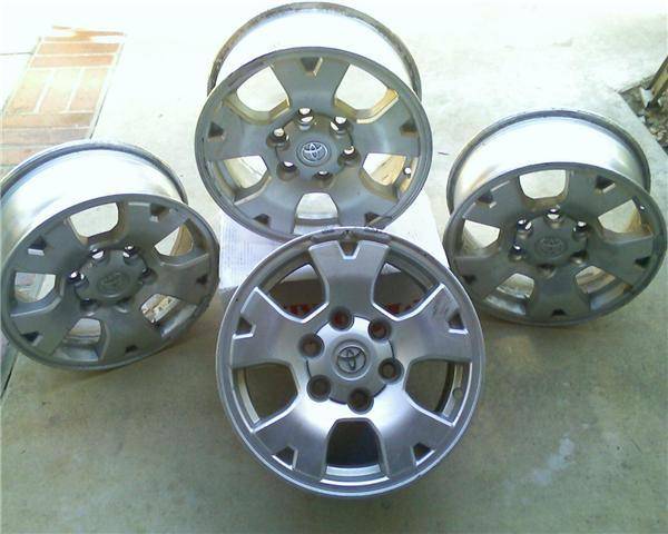

    This is true for most aftermarket wheels and the base model stock steel wheels.
    Stock TRD Off Road aluminum wheels like the ones below need straight-shank lugnuts. Gorilla makes a "clone" black chrome lugnut: http://www.sfxperformance.com/parts/GOR73137TBC.htm
