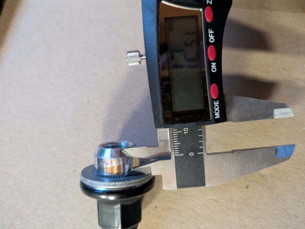

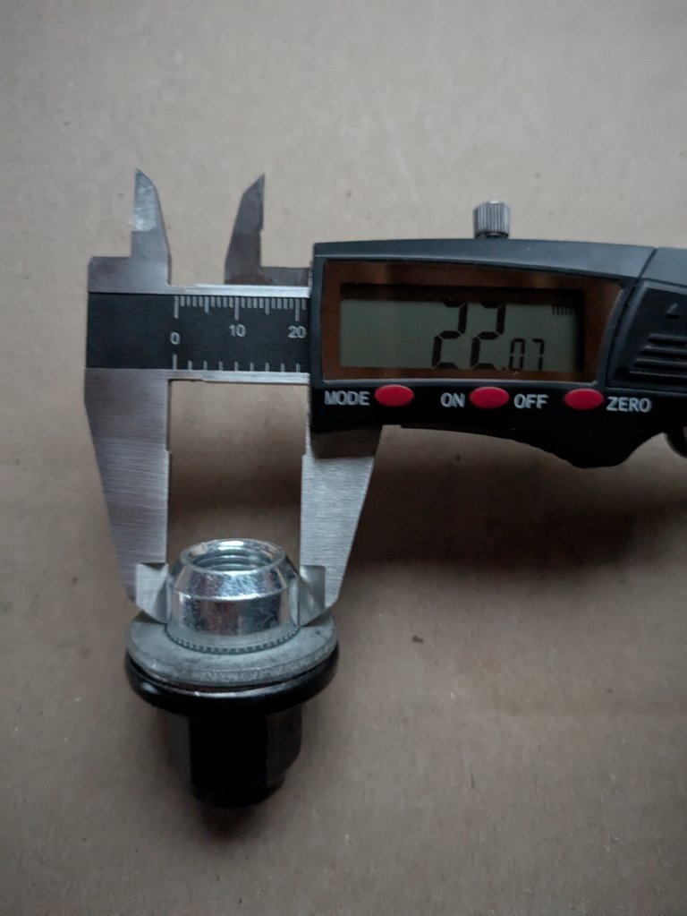

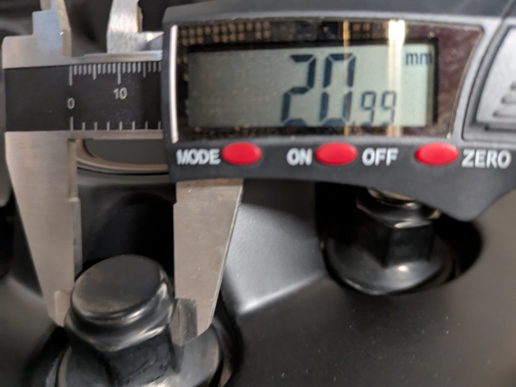

    I appreciate the help and sorry for the confusion. I should have included a picture to start with. The shank is the part that goes into the wheel hole. I'm used to calling what you measured thr spanner or wrench width. In the attached pic, I'm looking for the measurement that is .68 in the first image. My concern is that the lugs i was sent measure 21mm but the OEM i have on the truck measure 22mm. Doesn't sound like much but i can see it tearing up the holes in the wheels over time. Maybe being a bit too particular. Does that make sense?

    The shank is 21.85mm

    Here you go now that I know what you're hunting for. Plus a few others for good measure (I have spares from putting on the locks)

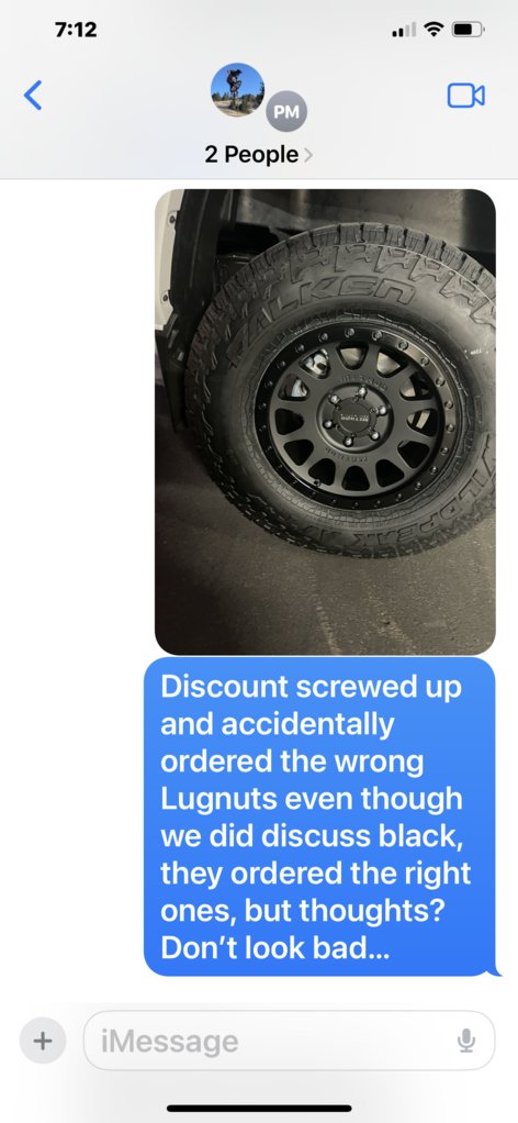

    I just got some black wheels on my taco...
    DT accidentally clicked the wrong selection & ordered me chrome nuts, no black..
    They put them on & made me aware they needed to order the correct black nuts & will call me when they come in...
    Reached out to a couple of my tire guys at work, that see tires everyday, & have multiple tricked-out rigs, mustangs, f150's FJ's, etc...
    Along with the owner of the offroad performance shop that did my lift...
    They all said keep the chrome nuts as black starts looking like shit in no-time from imaoct sockets, oxidation, etc...
    All gave me the same advice...

    I would say keep the chromes when the blacks come as part of your benefit for the error. Then you can make the call as time progresses, unless you like the look of course. Shops should be using appropriate sockets to minimize marring and damage when it's not a "regular" silver plated finish.

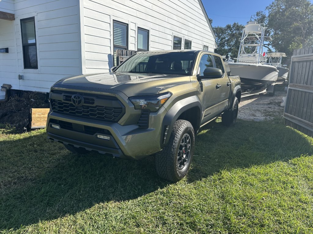

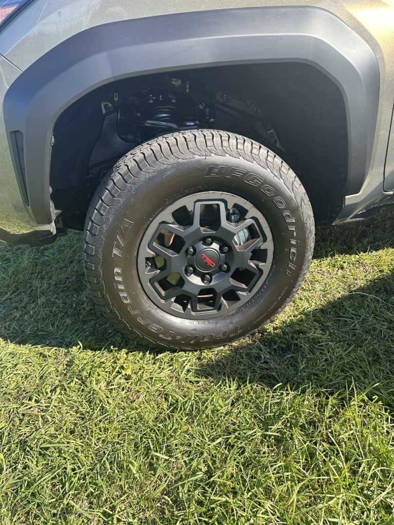

    I just took my stock ones off and spray painted them. They look great. Do 3 off each wheel at a time. You don’t even need to jack up the truck. I popped off the front emblem and hit it with the same black. Mine is the bronze color. It looks way better blacked out. I bought some precut vinyl stickers to black out the metal part on the wheels too.
