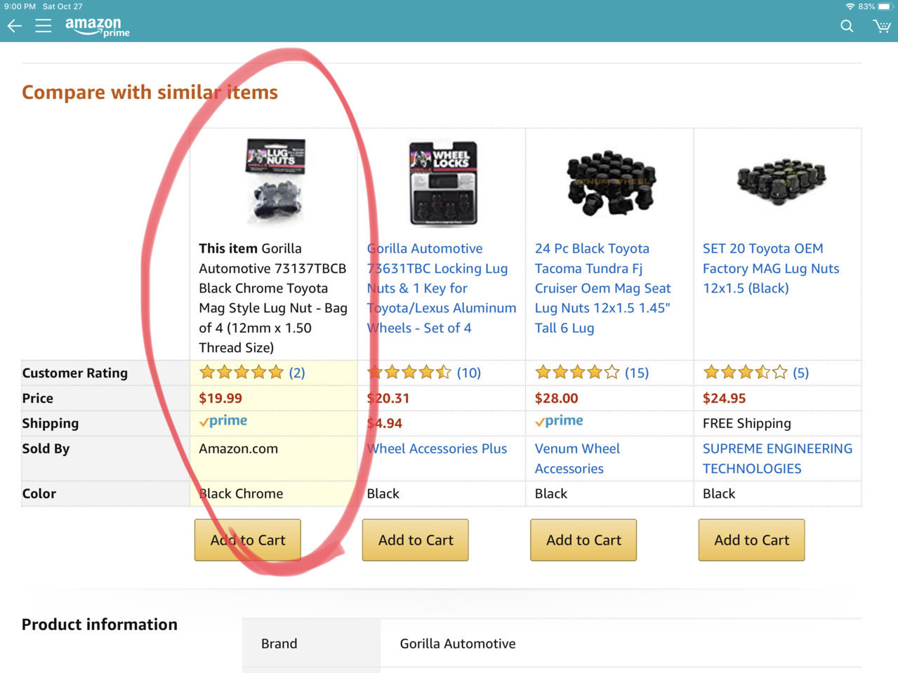

    Nice. Which lock nuts did you get? Do they match up? Any pics?

    This exact set. M12x1.5. Black chrome finish. 5 regular lugs, + 1 locking lug per wheel. Plus the key. McGard is the company that invented the original locking lug. These don’t corrode or break. You may need a low profile (thin wall) 13/16 socket depending on the wheel though. Ignore the bad reviews, they’re complaining about receiving the incorrect item. This is the highest quality set I could find.
    McGard 84658 Chrome/Black (M12 x 1.5 Thread Size) Cone Seat Wheel Installation Kit for 6-Lug Wheels https://www.amazon.com/dp/B00DIX1XAC/ref=cm_sw_r_cp_api_i_PGs1BbDKDACVC

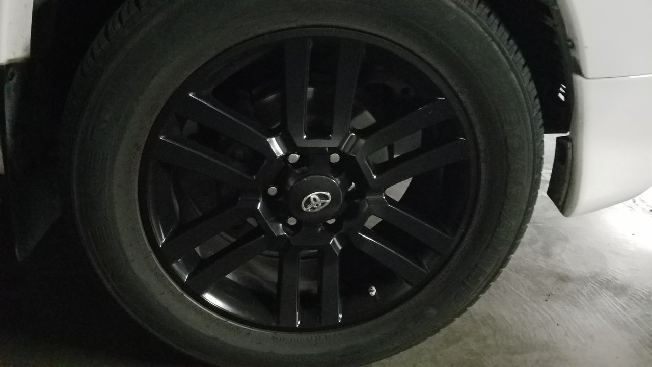

    A few
    I had black lugs on my powder coated limited rims and was too much black for me . Ended up putting stock ones back on. Just something to think about . Might look good on your rims . In the end all that matters is if you like it.
    Picked my black lug nuts up from vender here Wheelers Off Road .Think it was like $65 for 24 black chrome.
    Pic of all black

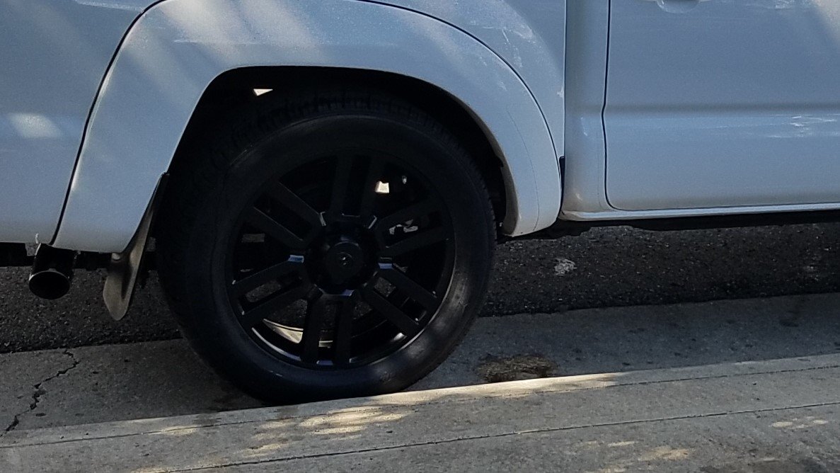

    Do you have a picture with the stock ones on?
  13. Oct 27, 2018 at 11:57 PM
    hemitruk
    hemitruk Old man , young boi truk
    Oct 17, 2009
    #24461
    2,302
    Kurt
    Hawaii
    2010 Dbl Cab Sport,
    A few
    Here you go .

    Just had those lugnuts delivered to my house. They don’t look anything like the stock lug nuts. Don’t we want “mag lug nut with washer” not “closed end bulge acorn”? The mag lug nut with washer looks more like the stock one. A portion of it actually goes down inside the rim as opposed to resting on top of the rim.

    I’ll be honest, I didn’t read your original post close enough to realize you were using OEM wheels. I have no experience with the black TRD rims from Toyota. I know that some replicas, and pretty much all aftermarket wheels require the acorn shape. But if your wheels are actual Toyota, they may utilize the same style lug nut as your stock wheels. I apologize if I steered you towards the wrong product.
