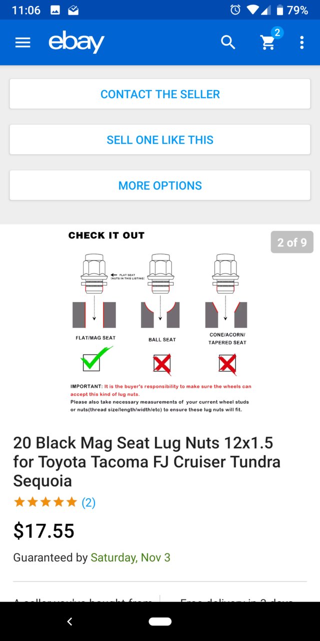

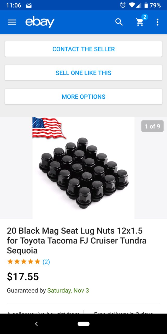

    eBay...bought these along with Gorilla locking lug nuts.
    Was able to buy the 29 pack because I also bought the 4 pack locks

    Just a word of caution, I bought the black set of lug nuts off Amazon for my TRD rims and that black powder coat lasts about one tire rotation before it starts chipping, exposing bare metal which leads to rust. It sticks out like a sore thumb. I would stick to the stock chrome lug nuts, they actually do not look bad at all on black rims.

    I have those on my truck, and they work fine. I wouldn't buy black ones again though because the black coating comes off where the socket contacts it and now they have rust spots on them.
    OEM chrome are what im going to replace them with though, but they are kinda pricey. Like 6-8$ a lug nut

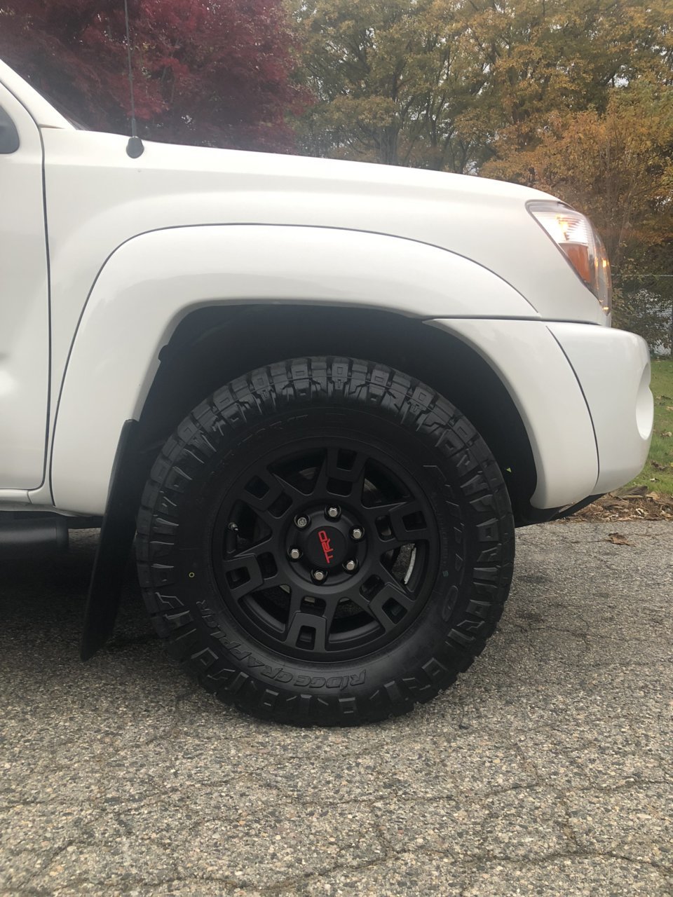

    I ended up putting the stock lug nuts back on. They fit perfect and look pretty good too. Check out my first official pic.0B118664-1249-4DCB-9E85-D1447311DA95.jpg

    Just got my TRD wheels.....was going to get the black lugs but given to problems described above....and seeing how the stock lugs look, that’s the way I will go. Thanks for the pic; looks great

    BTW....Nitto tires; what size; any problem w rubs?

    Nitto Ridge Grappler 265/70/17. Unfortunately, a slight rub on the front mudflaps in full turn only. Just bought a set of Rokblokz for oversized tires. I haven't installed them yet but they say the front flaps mount outside the wheelwell so no rubbing.
