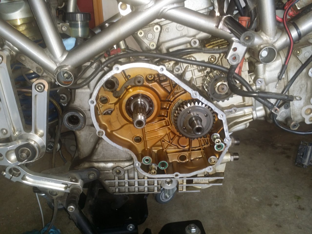

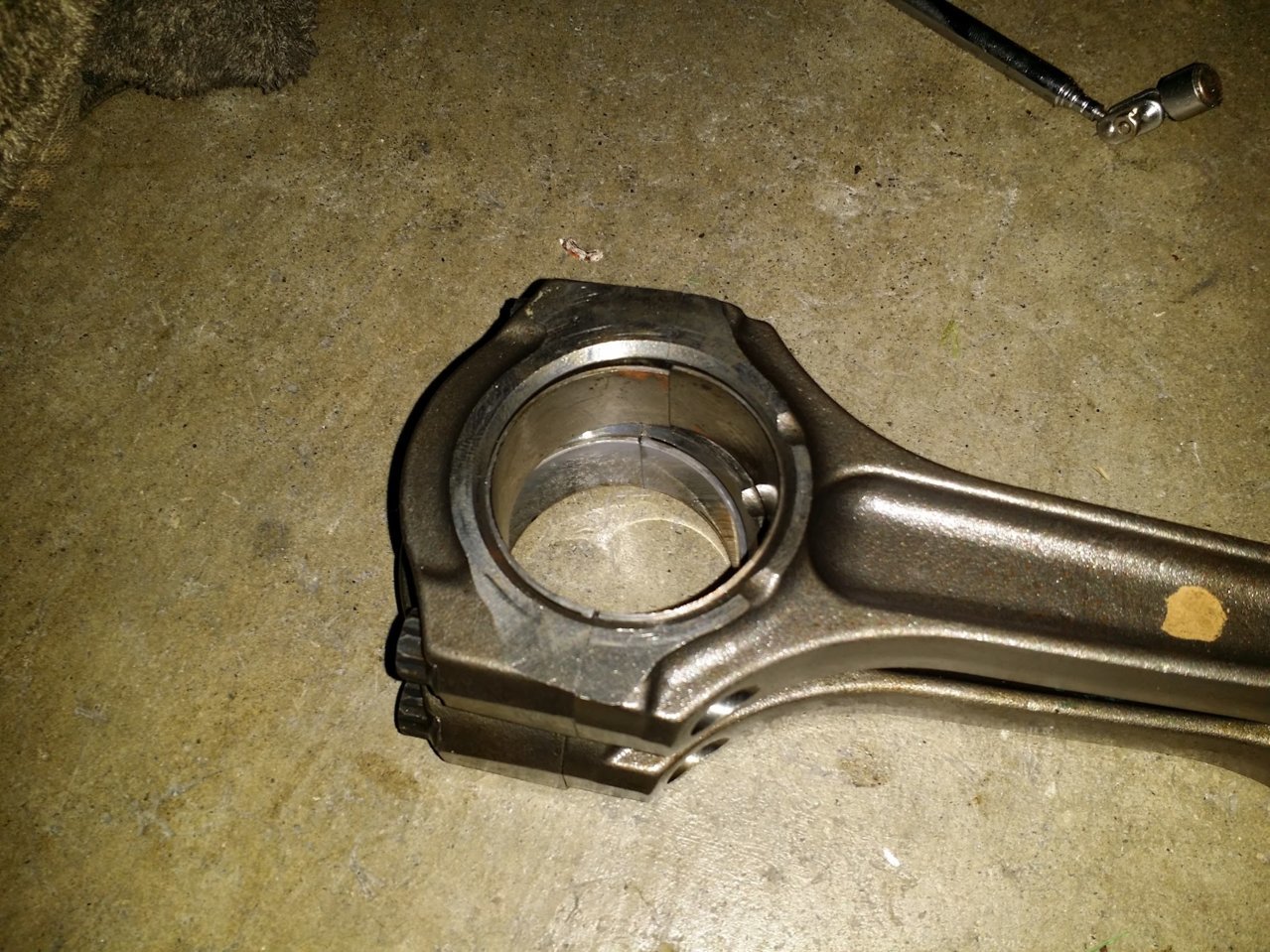

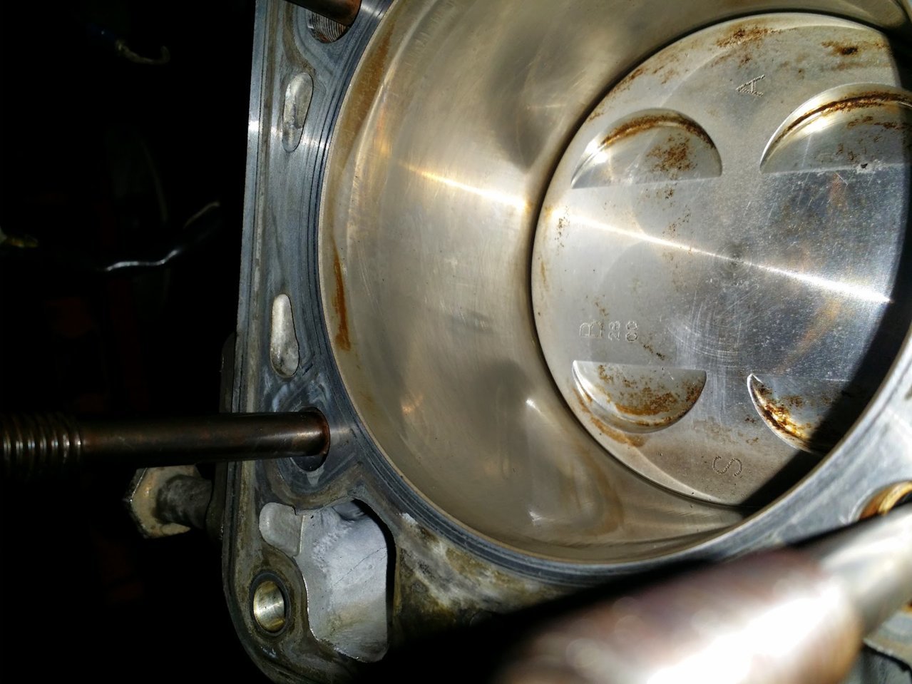

    I have never looked under an automotive valve cover, but I have torn down a couple motorcycle engines. At 84k doing factory recommended 6k OCIs using automotive diesel oil, it was pristine inside other than the spun con rod bearings. The one fragged on the cylinder that had a timing belt snap 4k earlier.
    Even the cross hatching on the bores was still visible.
    I was in there adjust valves every 6k, same with the used replacement engine. Pristine.
    Modern fluids and additive packages are amazing.
    Found some pics:
    Under the right side cover with the primary drive reduction:
    This is what made me decide that a new engine was gonna cost less than a full rebuild:

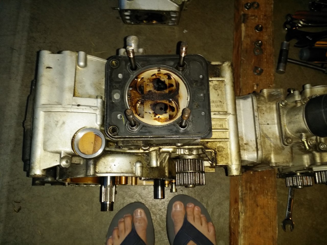

    Connie was not happy:

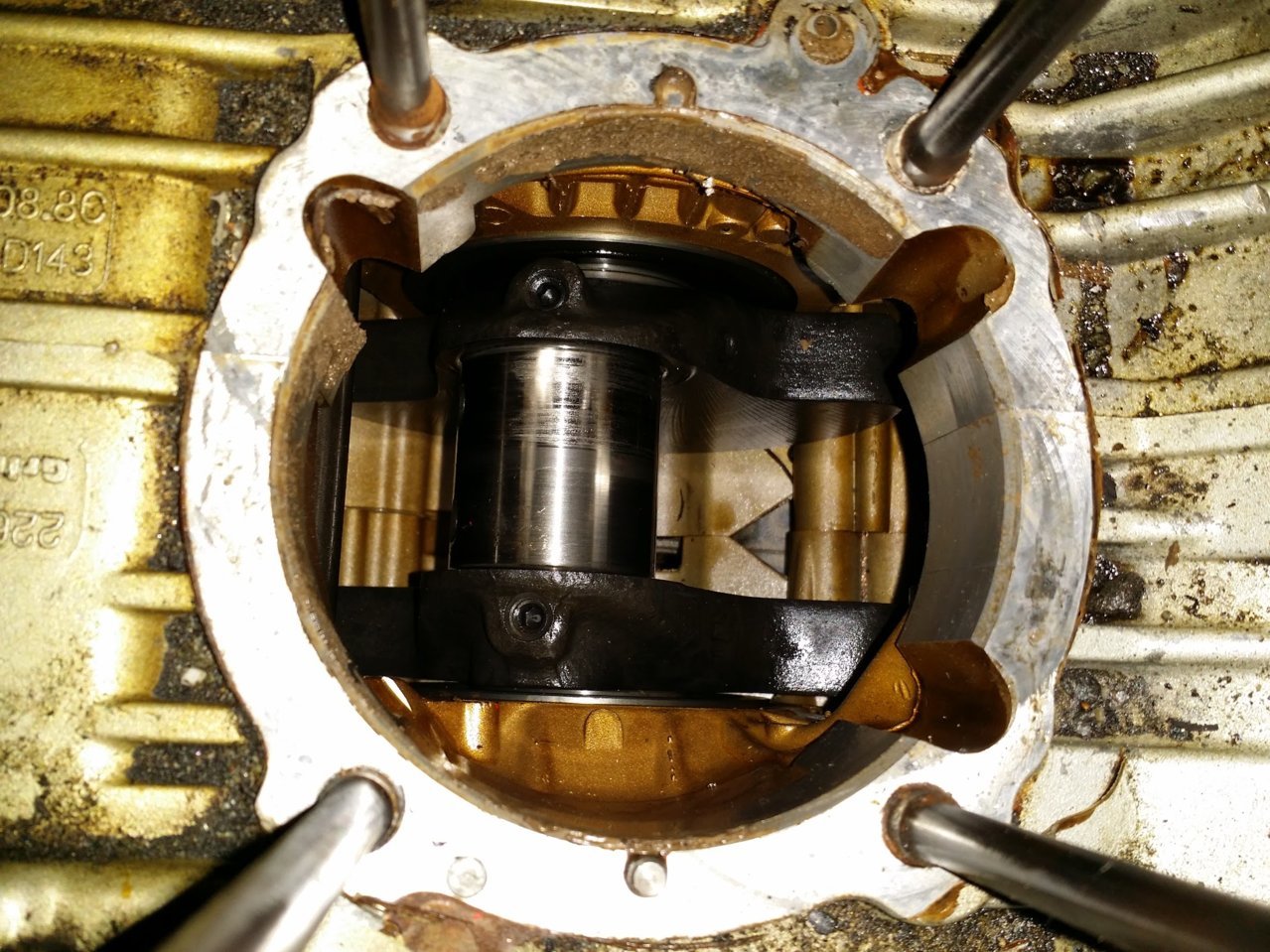

    Oops! We need some toe bombs:

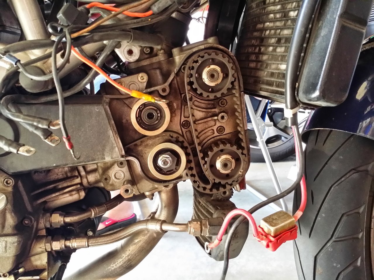

    Just for belt snapping fun:

    Damn! That belt snap is scary.

    Yeah. It bent the two intake valves. It was an pretty easy fix, except for the eventual consequence.
    That said, both times, I rode it home. 3.6mi on one cylinder with the snap. That is how it earned the name Thumper. The second time, things went south after a fun little pass near redline. It was sorta vibe free under 4k. Much longer ride home with that result. I was most likely my own worst enemy.
