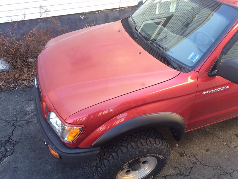

    Here is the situation:
    My hood was cheaply repainted about 8 years ago and the clear has started to peel (by previous owner). I managed to scrape it all off so it's down to the base color layer.
    I am not really interested in getting it professionally repainted because I'm cheap and because it will just get all scraped up during the first wheeling trip after.
    Here are the two options:
    1) Repaint it red with Duplicolor Perfect match rattle cans and clear. That will look okay but it won't match 100% and people will know it was rattle canned.
    2) Rattle can it black. Easy to touch up, won't be stock so everyone will know it was painted black on purpose.
    If you have any pics of an impulse red truck feel free to post em up!
    Currently:

    That is my concern with red, even if I get the napa paint it will still look like a rattle can job. Whereas people would know the black was supposed to not match.
    I cant use clear vinyl because when the clear peeled it left weird waves in the base color. You can see it in the pic a bit.
    The other thing is a pro repaint (someday down the road) will cost the same whether it is going on shitty black or shitty red ha

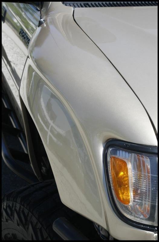

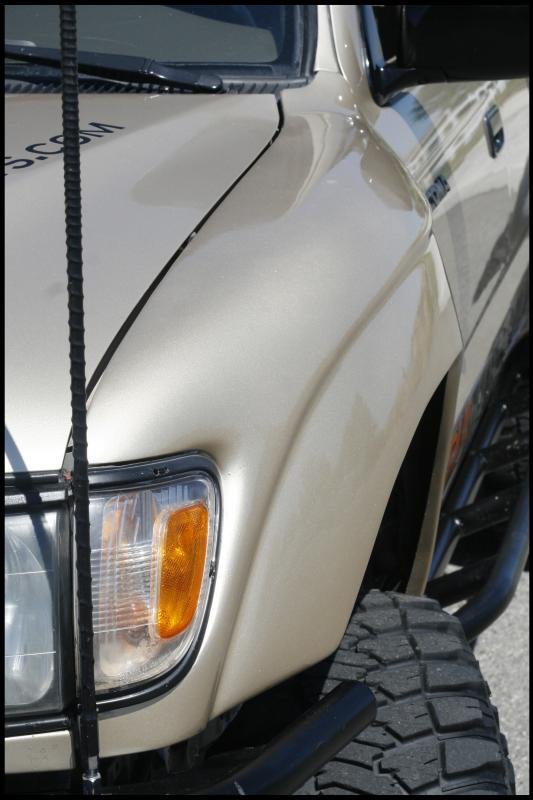

    I got a quote to have my hood repainted on my Land Cruiser and I was looking at about $400. I'm in the same boat and I think I'm just going to repaint it myself sometime this summer.
    Rattle can is tough to make look good on a large flat surface like this. If you decide to do it that way, my suggestion would be to take your time and be sure to wet sand the paint before you do the clear to try to take out as much of the "feathering" as possible. The trick with clear is to put it down thick enough that it doesn't develop that same kind of "feathering". I did this when I rattle canned my fiberglass fenders and it worked out pretty well.

    Great tips, thanks
    Those fenders look pretty good.
