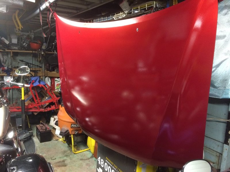

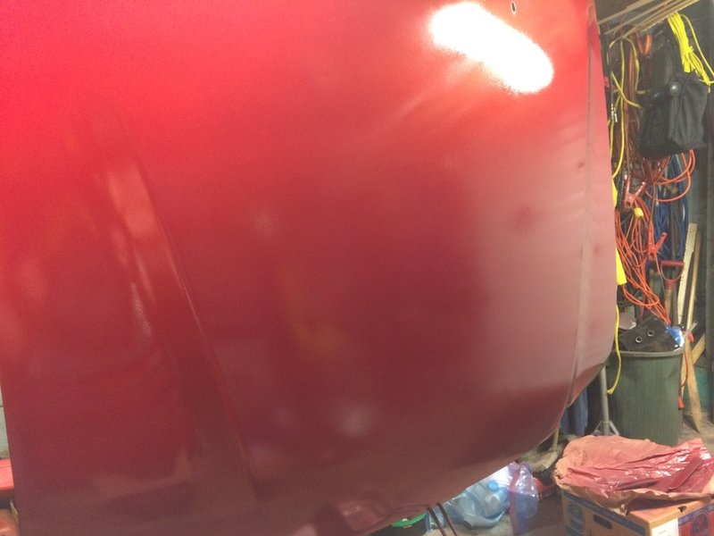

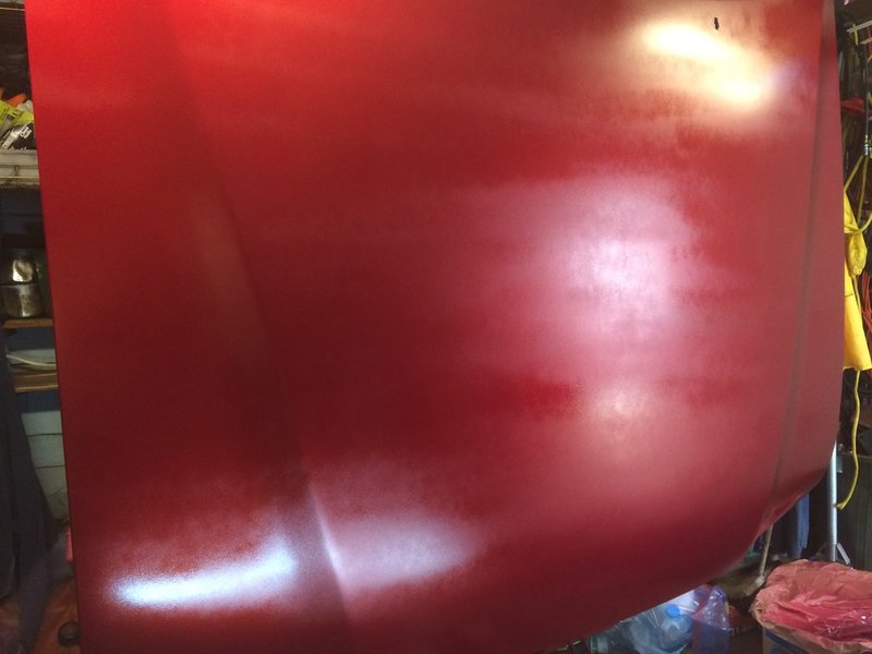

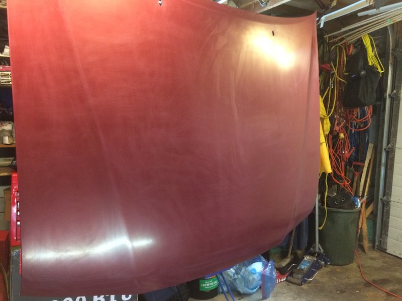

    So I went with the crowd and re-redded it. Used about 4 small cans of colour (Dupli-color Perfect Match) and 2 big cans of clear. Probably didnt need that much colour but I had it so meh
    Scuffed
    Painted
    Cleared
    Done and drying
    [​IMG][​IMG]
    Looks pretty decent now, but I will have to see it in the sun and next to the fenders.
