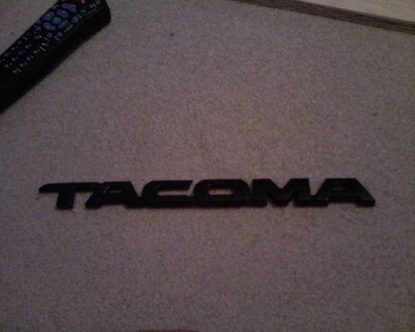

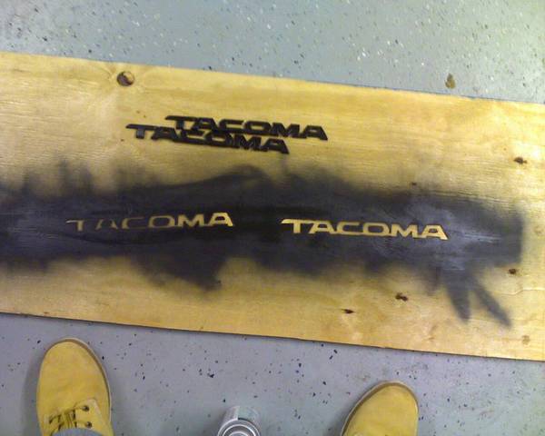

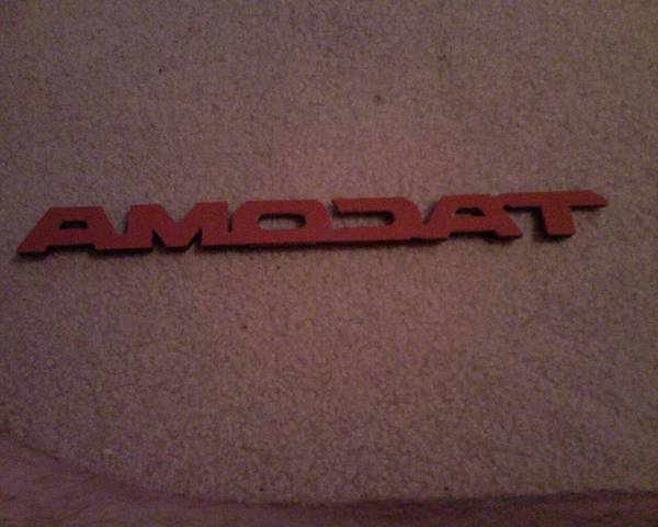

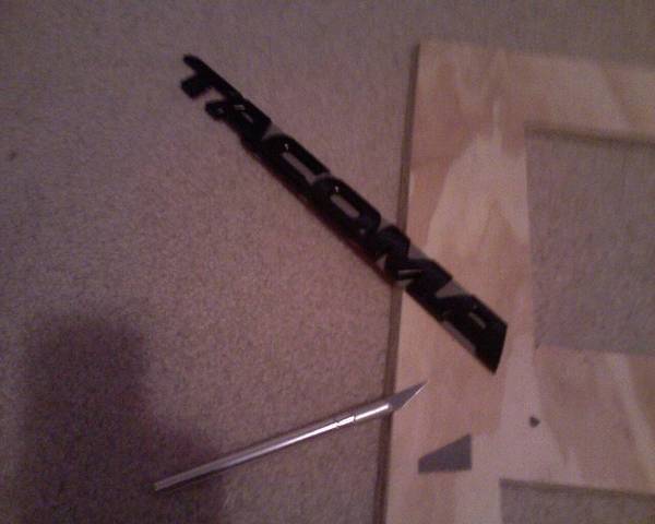

    oh and here are some piks of what i got so far.

  12. Mar 11, 2009 at 6:13 PM

    Ok I suggest painting After you apply tape... i scratched some off... but itll be ok I repainted and you can't really notice
