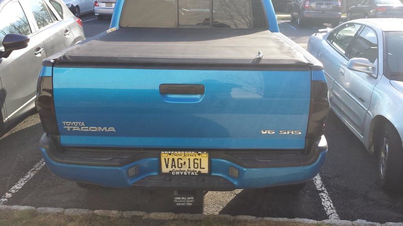

    20131207_132715.jpgeasiest but great looking mod

    Your licence plate says vag haha
    .....tailights look good, though

    What method was used to tint your tails? Was it that spray in a can or a paint clear coat mix? Also, what about the prep?

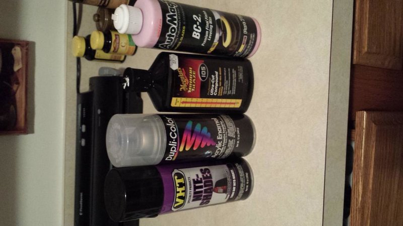

    I wet sanded then first then painted them with VHT night shades like two or the light coats them wet sanded them with 1500 then polished them with meguiars mirror glaze

    20131207_212722.jpgOh and during the prep after first wet sanding with1000 I wiped the lights done witha tack cloth

    Really what pricks cars that come stock from the factory come with tinted tail lights
