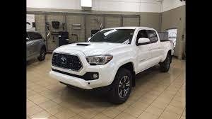

    I think this is the kind of grille the OP has.

    Yes, and it is chrome under the black center (black chrome) no peeling on mine, but stone chips. Chrome showing where chipped.
