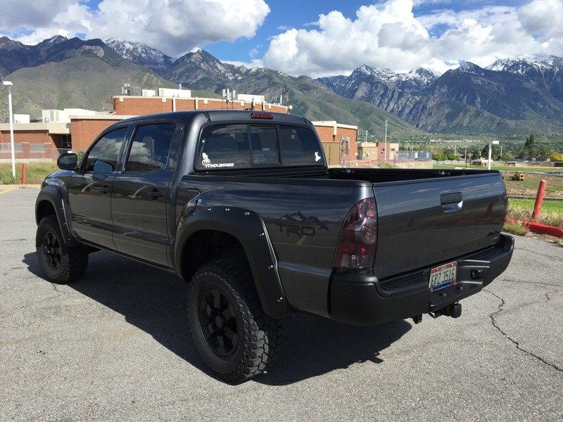

    Hey guys, just wanted to follow up and share the process that I recently used to restore black plastic that had turned white and crusty. I started off using this post as a guide and built a DIY grout brush attachment (see here also) for a power drill. For cleaning, I used . I started by spraying down each section of plastic with a 50/50 mixture of APC/water and let it soak for a few minutes. Then using the brush attachment and medium speed, I went over each section of plastic three to four times, making sure to keep it soaked in the cleaning solution. It's pretty messy but you'll notice a difference right away. After the final pass, I wiped down the plastic with warm water to make sure it all of the solution was off and topped it off with a coat of sealant (I used Opti-Seal because it was what I had available). Once that had dried and cured, I finished everything off with 303 Protectant. Below are the results; trim now looks brand new and repeated applications of 303 should keep it that way. I should note that this process was performed on the bedrail caps, the tailgate cap and rear bumper. The rest of the trim, you can use the cleaning solution and a magic eraser.
    9FDA6493-CF17-4492-B795-0241440A6DC6_zps_a68d226137caebd6600934a95012e8cfc70ce22b.jpg
    On the front wiper cowl trim, I wasn't able to use the brush so I used the APC solution and a magic eraser with the same results.
    Hope this helps! Let me know if you guys have any questions.
