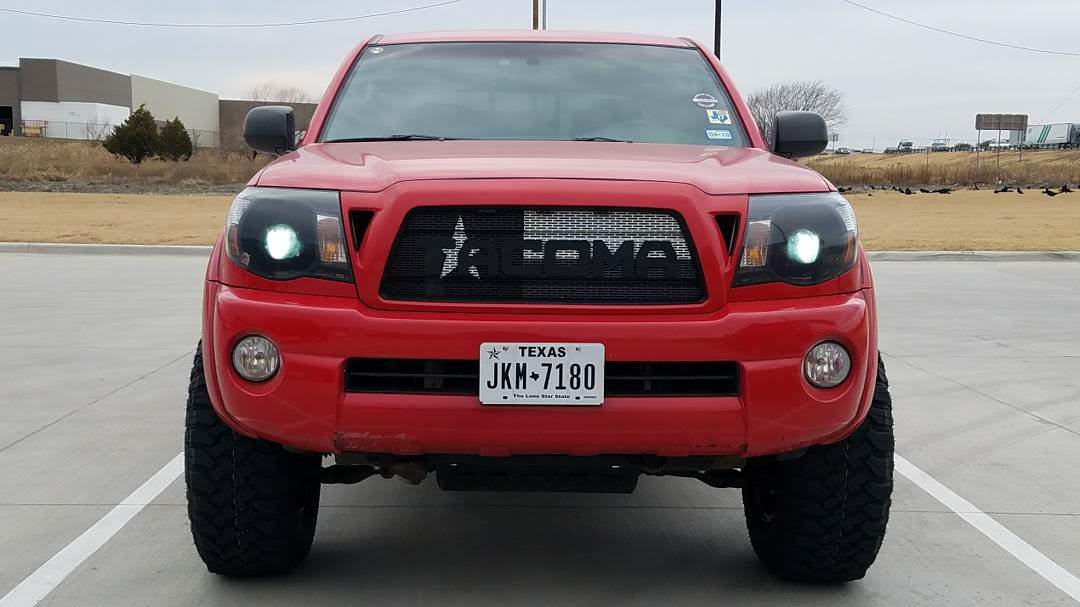

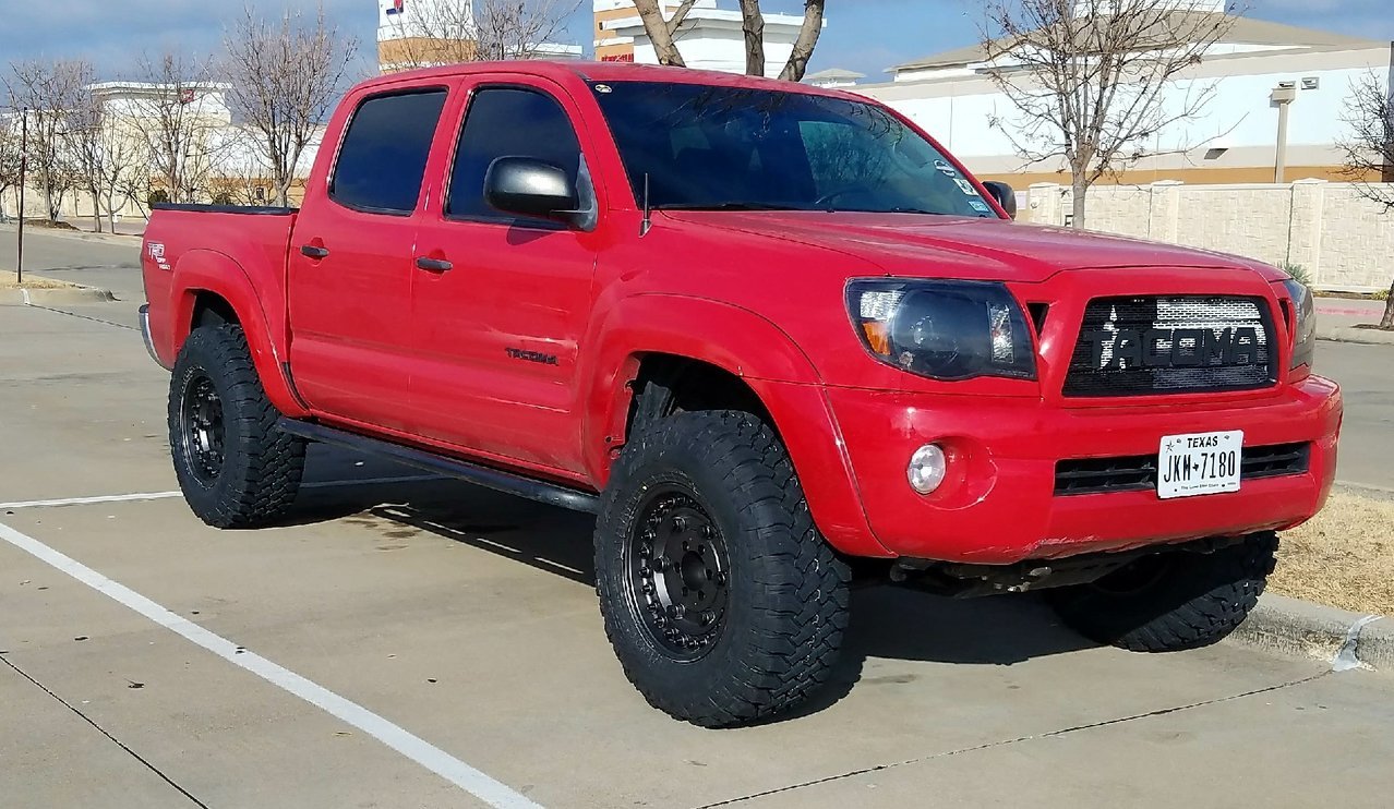

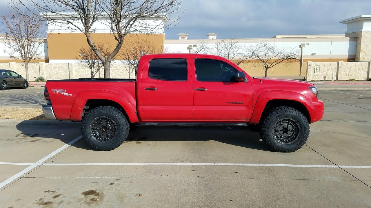

  13. Mar 12, 2022 at 4:52 AM
    #133
    rocklobster2008
    rocklobster2008 Well-Known Member
    Jun 28, 2017
    #222583
    1,197
    Jayson
    Fort Worth, TX
    2008 Red Tacoma TRD Off Road
    Brute Force Fab front bumper Dobinsons Snorkel 35" Nittos Bilstein 5100s ICON leaf springs RSI SmartCap Bed Replacement Diode Dynamics lighting Custom built morimoto headlights RCI full skid
    Gas mileage is VERY subjective. It's all how you drive and anything that's on the truck different from someone else. You bought the wrong truck if you're concerned about gas mileage. Yes and 33x10.5 (295/70 or 285/70) will rub. They stick out about an inch and a half or maybe two inches past the fender. You gotta think you current wheel is a 16x7 I believe, someone correct me if I'm wrong. So even if you keep the offset and go to just a 16x9.5 or 17x9.5 that's 2.5" that the face will move forward. Then you change that offset from a 30mm to a -18mm that's almost another 2" difference. Also depends if your lift kit is specific to the 3rd gen Tacoma. If not and it says from 2005 to 2022 then you didn't get a full 3.5". You lost likely got a 2-2.5". The 3rd gen will not get the same height gain as a 2nd gen, as the 2nd gen specs are slightly different. Then on top of all that it depends what tire you use. Mud terrain tend to measure closer to the full size that are advertised due to the larger lugs so you'll most likely rub more with a mud terrain than an all terrain.
