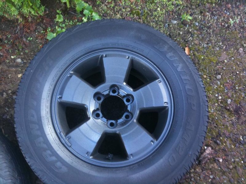

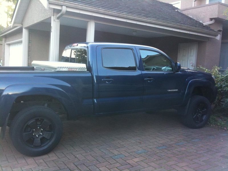

    Spray on bed liner FTW

    Looks good, I think I will have to do this to my truck.

    My rims were getting blemishes from the salt/sand during the winters. I really had nothing to lose. Bored one weekend and decided to paint them. Originally was gonna use Plasti Dip but I found Bed Liner was cheaper and probably a lot more durable. Now that I have them painted, thinking twice now about sinking money into new wheels :D

    did you guys prime them?

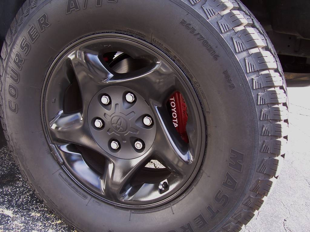

    • sanded primer and high heat paint[​IMG]

    tht looks sick ^^^ cant wait to spray mine

    did u prep it first? or just clean and spray?

    Just cleaned and sprayed. Ended up doing 3 coats on the rims. Had blemishes on rims due to the salt/sanding of the roads in the winter time. Sanded the bubbles out, washed and then sprayed
