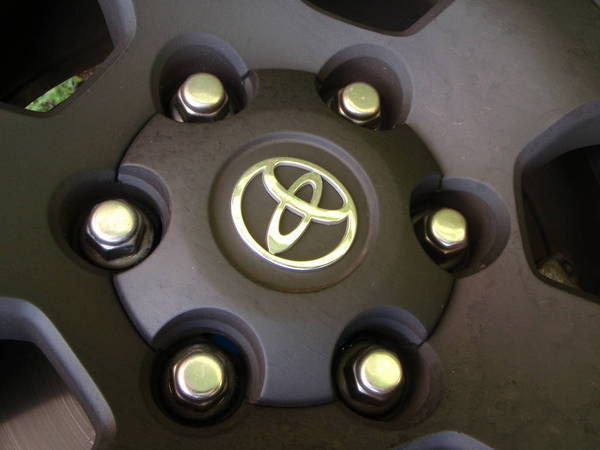

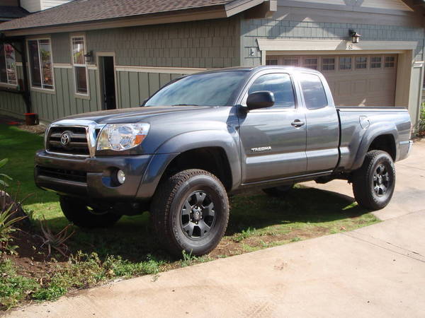

    Just finished mine! :D

    Looks awesome
    Did you go with a gunmetal color or is that just the bright sunlight playing tricks on my eyes?

    These are flat black.....I took the pics in the AM with some smoke covering the sun!....cane fires :)
    Yeah....have to paint the weights up as well.
    I'm super happy with the badges as well....I actually broke the plasitc welds behind the hub with a flathead screwdriver. It made it easy to paint then slap the badges back on with a little glue. What do you guys think?

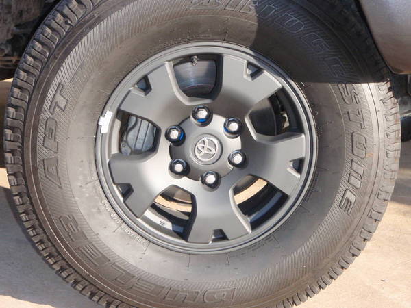

    I used
    Rustolium Car Primer- Black (3 coats)
    Rustolium High Performance - Flat Black (3 coats)
    Here are more pics after a little on/off road use.

    took me 8 hours to do all 4 wheels today. i only had 1 jack lol.
    my dumbass dropped a lug nut on the rim while re-installing one of the tires. :mad: i had to touch up with a cotton swab.
    otherwise, i'd say it looks pretty good and it was cheap on the wallet! :D
    what i used:
    Duplicolor wheel coating black x2 cans
    Duplicolor primer x1
    Duplicolor wheel coating clear x1
    320 grit sand paper
    bucket of soap, water, and brush
    goo gone
    OEM jack
    ipod!
