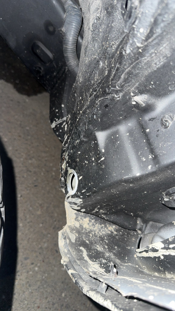

    Hey guys. 2022 premium. I went through a river crossing last weekend and about a week later my head unit is just not working with no warning. I checked grounds and fuses and there all good. Anyone have this happen?
    I did notice I’m missing a plug on my inner fender leading to firewall. I’m assuming water got in there and curious if there’s electrical connections in there I can feel a wire. Thanks.

    Not 15 seconds I can try when I’m off work. So far if been told to unplug it and replug it in. I’m just stressed there’s some type of electrical connection where the water gets in to the firewall and corroding a connection. I don’t even know if I can access inside that hole besides removing the cowle
