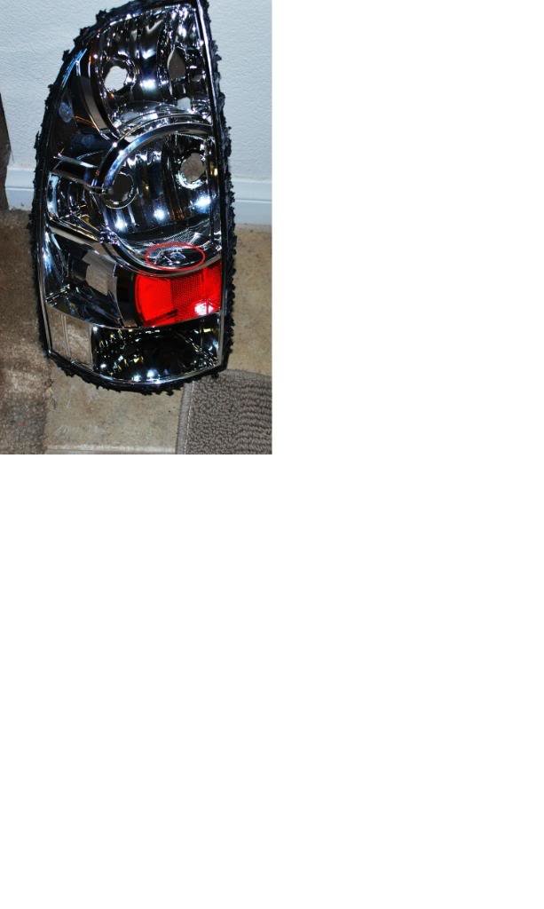

    the led mod would be mostly the same. as far as the led's- on the inside of the housing where the brake light bulb goes in if you look in the hole you will see 2 tabs opposite of each other. use a long flat tip screw driver to pop the tabs loose. thats what holds the large round led module in place. on the back side of that piece 6 phillips screws hold the led circuit board to the led housing. i circled where the tab is at.

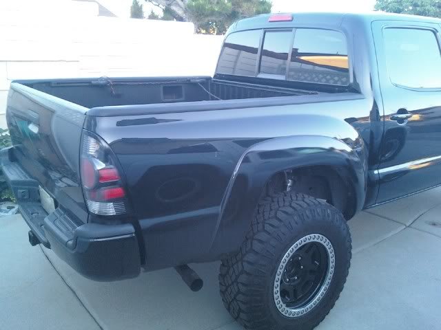

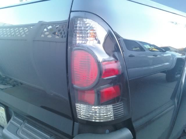

    Finished these up this weekend. Hosed them down a few times and no water has made it in, and no moisture from sitting outside at night. So far so good, here are the only pics I was able to snap this morning before heading to work.

    you're crazy tyler looks good though glad you finally got it done!! My new headlights should be in soon I will be sending my old ones your way :D

    nice man!
    glad you ditched the pink :p

    I'm glad they are done too, they've been nothing but a pain. Between busting a dremel :eek: and ordering an extra set of tails just for clear lenses I think I've put enough money into these. They better just not start fogging up anytime soon because I'm done messing with them.

    Looks really good!

    god damn they look amazing! Mine next? :D

    Damn, I might have to get a set of LED taillights off an 09 and do this! Nice work guys!
    Is that black border around the perimeter of the taillight to hide imperfections from the cuts?

    those aren't the '09 tails rhino. they're the ebay ones.

    personally, i'm not a big fan. looks too much like the older subaru forester tail lights. i like tinting better.
