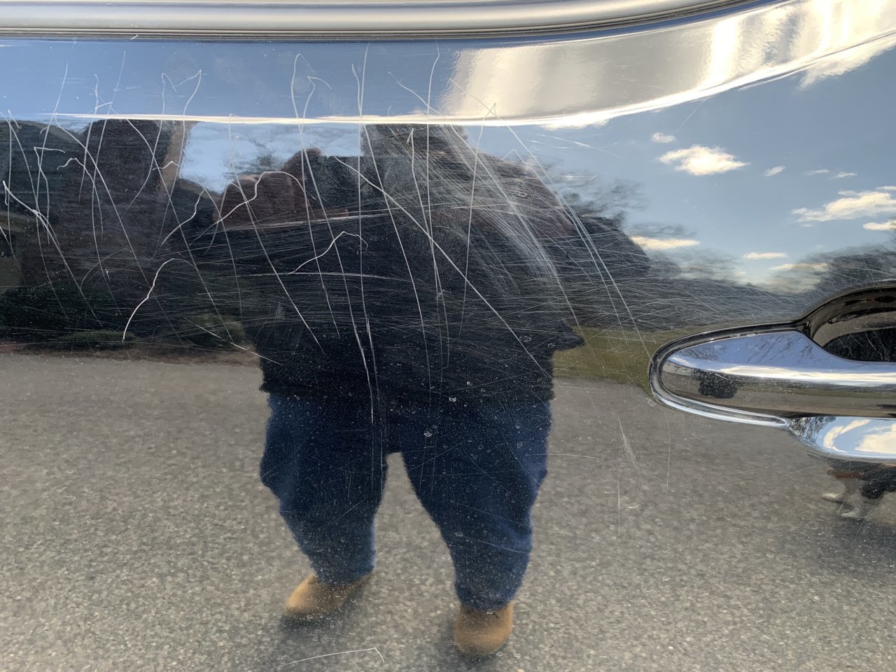

    another persons dog tries to say hello to my dog in the back seat, result, scratches big time, 2PzSjVZ+RpScx1OZXMCZAw.jpg

    Ugh. The joys of dog ownership. Time to invest in a dual action orbital, pads, and compounds.

    Wash, clay bar and wax it up, should take out some of the scratches. There's some pros on here that can give some even better advice.

    Ouch! That’s rough. My wife’s 4Runner had some scratches and dings and I used a dual action polisher and some Chemical Guys polishes (V32-V38) and it definitely helped. It won’t completely get rid of the deeper scratches, but it can make it a little less noticeable.

    The pic I think is magnifying the scratches because of the sun angle also, you see some horizontal stuff underneath too unrelated

    Had a black Mustang for years that we took to shows on the weekends. Never had it in a garage. It’s a labor of love. I have tried nearly everything on Autogeek and it’s mostly just about elbow grease. Constant two bucket washes and paint correction with lake city pads and meguiars M105/205 kept the swirls at bay. Prior to applying your wax/sealant give this stuff a shot: Does a great job hiding imperfections on black paint that you can’t get out with your buffer.

    Jeez , when I zoomed in there are hundreds of scratches in the paint .

    Looks as you were due for paint correction. Poor dog just added to the reason to get it done now.

    Might want to consider taking your truck to a good pro detailer. Depends on how deep the scratches really are.
