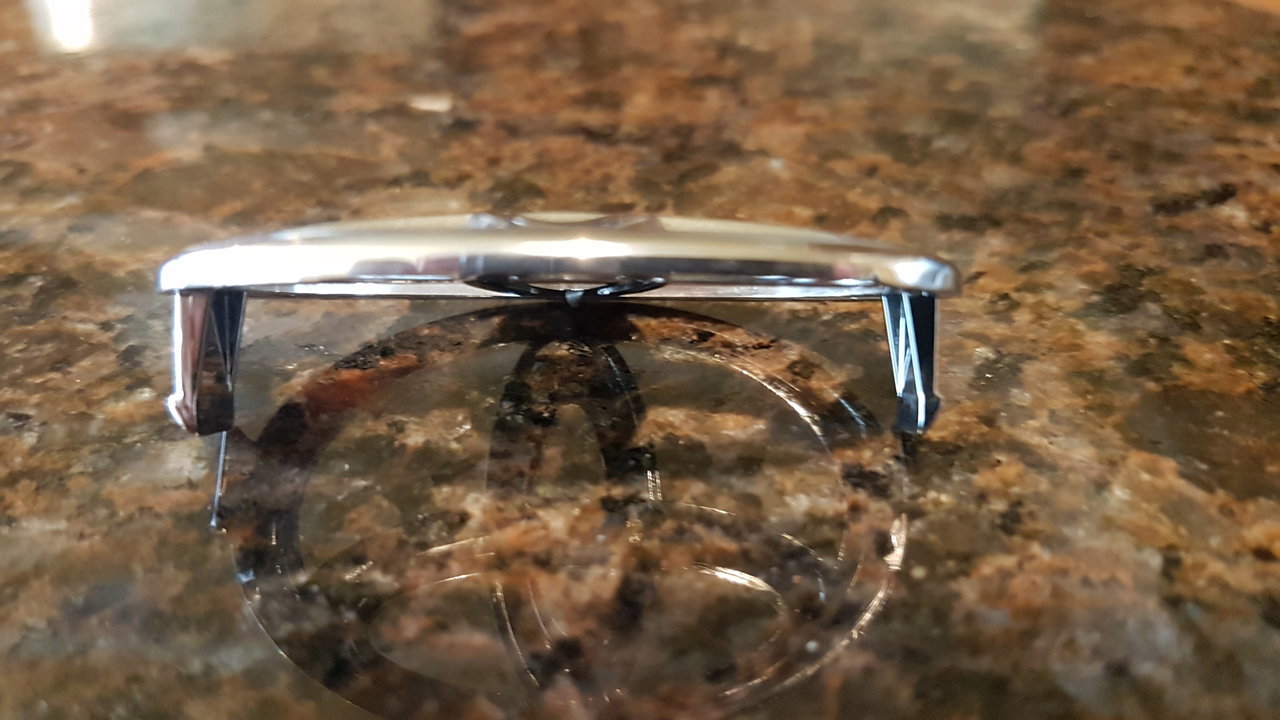

    Hey all. Here are some pics of the OEM emblem on the center cap so you can see how it's attached.
    You can see the two prongs in this shot.

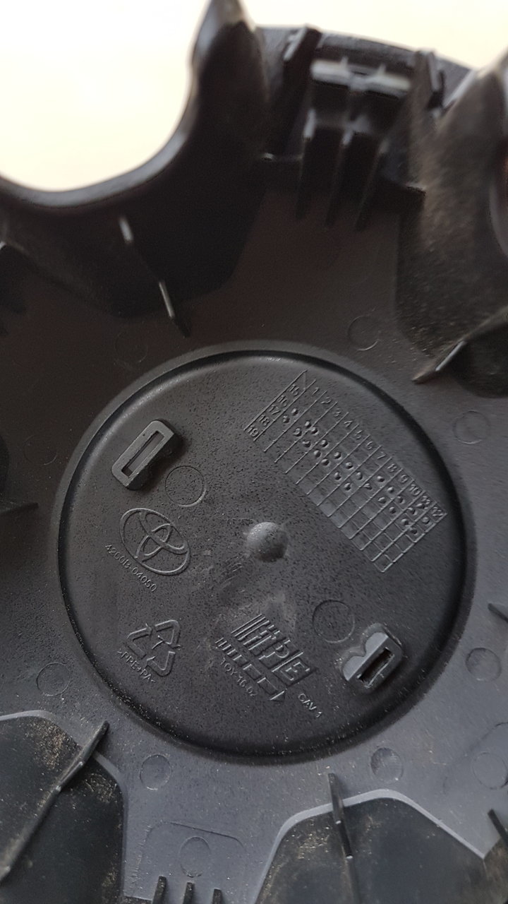

    This shot shows the back of the center cap. The two prongs go inside the two slots. Just tap them through and then pop the emblem off the other side.

    The main center cap just pops out?

    That's interesting. The OR caps look the same as my Sports, but the badge had three smaller tabs.
    A 60mm sticker was a perfect fit also.
    They are obviously somewhat different though.

    Yup. I was able to pop them right off with one hand.
