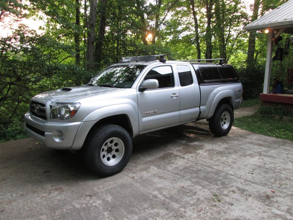

    But I wanna try 'em anyway, haha. Can someone with photoshop skills black 'em out for me. I tried asking this in the photography forum with no replies. Also comments welcomed on rim color choice too. And I'm thinking of blacking out the chin bar under the grill, of whatever you call that peice of bodywork. Thanks everyone.

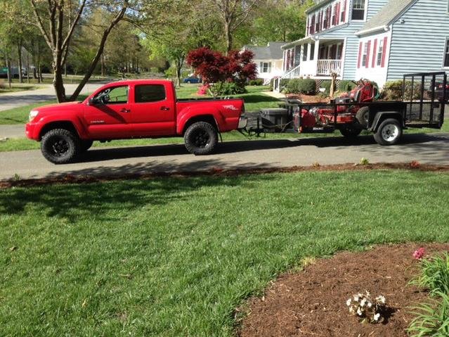

    :DHow'd I do...?

    Masterpiece!

    Haha! Thanks for the laugh!:thumbsup:

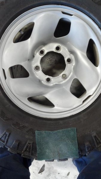

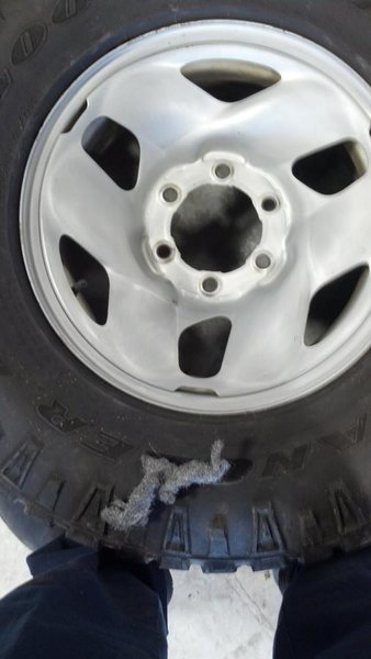

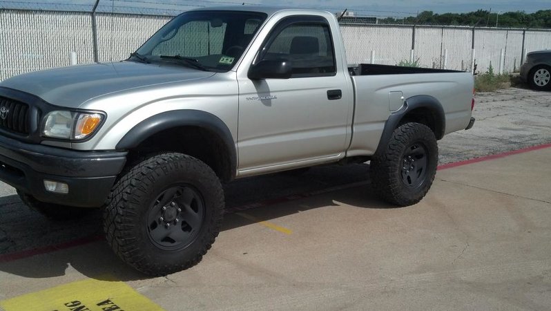

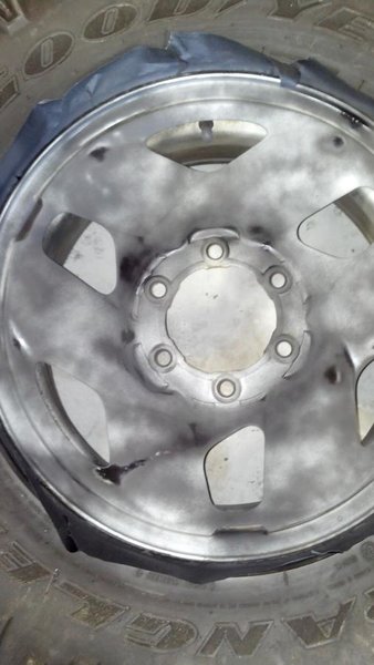

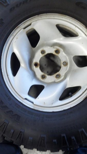

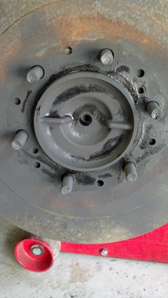

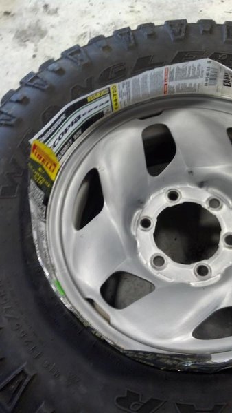

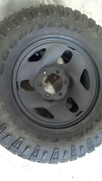

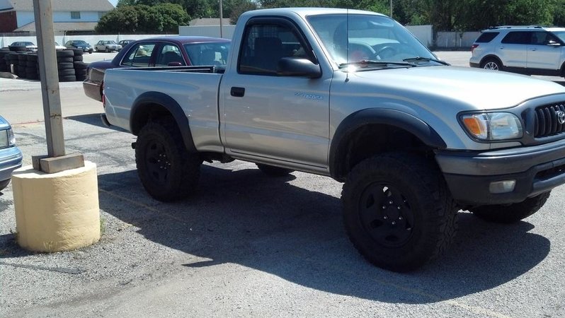

    When I painted my stock rusty wheels I didn't use plastidip or powder coat (too expensive for me). I used elbow grease and high temp grill paint! First, steel wool all the shiny spots and all the rust spots off. Then use scotch brite to remove any dust and leftover shiny spots. Next tape off the sidewalls. In my case, I used leftover tire labels because they stick amazingly well to dirty tires :). After that, lightly dust over the wheel with high temp grill paint, I used flat black. After the first coat dries, go over the whole wheel with paint. Let dry and use as many layers as you like. I used like 7 or 8 coats which was over kill and my fingertips were sore from pressing the paint can. Apparently there's a tool you can stick on the top of the paint can that turns it into a trigger lol! Too late for me though so I had to go with hurting fingers. I also put a couple coats over the rear axle so the wheels would be uniform and not have a center chunk of rusty axle showing lol! Let dry and reinstall wheels.
