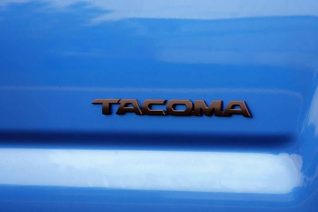

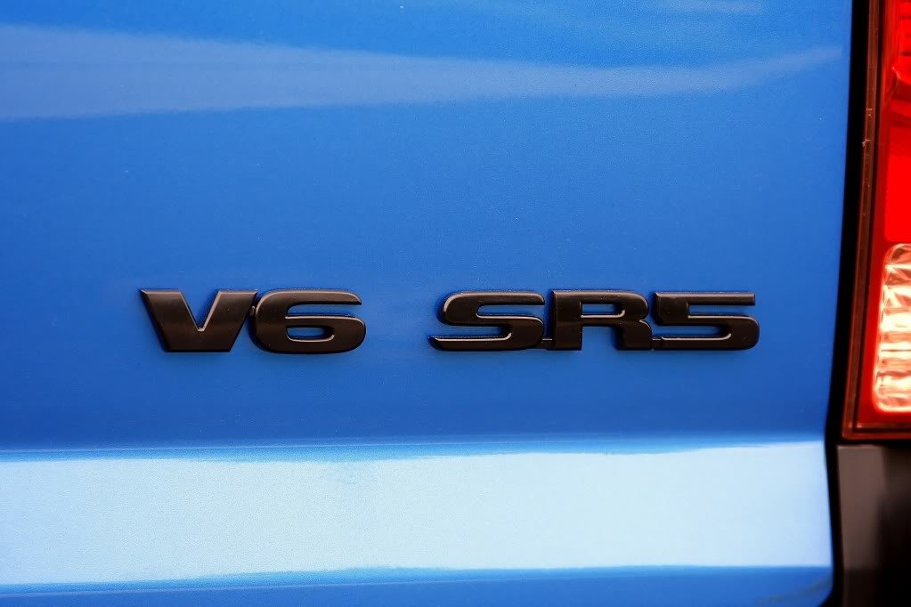

    Well, I got the itch and blacked out my badges today. Turned out pretty sweet. Haven't seen them in the sunlight yet though.
    For those of you considering it. It's a real simple mod. The braided fishing line worked like a charm cutting thru the tape holding them on. From start to finish it took me 4 hours, and that included about 2 hours of dry time for the paint to fully harden. The part the took the longest was cutting the tape for the back of the badges. What a PITA that was....... but worth the effort. Total investment was 1 can of Krylon Fusion paint, so less than $3.00. If I had to buy everything needed to do this mod, I guess it would have cost me about $10.00.

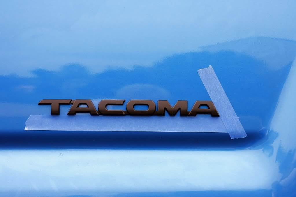

    Here's the step by step proceedure I used. Sorry, no pictures. By the time I remembered about taking pictures I was more than 1/2 done:
    1. Clean the area around the badges. Dirt will scratch the paint as you debadge if it's not clean.
    2. I used blue painters tape as a guide to mark the location of the badges before removing them. I put a strip under the badge, and a small strip at 1 end to mark where the end of the badge was. The painters tape will not be in the way for the badge removal process.
    3. I Used braided fishing line and use a sawing action (back and forth) to cut thru the tape holding the badges on the truck. Some people say to use a hair dryer to heat them up first. I guess it makes it easier, but I didn't do that part. DO NOT REMOVE THE PAINTERS TAPE YET. You'll use this as a guide to reapply the badges later.
    4. After all of the badges are removed, I gave them a quick bath. I used an old toothbrush and denatured alcohol. Scubbed them down good to remove dirt, grime, and any wax or car wash soap residue. Then dried them off with a paper towel.
    5. Lightly sand all of the surfaces with 400 grit (or higher) wet/dry sandpaper. This will give the surface a "tooth", and it should help with better adhesion of the paint.
    5.a. Apply the new adhesive tape to the back of the badges. This will help save the new paint from damge later on. I used the 3M double sided tape that you can buy at Wallyworld for around $4 per roll. 1 roll will be more than enough.
    6. Wipe all of the badges down again with denatured alcohol. Remove all fingerprints. Body oils can cause defects in the paint, and will also cause the paint not to adhear properly.
    7. Find a well lit, non-dusty place to do your painting. I used Krylon Fusion paint, so I did not do any priming. I put on 2 light "tack" coats, and then 1 heavy "wet" coat. I allowed them to dry untouched for 2 hours.
    8. While the paint on the badges was drying, I went back to the truck and removed the remaining badge adhesive from the paint. Most of the remaining tape I could get off using my fingernail. The little bit that was left behind was easily cleaned up using a paper towel with a little bit of denatured alcohol.
    9. After the badges are dry, place them face down (I used a microfiber towel for this) and cut pieces of 3M body molding tape and apply them to the back of the badges. I did not remove what was left of the original adhesive from the badges. There wasn't much left, and I thought it would help stick the new tape to the badges as well.
    10. Reapply the badges using the painters tape as your guide. Remove the protective covering from the body molding tape, press the badges gently against the truck using the painters tape as you guide, but be careful, it's not a tank, and the sheetmetal may bend if you press to hard.
    11. Remove the painters tape, and you're done.

    Also, while I was at it yesterday I color match painted my grill badge.
  5. May 9, 2009 at 2:00 PM
    Burgman
    Burgman I KEEEEEL YOU
    Apr 16, 2009
    #16072
    26,689
    Stephen
    Ric VA
    08 PreRunner TRD sport Silver
    K&N intake, Boston Acoustic SL 60 6.5 components up front, Rockford Power T16 6.5 in rear, Pioneer P4100 HU, Soon to be Pioneer Prs 4200f
    looks great and im a big fan of the color matched grill emblem the black just doesnt show up enough

    Looks good. I did mine a while back and love the look. Toyota should offer them in black.
