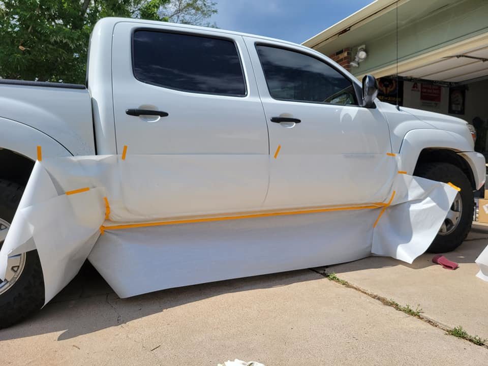

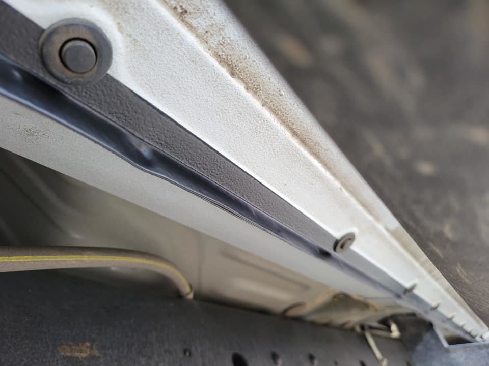

    First things first here's the before pic. Were looking at the pinch weld along the bottom of the rocker panel. Usually the pinch welds are pretty dirty and nasty. I cleaned it up with some water-based cleaner (I used Sprayway for the initial cleaning, and Autoprep for the scuffing), but any cleaner will do.

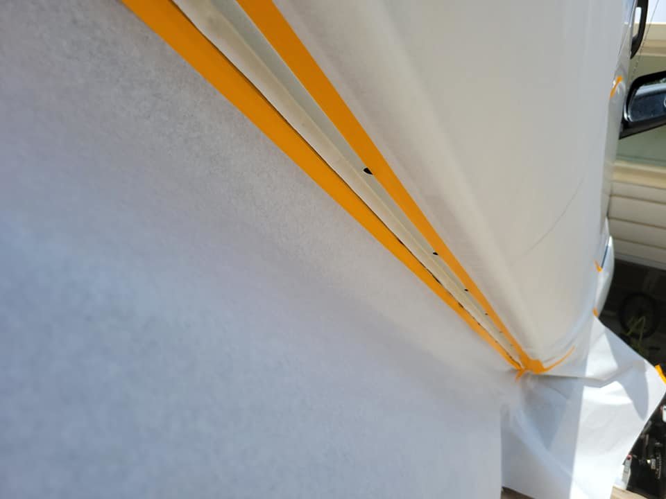

    After the initial wipe down, I used a red scotchbrite flex pad with some water to scuff the pinch weld, along with about a half inch onto the rocker to avoid seeing the two tone line. Scuff it really well, as it helps to clean out any stubborn dirt as well as abrades the surface for the best adhesion. A quick mask job and were ready spray. I didnt use any fancy vinyl fineline tape as these lines are pretty hidden, this is just 3/4 masking tape and 1 1/2 for the backroll. Give it a final wipe down with some kind of solvent to clean up any grease or oil residue remaining on the panel.

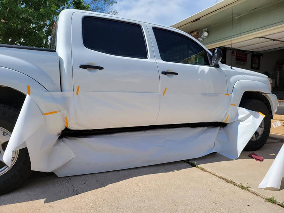

    Here is the bottom of the rocker masked up. I pulled the rocker plugs to get a nice straight line. I should also mention this is easier without nerf bars, but not impossible. If you have the time to drop them off, I would.
    I used the trim black aerosal by Smart, but any decent spray paint will do. I would suggest matt or flat finish, or even bedliner. Three light coats on this one to achieve coverage, make sure you give whatever product you use adequate flash times.

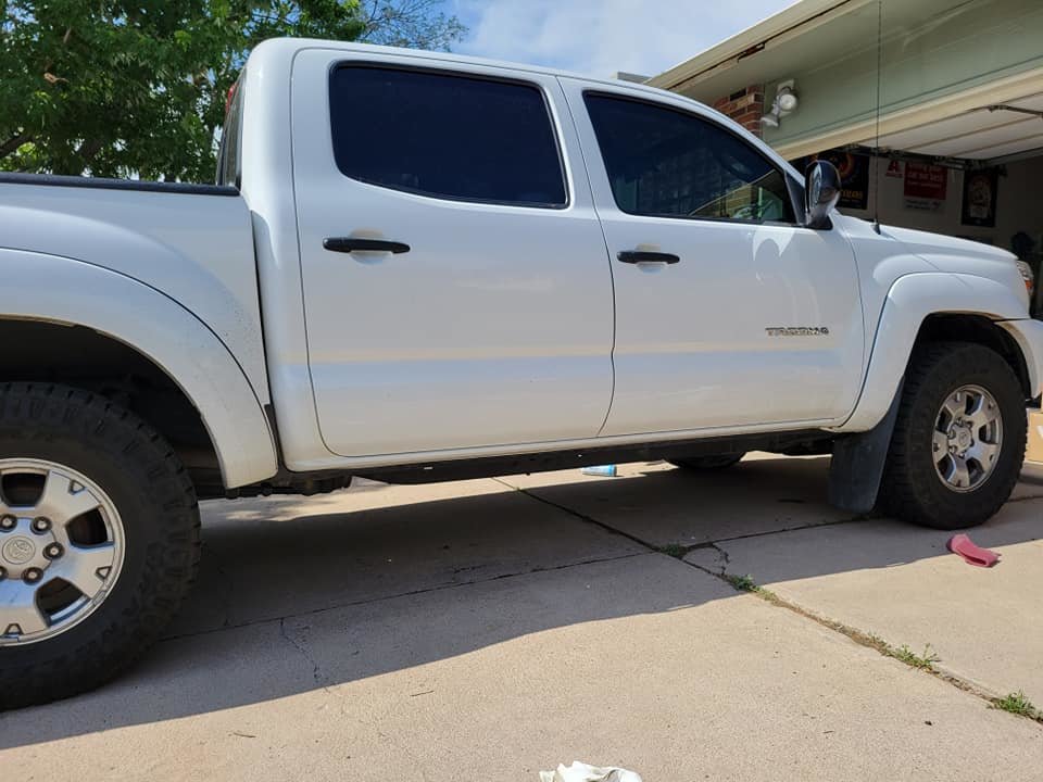

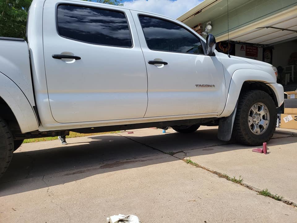

    Pulled the masking and reinstalled the plugs. Nice clean lines.
    Final product. Subtle, but I think it does clean it up a bit. After this pic I put my steps back on and I can cross this one off the list.
