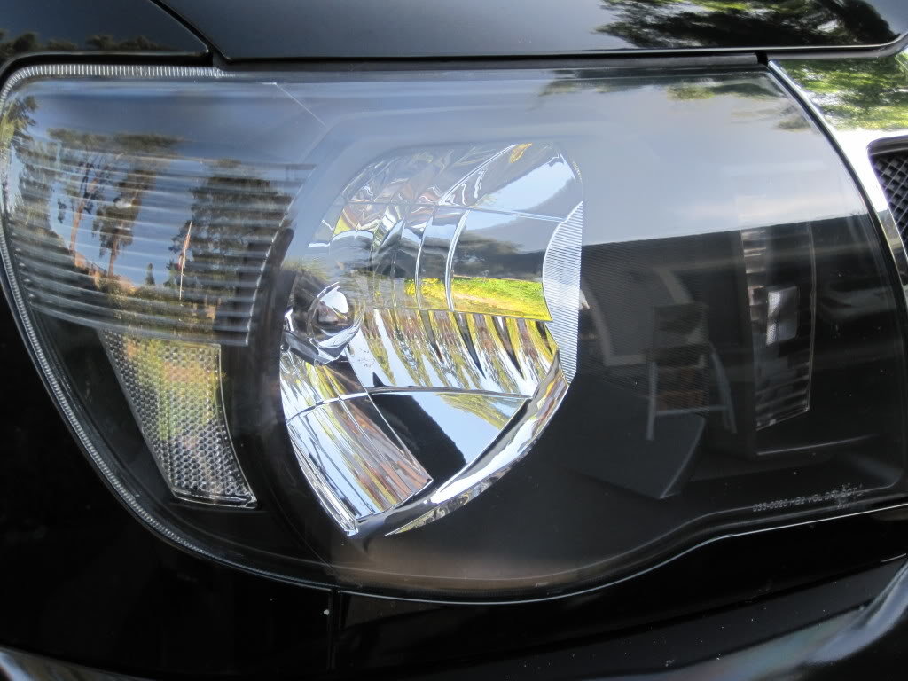

    I wouldn't suggest it. Go with the BHLM instead.
    Finished result should look something like this:

    SOLD
    Black headlight mod
