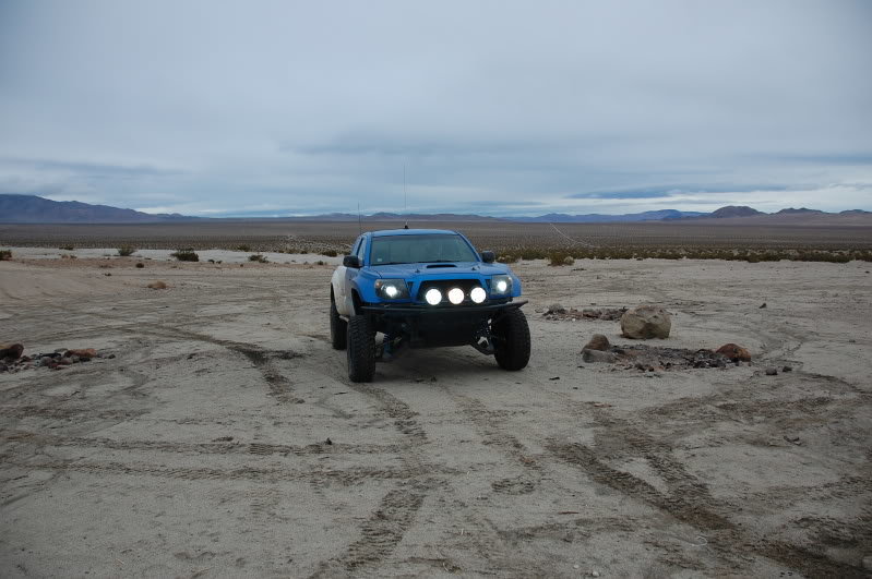

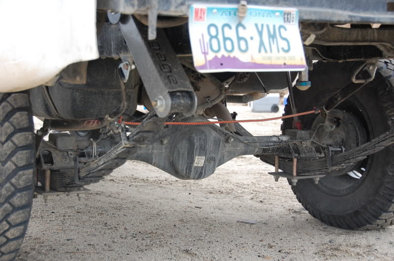

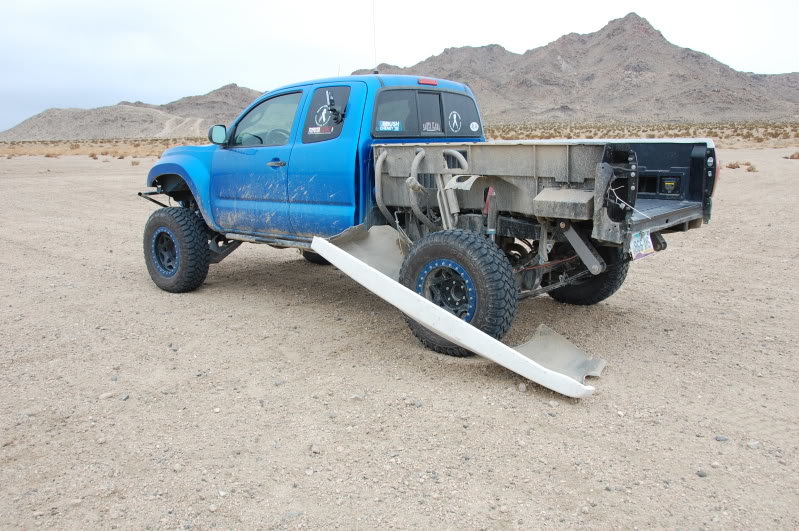

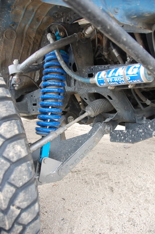

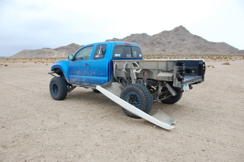

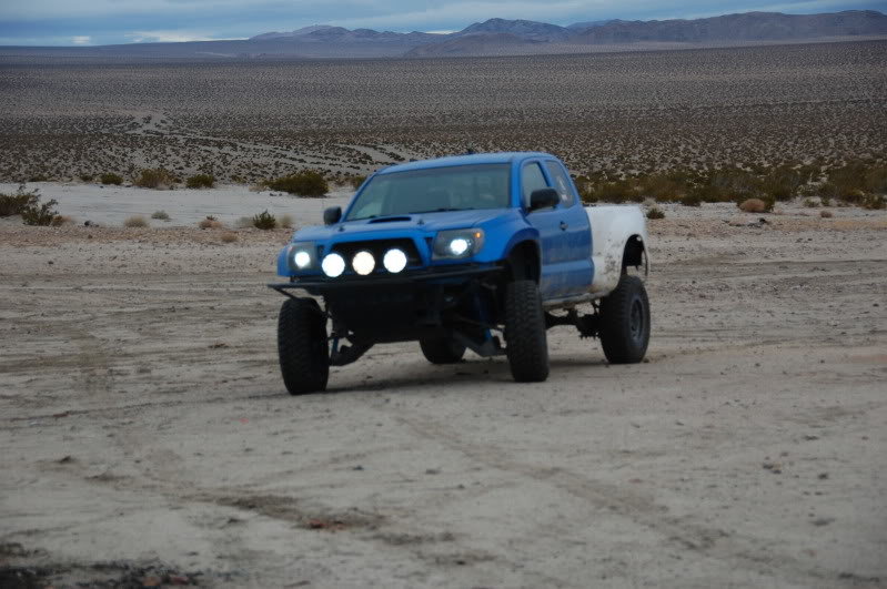

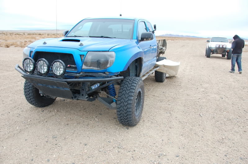

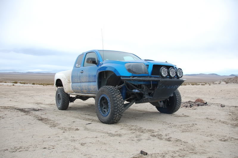

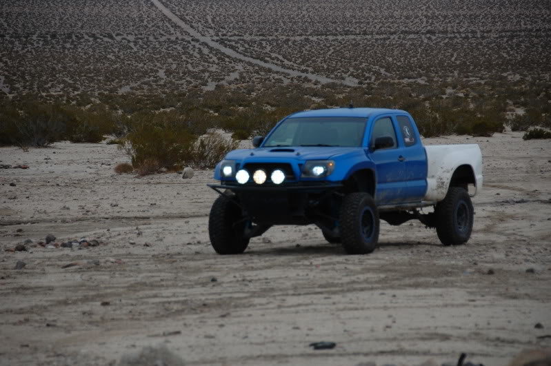

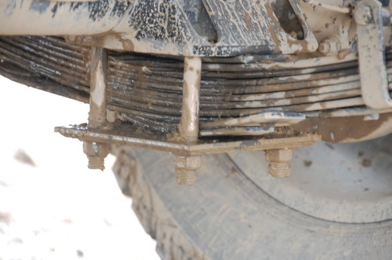

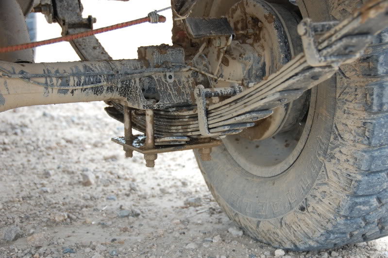

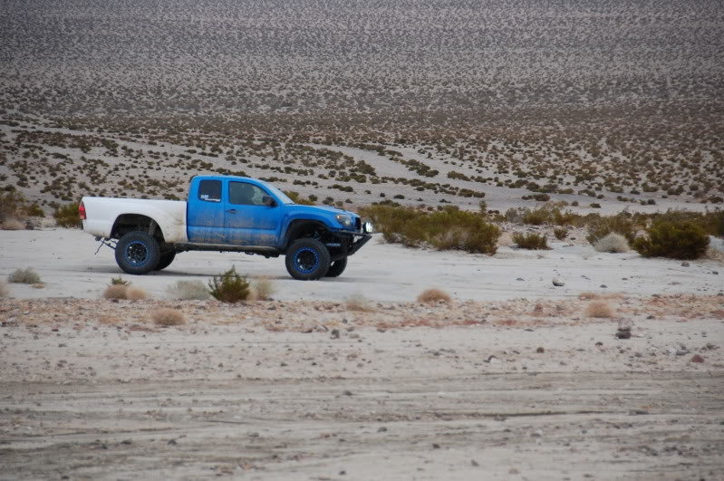

    some pics from today of shit and carnage....I fucking love my truck, my rear end is tits over even the worst whoops, now my front is having trouble keeping up :eek: time for triples up front??

    ^looks good

    Triples up front? I think so.

    Just looking over you pics -- you're still running ungusseted spindles??
    The truck is coming along great!

    Engage didnt have time to gusset them before the meet, im taking her back to their shop next week to finish everything off. The rear cage isnt even painted lol i might just do that myself

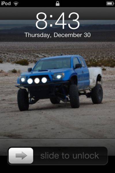

    Thanks for the new wallpaper...:D

    did you get new lower arms and CO's?
    did you have any leafs removed from the 50T pack?

    nice! haha that pic came out pretty well for a wallpaper :thumbsup:
    I didnt get anything new in the front except for longer rod ends and relocating the lower shock mounts outwards. I didnt have any leafs removed from the 50T pack.

    Aaron, one way to avoid having to use that bungee is to turn your limit strap tabs the other way so that your limit straps follow the frame rails and dont bend in/out.
    Tim at DMZ told me about it so we welded in the tabs that way this time around. Its not like it affects performance but it makes life easier.
