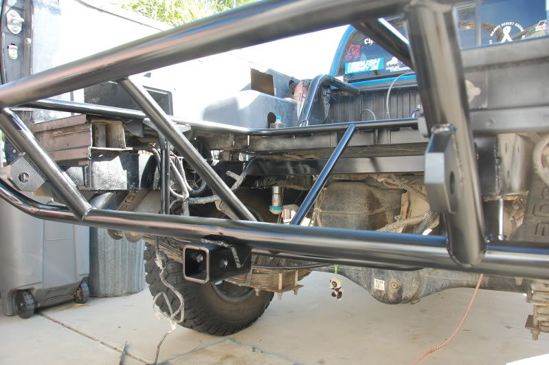

    Looks good man I can't tell from the pics but are those recovery points frenched
    into the tube or just T welded :confused:

    it's just T welded.

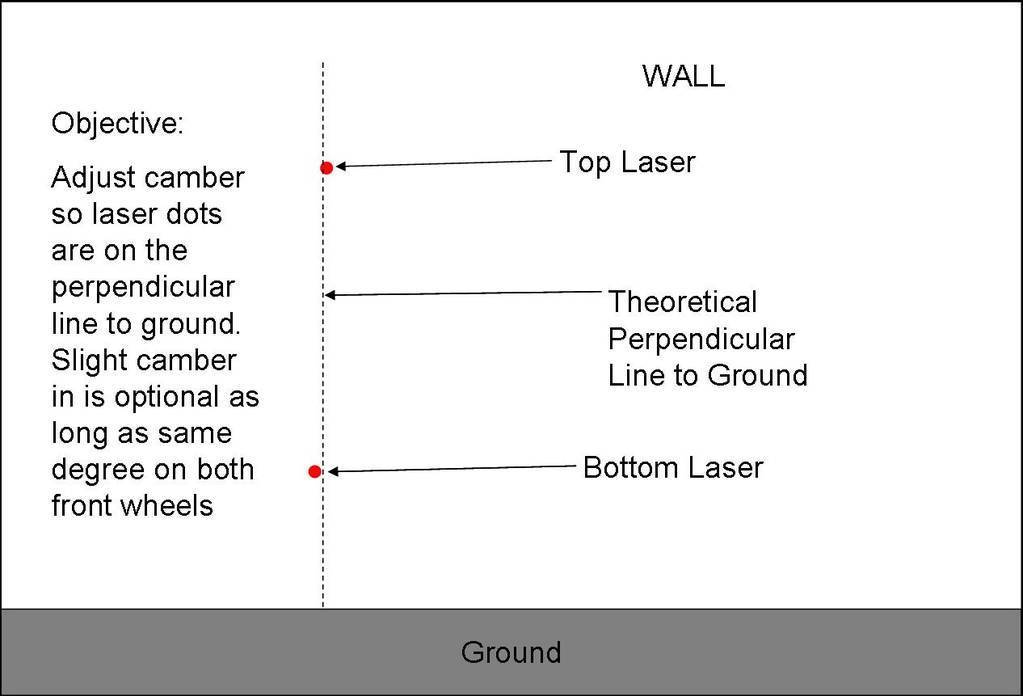

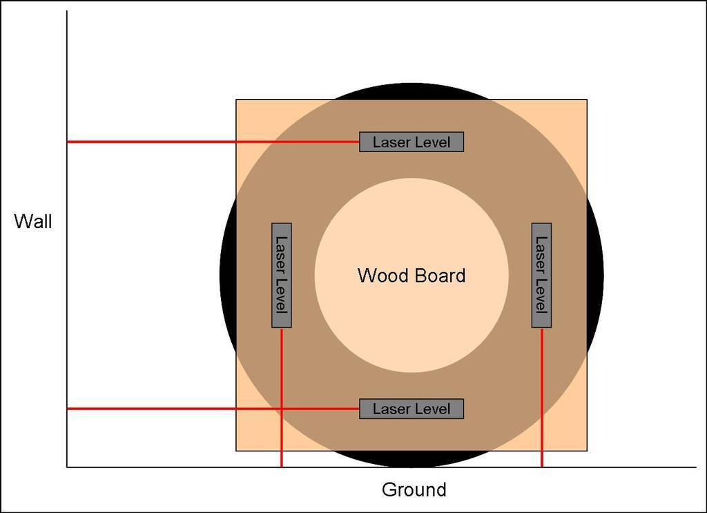

    Here is my homemade alignment idea:
    Camber:
    as the two horizontal laser hit the wall, draw a straight line down them and measure how many degrees they are off a perfectly perpendicular line from the ground. Adjust so both wheels are slightly camber-in at the exact same degree
    Tow:
    as the two vertical lasers hit the ground, adjust the toe so the two front lasers are slightly closer together than the rear two lasers, giving me a slight toe in.
    Theoretically I can do this with just one laser level.
    Any suggestions?

    Camber Adjustment:

    that fastrax looks awesome, definitely gonna pick myself up one of those!
    I want to get aligned by this weekend tho since I was messing with the LCAs last weekend, and I dont have time to go somewhere since I get off work late. Plus, my truck has been rejected from a couple tire places cuz they say it wont fit on their rack or something.
    Is my idea good or bad?

    Well I like your way of thinking but I would do the framing square with a mag mount protractor. You can get good ones at Sears. You can get marginal ones at HF lol I don't know if either have steel ones these days but I am sure you could hold it.

    Oh yeah, you will need a level to make sure the garage floor is level too.

    no way my garage is leve, plus my truck cant fit in there anyways, gonna have to go to a parking structure at night
