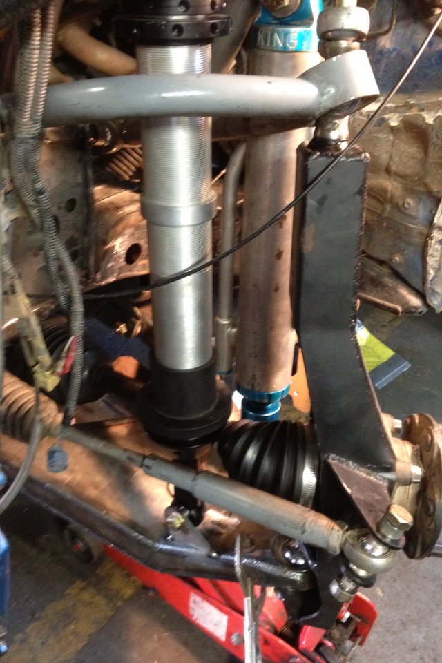

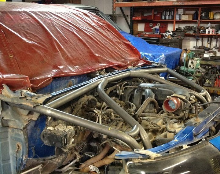

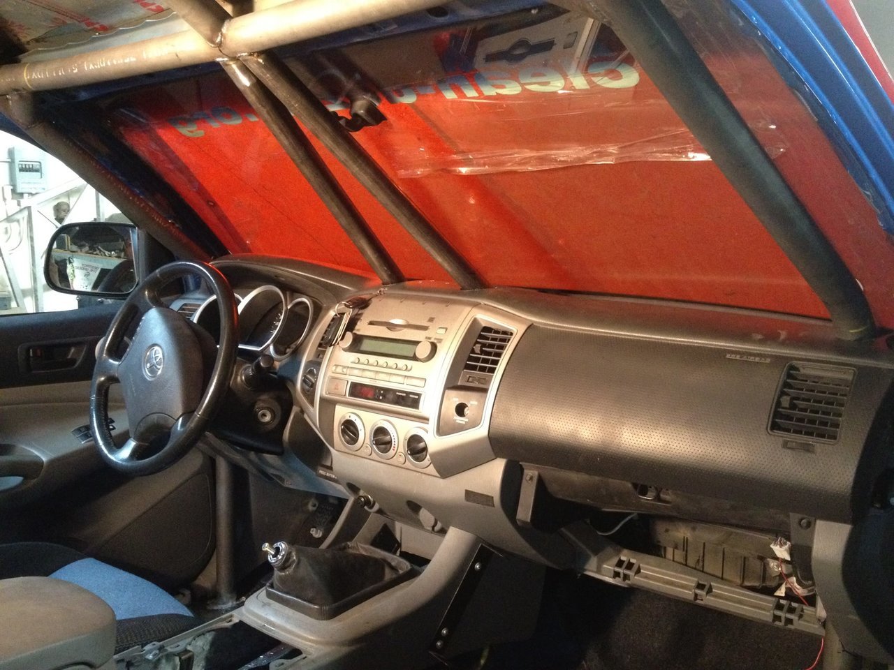

    a few progress pics I took over the past couple months. They reflect various stages of the build:

    damn those spindles are beefy.

    Damn. How was it to have 4WD once again?!
    Engine cage is super clean. Bumping off the UCA/Uniball is nice touch.
    10" or 12" Coilover/Bypasses up front now:cool:?

    Thanks, yea Im bumping off the spindle bolt, which has been upgraded to a Grade 9 and has a strike plate tig welded to the top, hitting a 2x4 King bump.
    I am running 2.5x12" Fox Coilovers and 3.0x12" King Race Series Triple Bypasses

    Nice, Looks like it work well. Damn, you got some big shocks there :cool:

    Damn! That is some very nice work right there. Strengthen the whole thing up nicely. Were you able to feel that there was less flex when you recently took it out?

    definitely, i took it on the powder puff race course and, although my valving is completely untouch and harsh as hell, the truck ate up everything and kept going. Not more shaking, twisting, rattling, or loose feeling in the controls, everything was dead on.
    I also put delrin bushing on all the pivots so there is no play when cornering at all, the whole thing feels like it's on rails.
