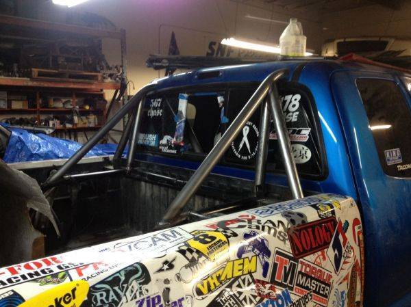

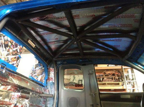

    looks good! any pics of how its tied into the frame and bedcage?

    thanks guys. Cage is tied to the frame via floor tubes that go along the floor by the doors, and then through the cab to the frame. It is tied to my bed cage through the top of the roof and bottom middle of the back of cab, going straight back. I will get some pics during the day, i havent put any interior lights back in yet haha

    to the top of the bed cage:
    You can see the two tubes in the pic right below the rear window extending out to the bottom/middle of the bedcage:

    Have you thought about putting ensolite over the sound matting to reduce wind noise and what not, might be futile at this point though :notsure:

    hmmm interesting, there is some wind noise, but not bad, i'll look into it. havent carpeted anything yet cuz door tubes and some more frame plating need to go on, plus some other stuff...

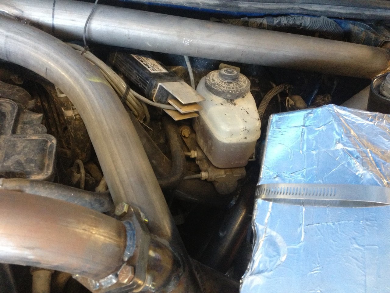

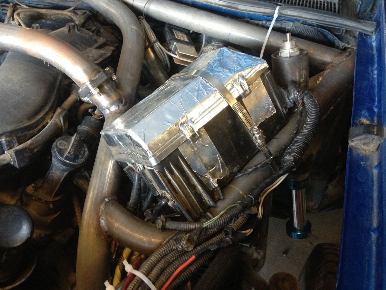

    more pics of engine cage please, looking to see where you mounted fuse box, ABS/brake booster, and all that stuff.

    Yeah, It works better for high frequency sounds and what not.

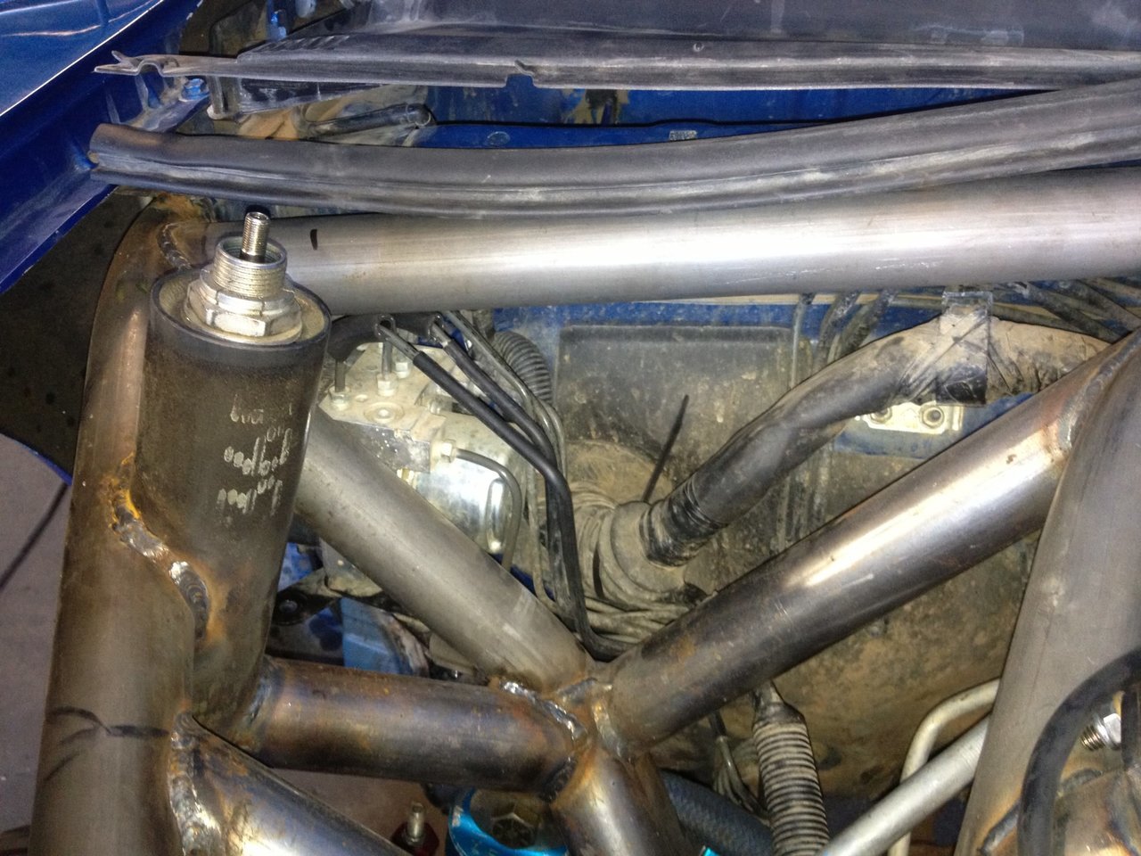

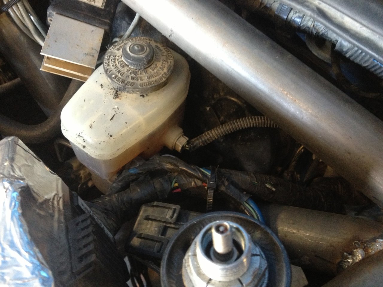

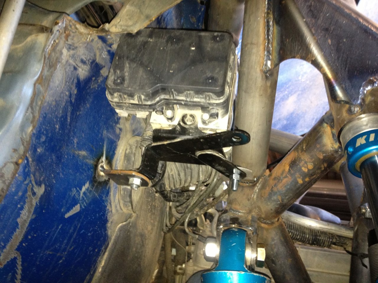

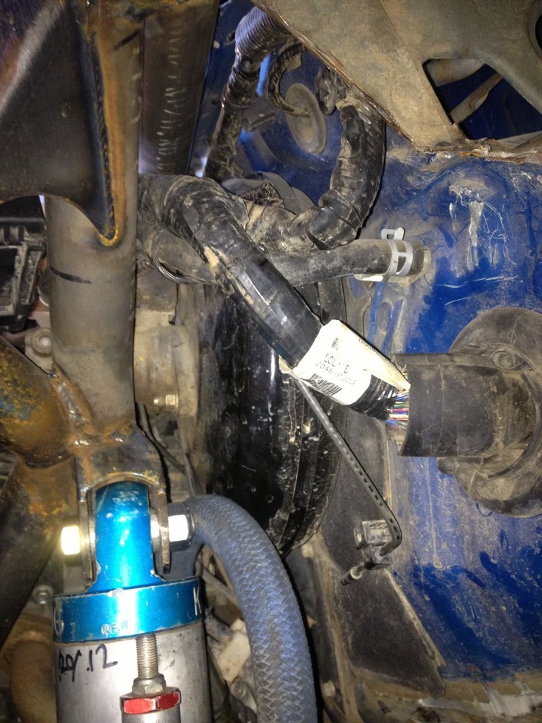

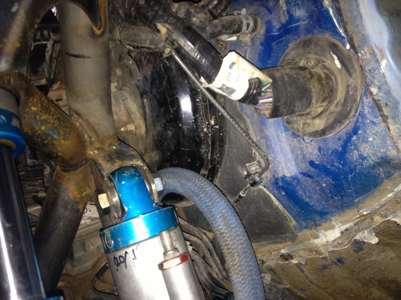

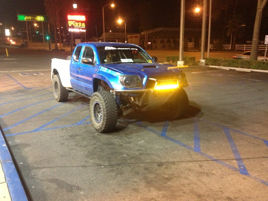

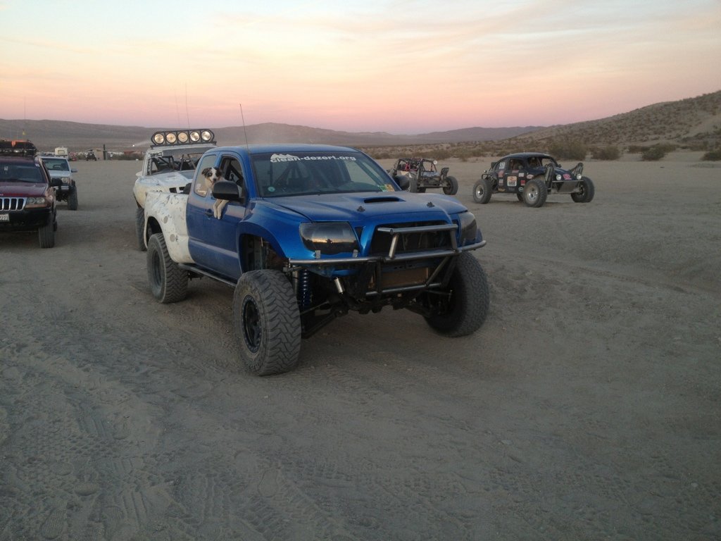

    Took some pics of where my Brake Master cylinder is stuffed, fuse box, and some other stuff, along with current light, skid, and ride height set up:

    Still got a little more work after Glamis this weekend, then im pulling off the fenders and hood and painting the cage. Right now it's gonna be WD-40 and scotch brite pad :(

    TRD Supercharger, TRD CAI, Camburg LT, Fox 2.5x8 coilovers, Fox 2.0 bumps, Deaver e30 leafs, Fox 3.0x18 triples, Avid sliders, Yaesu 2900R, Pro Comp 7089 16x8, DDM 55w HID Hella 500FF, DDM 35w HID headlights, Magnaflow 11255 muffler, PLX DM-100 OBDII, Autometer Ultra-Lite II Boost gauge, Flex Pod gauge mount, LSK tube bumper, McNeil fenders, Fiberwerx bedsides, 285/75/16 Toyo MT's
    niiice! skid made out of sheet metal? love the way it turned out with the perforated triangles

    Aluminum skids baby!
