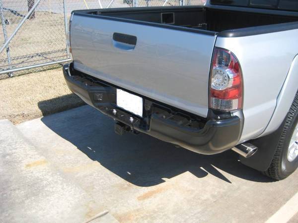

  15. Feb 10, 2011 at 7:02 AM
    Special_K
    Special_K o_o
    Jul 7, 2010
    #39920
    3,407
    Eddie
    Alexandria, VA
    2019 Tacoma Cav Blue
    I wrapped mine with flat black vinyl. Didn't want to mess with the paint. I've only had it on the bumper for a few months so we'll see how it holds up.

    what did it cost you to wrap it in the flat black vinyl?
  18. Feb 10, 2011 at 7:12 AM
    #18
    Special_K
    Special_K o_o
    Jul 7, 2010
    #39920
    3,407
    Eddie
    Alexandria, VA
    Thanks!
    I think it was about $60

  20. Feb 10, 2011 at 7:48 AM
    #20
    ilg
    ilg VanCity Taco.
    May 5, 2009
    #16835
    646
    BC, Canada
    09 MGM TRD O/R 4x4 6-Spd
    WeatherTechs, Yellow Fogs, Alpine X-100 iPod Stereo, Custom Seat Covers, Debadged, Locking Bed Compartments, Black Front Toyota Emblem, AVS Vent Visors, Colour Matched Grill, TRD Shift Knob, Eagle Alloy 187s in 16x8 wrapped in 265/75/R16 Goodyear Wrangler Duratracs, Black Chrome TRD Badge on Tailgate, Black Rear Bumper, 8 in shorty antenna, 5100s @ 2.5.
    I wrapped mine in vinyl too, has been on for about 6 or 7 months. No problems yet. Mine only cost me about 7 or 8 bucks though. 60 is pretty pricey :eek:
