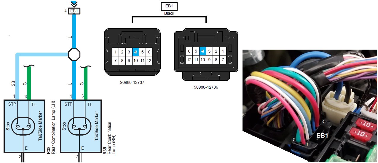

    Besides the TSS, there are other systems that are tied into the brake system pedal switch. Removing the systems fuse would give you a CEL. You'd need to "cut" supply to the lights, not the switch/system. The connector to the stop lamps is in the engine fuse box.
