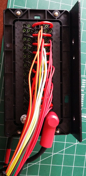

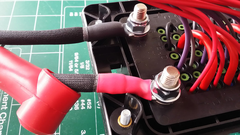

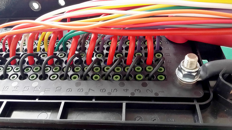

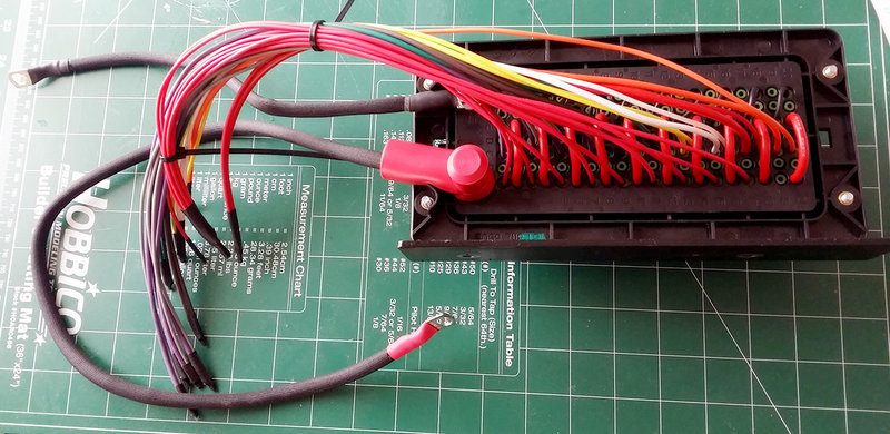

    Finished pre-wiring my Bussmann RFRM Relay/Fuse box today.
    The RFRM has dual bus bars and holds 10 fused relays plus 20 fused connections (10 on on each bus).
    I wired the busses to +12v and ground, each relay connection is fused from the bus so it's extremely safe with multiple fault tolerances.
    I'll probably add a smaller 5 relay bussmann box in the back of the truck at some point in the future, but this should handle all my power needs until then.

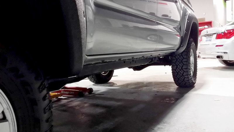

    A fun day at the shop ahead.
    Pulled the sliders off and painted the pinch weld black.

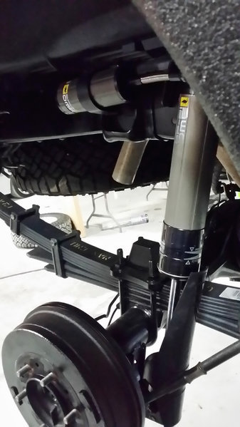

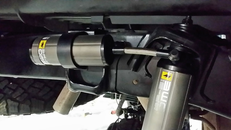

    2014 Tacoma TRD Off Road DCSB
    Exhaust tip deleted, and OME BP-51 kit installed. More on that to come.
    AllPro U-Bolt Flip Kit installed, painted black.

    Jeffery
    2015 TACOMA ACCESS CAB
    Sweet looking shock!
