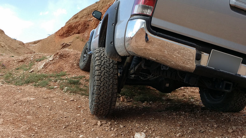

    I would have to agree, more down travel would be a huge plus. The BP-51 dampening is great but they are not extended travel. I have noticed it a lot with the rear shocks, this is about the max drop I can get out of them:

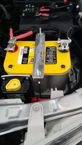

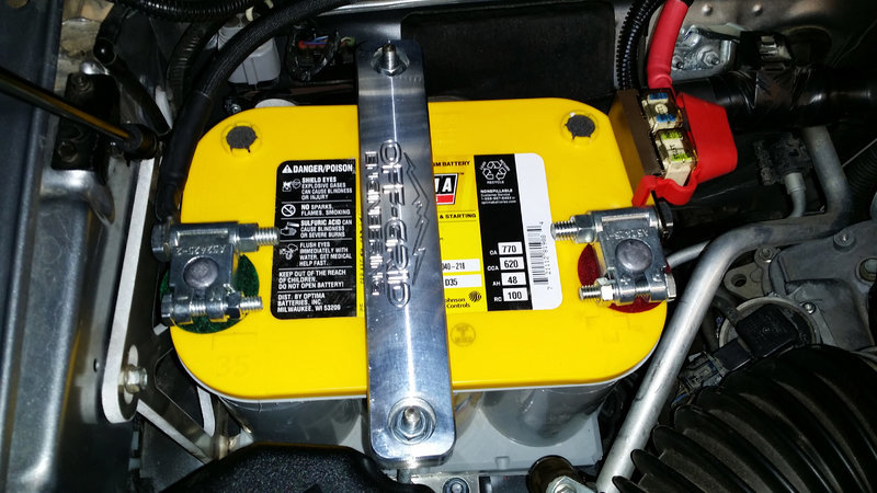

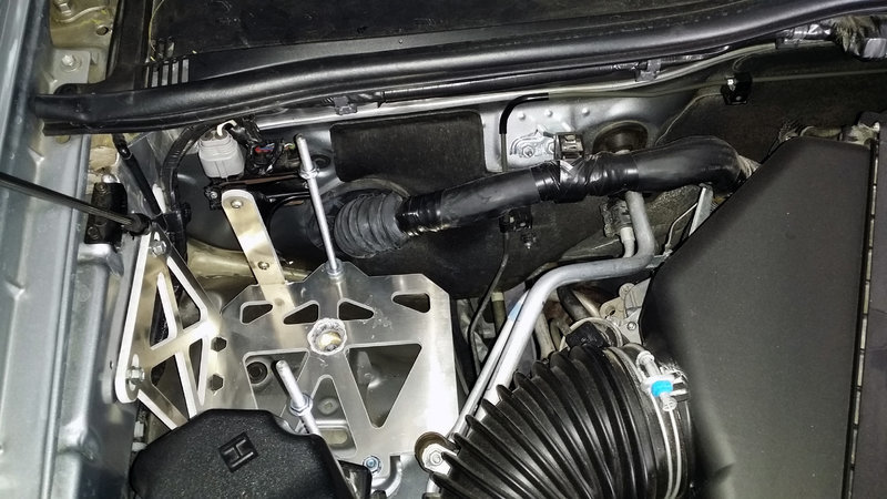

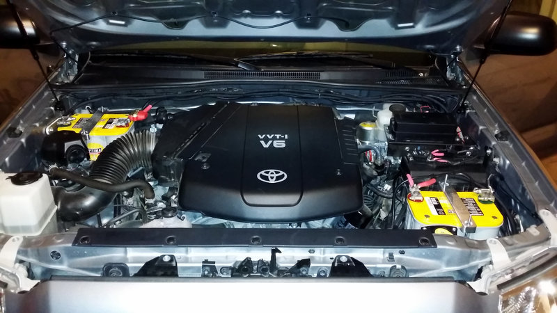

    Got my dual battery system in. I saw the slim aluminum tiedowns that @HeliMedic at OGE is now offering and had to grab a set of his trays. Quality is top notch. Install was easy, aux tray bolted right in:
    Driver side ACR Mount just sits sandwiched between the battery and the fender platform, no bolts required:
    I already had a Blue Sea ML-ACR lying around and I prefer to make my own cables, so I got some 2 gauge EWCS Welding cable, high temp sleeving, tinned lugs, 1/2" Ancor Marine Grade Heat Shrink, and some battery fuses to complete the install.
    Aux fuse/relay box is connected to the second battery so lights and accessories can run without worry of draining the starting battery.

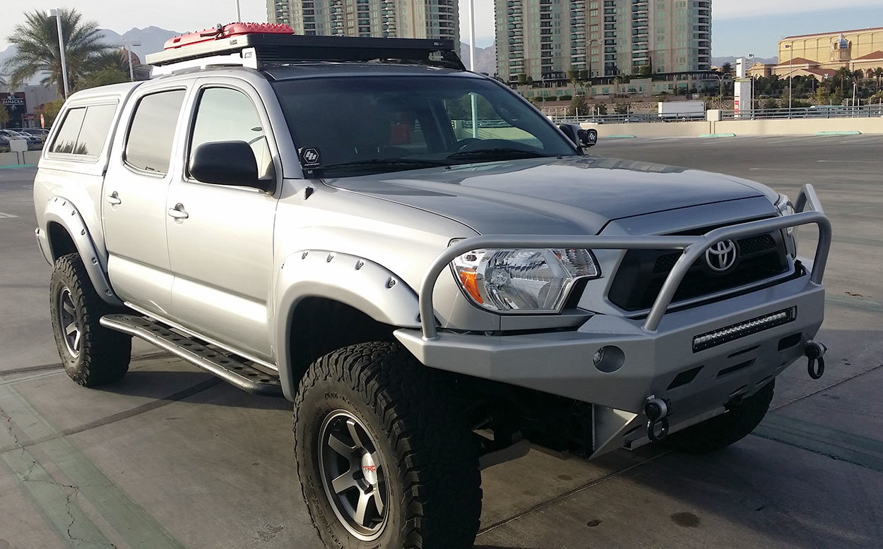

    Long overdue shot of new silver painted Bushwhackers:

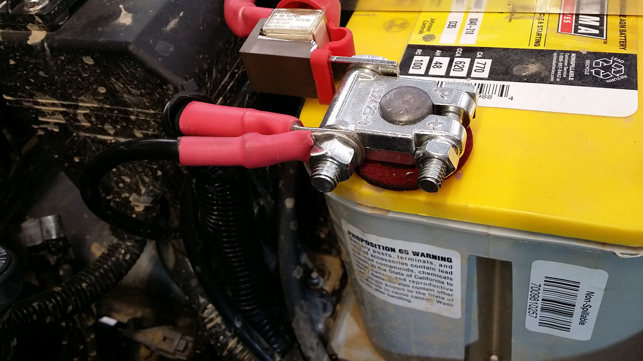

    Also finally got round to extending the factory starter battery cable so I I could switch to a military style terminal on the main battery +12v side.
    Used a tinned copper 2awg non-insulated butt connector, crimped on and covered with marine grade adhesive lined heat shrink and new high temp black loom. Was a little tricky to get the huge crimper in there to crimp this without removing the starter cable. I removed the battery instead and managed to get it done.

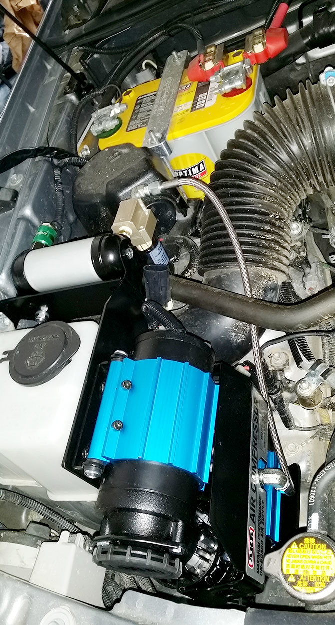

    Currently installing ARB Twin compressor on Slee mount. This is a nice mount and fairly straightforward install, but the stainless air line they provide with the kit is too short for the moisture separator I added to the air locker manifold. It does reach, but barely. Even without the moisture separator it's too tight for my liking. I'll be on the hunt for a new longer leader line to replace it, maybe with a larger inside diameter as well.
    Also going to look for a dust cap for the air chuck, until I end up adding an air tank later.
    I know, my engine bay is dirty. Been hitting some fun trails recently and can't seem to keep it clean.
